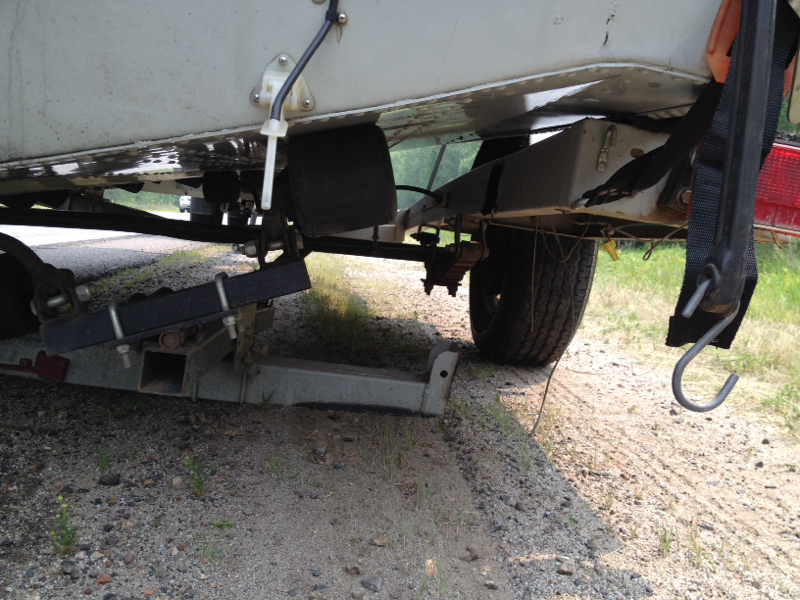

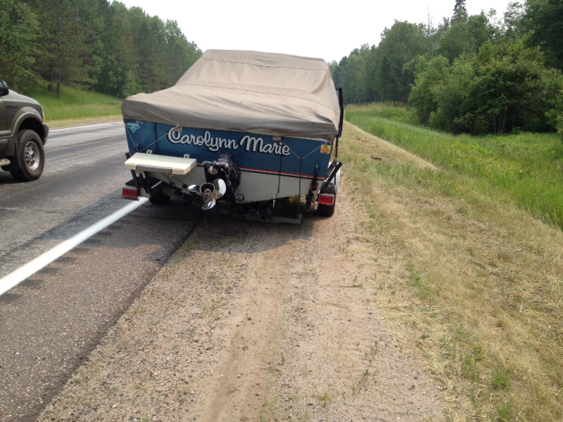

Spotted this today and stopped to see if I could help. Rear crossmember ripped away from the frame and was dragging on the road under the weight of the boat. Front crossmember was ripped but had not yet separated. No visible rust on the trailer. Appeared to be caused by metal fatigue. Recovery service came and jacked up the crossmember and temporarily secured it using 2 inch ratchet straps. Limped the load 3 miles to a lake where the boat was offloaded so that the trailer could be brought into town to be welded up.

Did the welds come off the frame, or did a square of the frame come off with the bracket?

Did the welds come off the frame, or did a square of the frame come off with the bracket? Aaron Z
the square of the frame came off with the bracket. Welds were good.

Perhaps a little too hot and caused undercut which weakened the base metal? Aaron Z

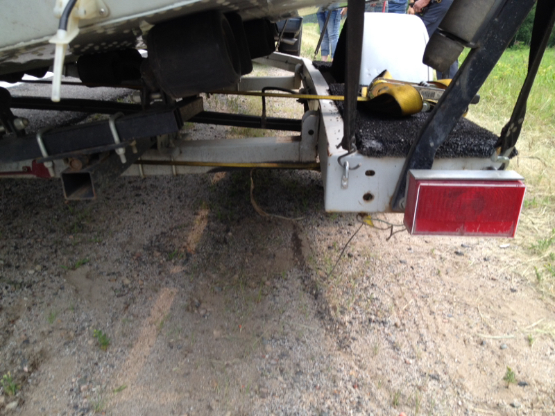

trailer was 28+ years old. Here is a pic once the strap was installed.
