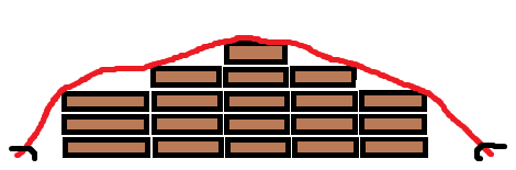

This is why I stack my board in a semi-pyramid shape - it gives your strap some "purchase" on all columns of boards.
Here is my 1 minute sketch from paint.
Would wrapping the strap all the way around the pile be better?
I do both! Bind the pile together with one strap, and then clamp it down to bed anchors with another.
