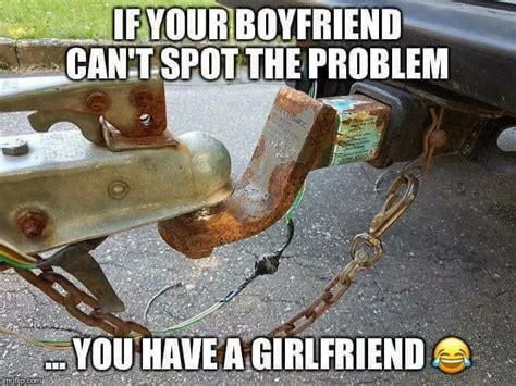

But how many can you count? I got see 5 problems...
I cannot come up with 5, but I can get to 3. Maybe 4
Picture is certainly not the way I hitch up.
   / Share Pics of People Hauling or Towing Something Wrong #14,414
He had to hook it that way, the chain was too short to reach the reciever. :confused:
   / Share Pics of People Hauling or Towing Something Wrong #14,416
Single chain instead of two.
Dog chain clip instead of a tow hook.
The obvious attaching to the pin clip instead of the toe hooks of the hitch.
No latch clip (or bolt) for the latch on the ball.
The last one is a stretch, but the wiring harness looks like a cherry bomb wired to go off when you hit the brakes. 🎆💥🤣
