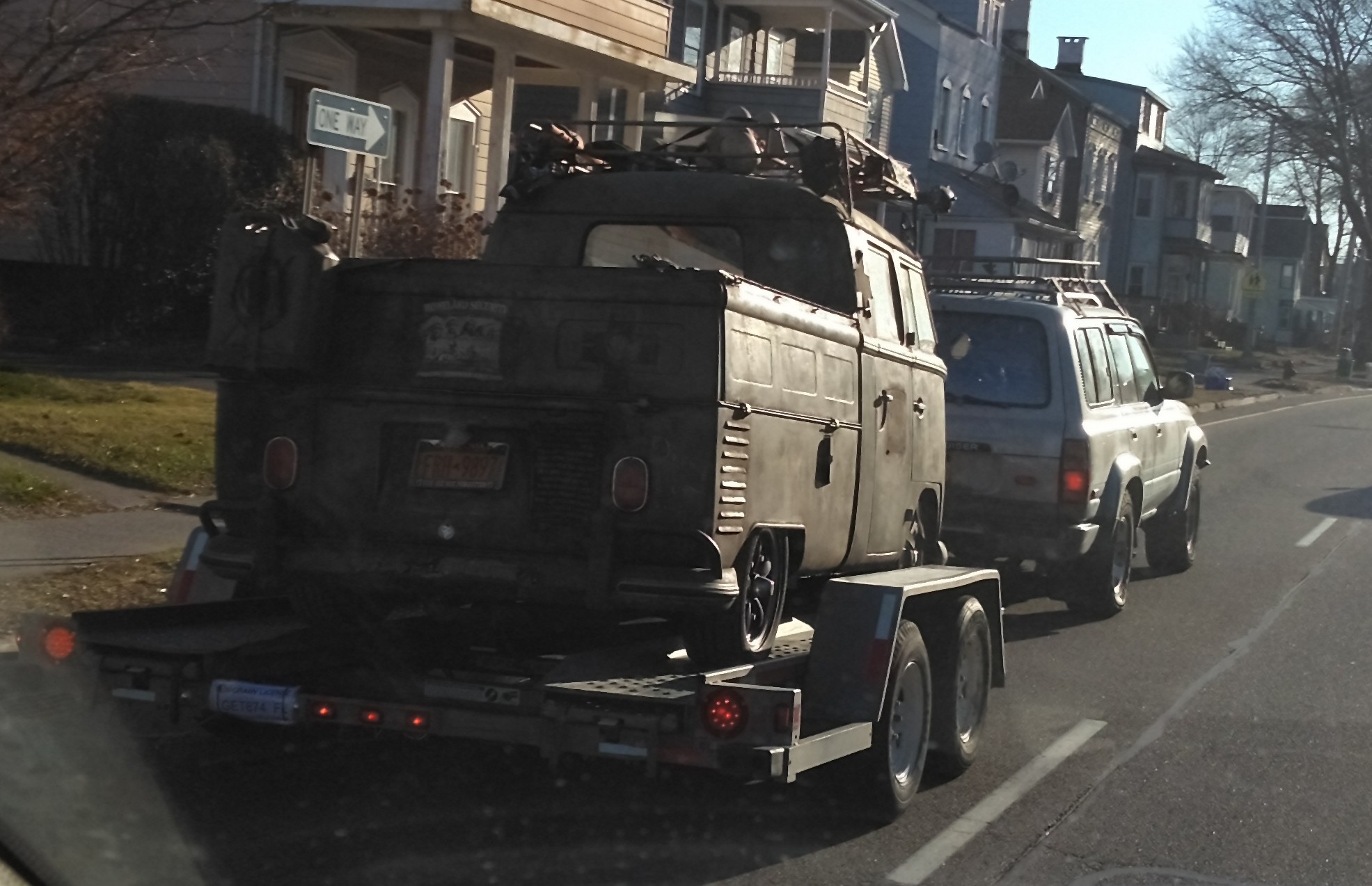

I saw this one a couple days ago, not sure how much that 1/2 van, weighs, but I would think it's a no brainier that it's nose heavy. I also think that just because your vehicle specs say it can tow "X" weight, if your tongue weight is far exceeded, than maybe you should consider that total is decreased a bit. Obviously no one on here would ever do something like this...:thumbsup:
You cant see it very clearly, but the tongue is close to dragging.

Around 3000lbs, and the engine/transaxle is in the rear.

Generally specs say that a "properly equipped" vehicle can tow X amount of trailer, but most people overlook that part.

Double Cab Pickup '60 - '63 - 2480 lbs. Those things were extremely short wheelbase and way tail heavy. The back end would come around and get in front of you if you hit a bump in a corner.
If that's a Uhaul trailer then I expect the trailer weighs as much as the VW.
The 4Runner's rear tires aren't squished. I think its just a poor hitch height, nothing more.

The tow vehicle appears to be sitting pretty level. It’s possibly been lowered. I think a poor hitch height is causing most of the problem.

That's what I was thinking as well.

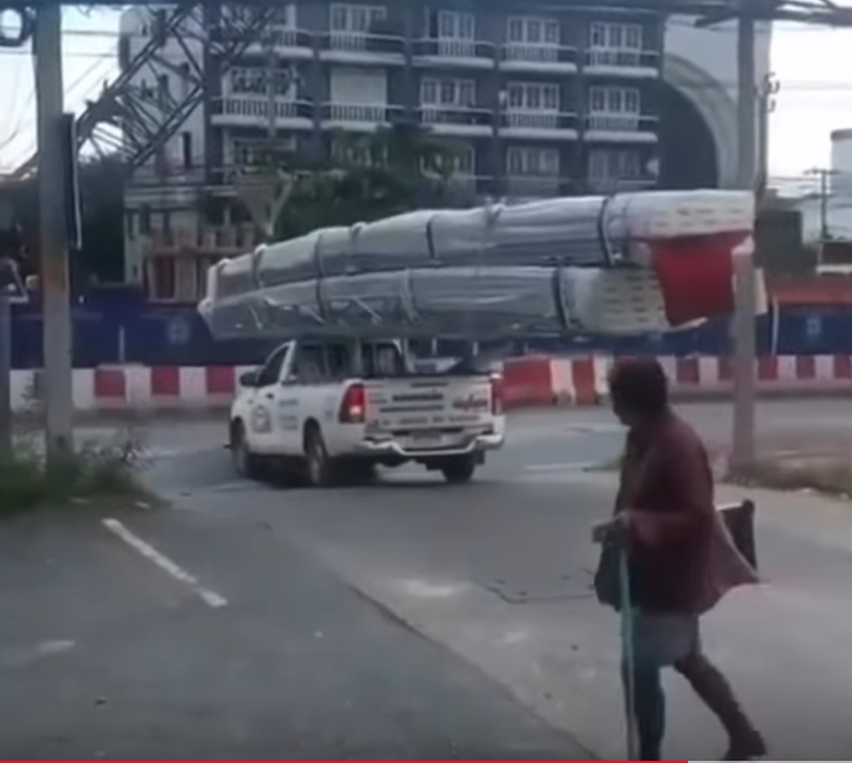

Saw this on youtube:
