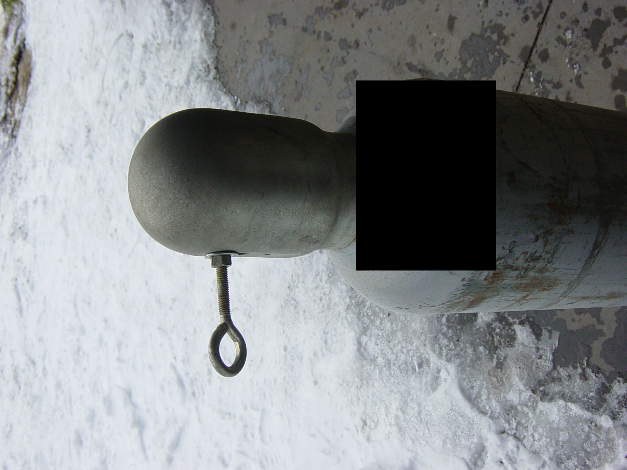

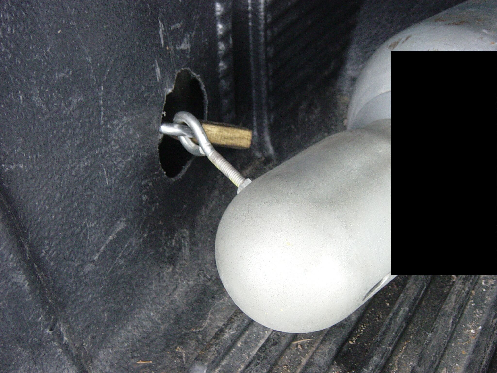

I picked this cylinder of MIG GAS up from a friend and had it rolling around in the empty bed of my truck for a hundred miles, despite attempts to tie it down or hook the cap.
Got it filled, and didn't want it rolling around on the return trip. Came up with this quick fix. Also allows you to grab it just a bit easier.
Yay or Nay?
   / Share Pics of People Hauling or Towing Something Wrong #11,889
Yay or Nay?
Better than rolling around, ya. Much if any value in the event of even a minor issue, no. A decapitated high pressure tank will easily bust through a properly constructed cinderblock wall & several pieces of plywood (Mythbusters). I know it would easily decapitate a person after going through windows either from momentum or gas propelled. Really my welding cylinders are the most frightening thing I haul even with inert gas. There is no way I'd haul them without making sure they can't roll or slide. Ratchet straps can hold round stuff if you get em tight & properly rigged.
   / Share Pics of People Hauling or Towing Something Wrong #11,890
I agree, I would run a strap around the tank a couple times (one strap on top and one on the bottom), then hook it back on itself and strap the tank to the side of the bed so that it can't move, or at a 45 degree angle from one front corner to the opposite rear corner.
