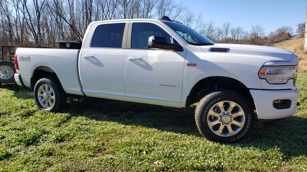

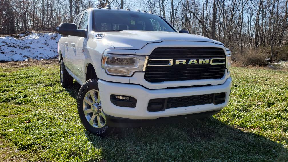

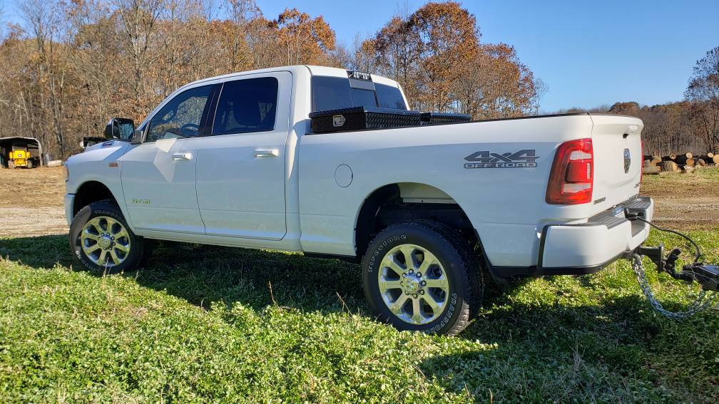

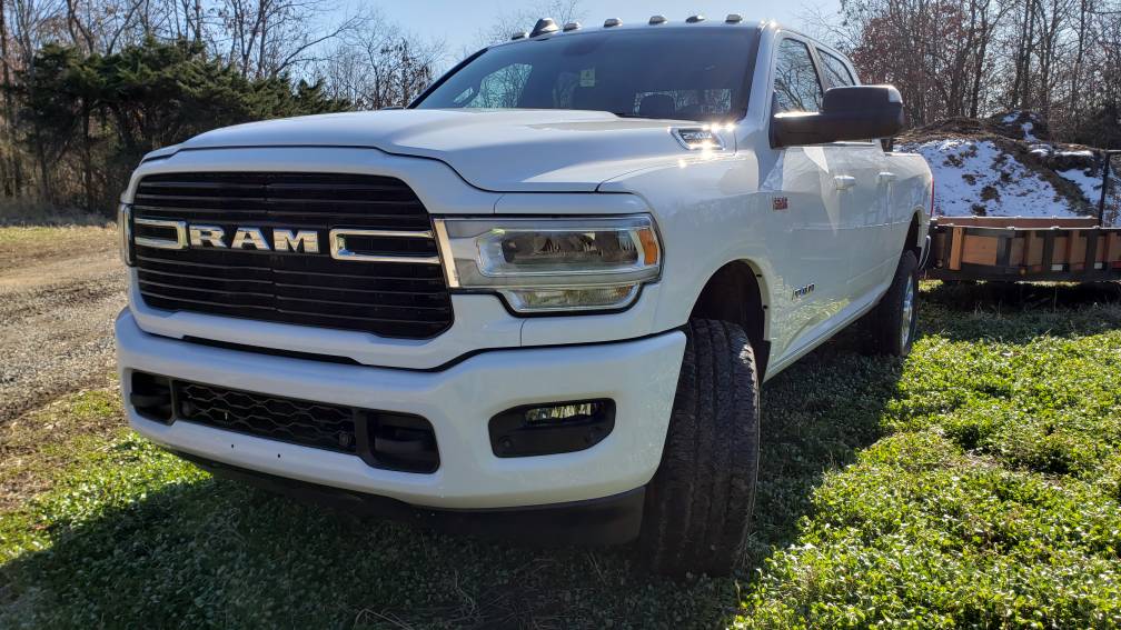

Off topic... But looking under my new RAM 2500 6.4L gasser today I saw something freakish....? A third shock absorber mounted horizontally to the top of the differential casting and reaching forward to a bracket. Like a shock for axle wrap... But I have a 5 link rear suspension with coils, not leaf springs. Leaf springs can see axle wrap and pinion kick under load. A linked suspension can't.
So tell me what in the world is this thing doing under my truck other than looking pretty?
View attachment 628992View attachment 628993View attachment 628994View attachment 628995View attachment 628996View attachment 628997View attachment 628998View attachment 628999View attachment 629000
That's a Power Hop Damper. I think having rubber bushings in the links gives some flex and bounce causing hopping.

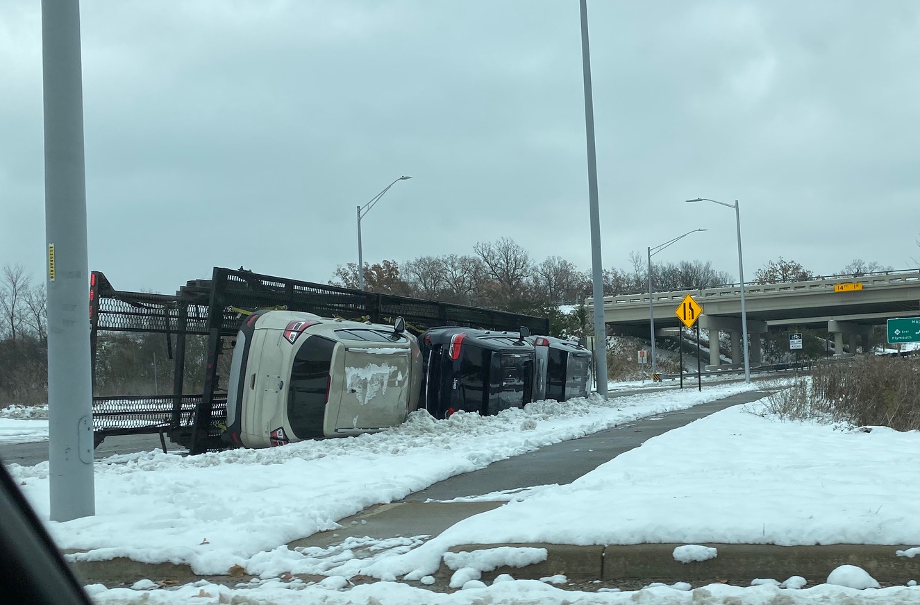

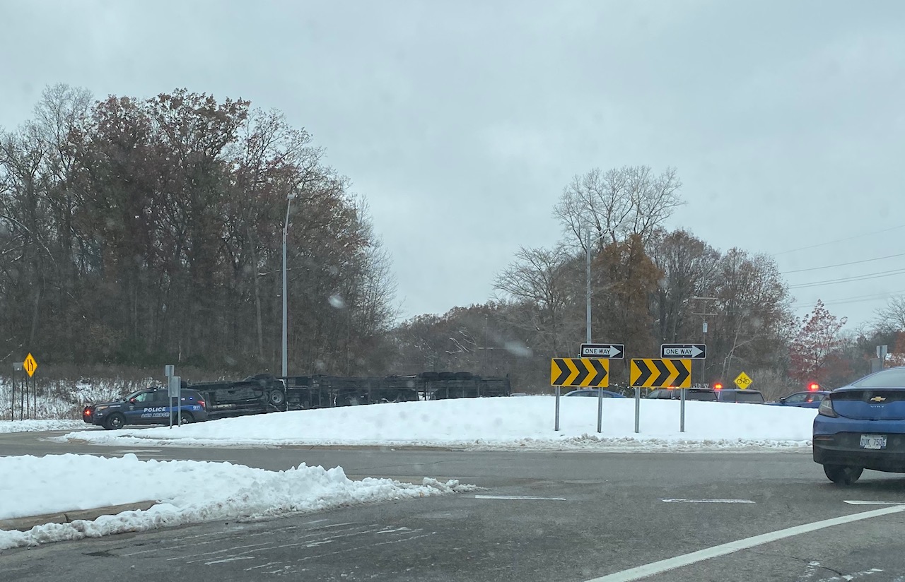

North side of Ann Arbor, Michigan last Friday. Came off M-14 freeway to see a lot of police activity. Dunno if this guy swerved too hard in the roundabout, or if the raised center section (possibly with a bunch of extra snow piled on it) was enough to tip this setup over.
I've always thought these 3-place hotshot car hauler trailers really do place the load (and C.O.G.) way up high. I suppose the risk is.... this. not a good day for the pickup driver. They were using a large crane to right the whole shebang a couple hours later.
