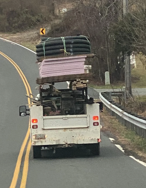

While I agree, there is an education element that plays into this also. I have been guilty of not properly securing a load in the past because i didn't know any better. I get it now. If someone at the big box store had said "even though you may think this is OK, you really need a strap over the top" then the full lift of 2" XPS foam (4x8 sheets 4' tall) would not have sailed out of my PU truck box years back on a windy day... Turns out the shrink wrap was damaged or not quite tight at the top and it pulled the top sheet partially free from the airflow/wind and then that picked up the whole thing and sent it airborne. Fortunately nobody or nothing harmed. Lesson learned but didn't think it was possible until then... I also saw a drop in bed liner fly out on a windy day on the freeway (not mine). Those are the things people don't think can happen until they do...
