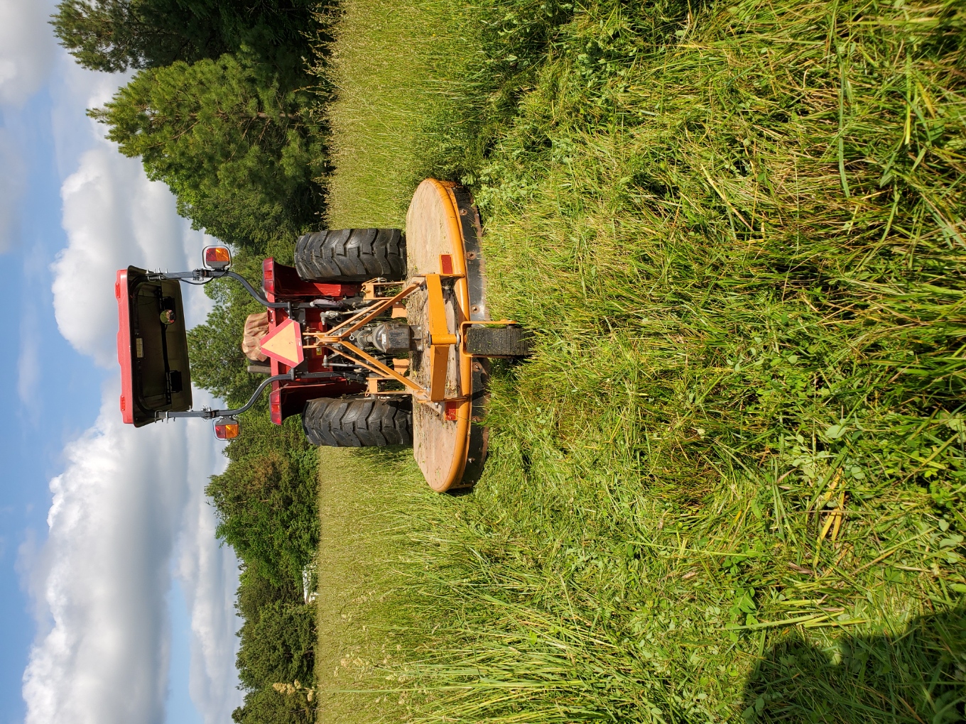

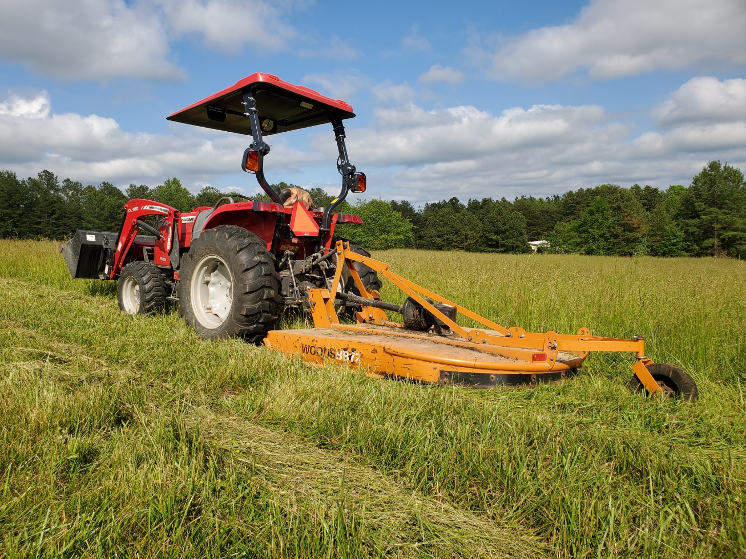

With my 1635, I usually use the bottom hole for the top link. I raise the mower to my desired cutting height and then lengthen or shorten the top link until the mower is level. My mower gives me the best cut when I adjust it this way. 20200525_165322.jpg

LRover I respectfully disagree. Everyone helps everyone else when they provide an accurate report from their experience -- and I'm sure you did exactly that. However: 1) When you raise the mower to desired cutting height and then adjust the top link to level the deck that statement inherently means you have taken all the slack out of the top linkage. That means there is zero ability to "droop" the deck allowing it to fold down over humps that you go over (specifically over the pond bank this owner is mentioning planning to back down over.) 2) Nearly all the recommendations I've seen including those from the Bush Hog manuals say to raise the rear of the mower somewhat above the front edge in your final mowing configuration, held there by the back wheel of course, not the top link, and NOT level with the front. And 3) Using the bottom hole is fine, I just don't think it matters.
And I am puzzled by your photo because it seems to show you are not cutting much off the grass you are going over. Is that intended? Seems strange the grass is still that high where you have mowed.

I do have a little slack in the top link though it may not be very obvious. You can see in the photo that the mower's top hitch is not completely straight indicating some top link slack. The design of the mower's top hitch does allow for float similar to a chain. I have it set with the gauge wheel contacting the ground and I should have mentioned that I adjusted that in my first reply. No need for much "drooping" in this field of mine as this is a fairly level pasture but I do understand the OP's need to be able to mow around his pond. The intent of my post was to show an initial mower adjustment in a level field with a tractor similar to his. My 6' Woods brand mower works best for me level. My 5' King Kutter brand mower is a rear discharge and having the mower adjusted with the back raised slightly higher that the front does help with the discharge pattern of cut grass when it's heavy.
In the photo the mower was set to leave about 8-10 inches of grass as I graze this pasture and I turned stock in it after it was mowed. The grass was waist high in spots this spring and that was one reason I bothered to get off the tractor to take the picture. Here is another photo that might show better how tall the grass was.20200525_170428.jpg
