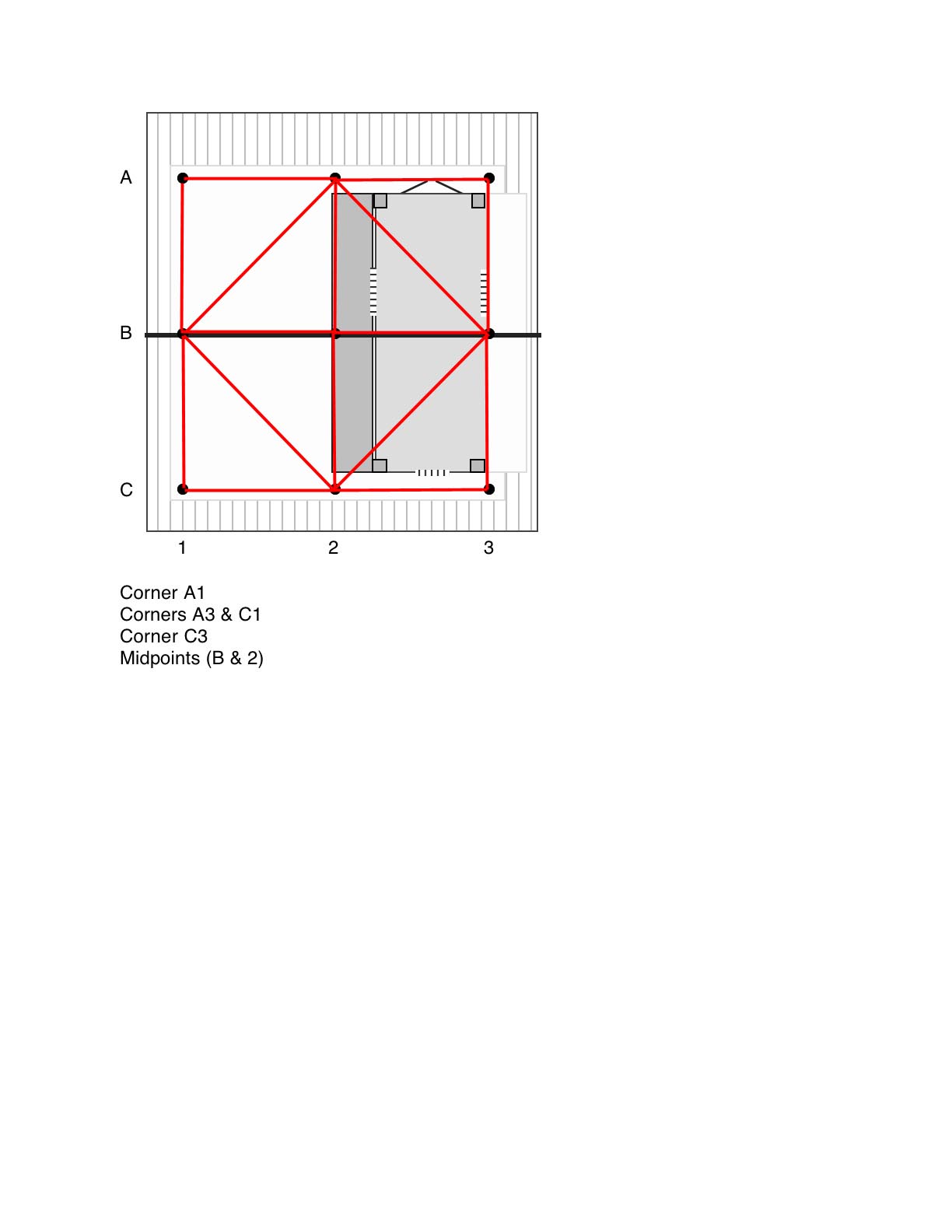

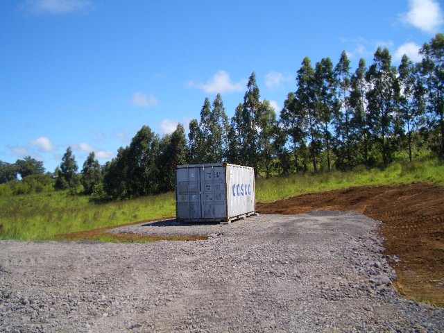

I'm about to start building my tractor/utility shed. Basically, this is an overbuilt carport, with a 20 ft container under one side, the other side is an open bay. The roof will become home to my solar (PV) panels, and possibly a solar HW system - rational for over built.
Anyway, here's what I need suggestions to accomplish:
The structure is supported by 9 pipes, 4 in galvanized, 15 ft total length, 5 feet in ground (12 in hole filled with concrete).
Any suggestions how I can get and keep them lined up properly while the concrete sets? I'm not so concerned about height, as I think I can manage to keep them quite close and the threaded coupler will allow for small corrections when setting the beams.
These pipes will be exactly 11 ft apart, so 3 in 22 ft span. 9 in a square. The container is in place but nothing else.
Not only must I keep them aligned, but plumb as well.
Setting wooden posts on a concrete pier would have been so much easier, but alas, I am going with the permitted plans.
The attached drawing depicts locations and my current thoughts on order of installation. I think I will have to install corners, then midpoints.
All suggestions appreciated.
