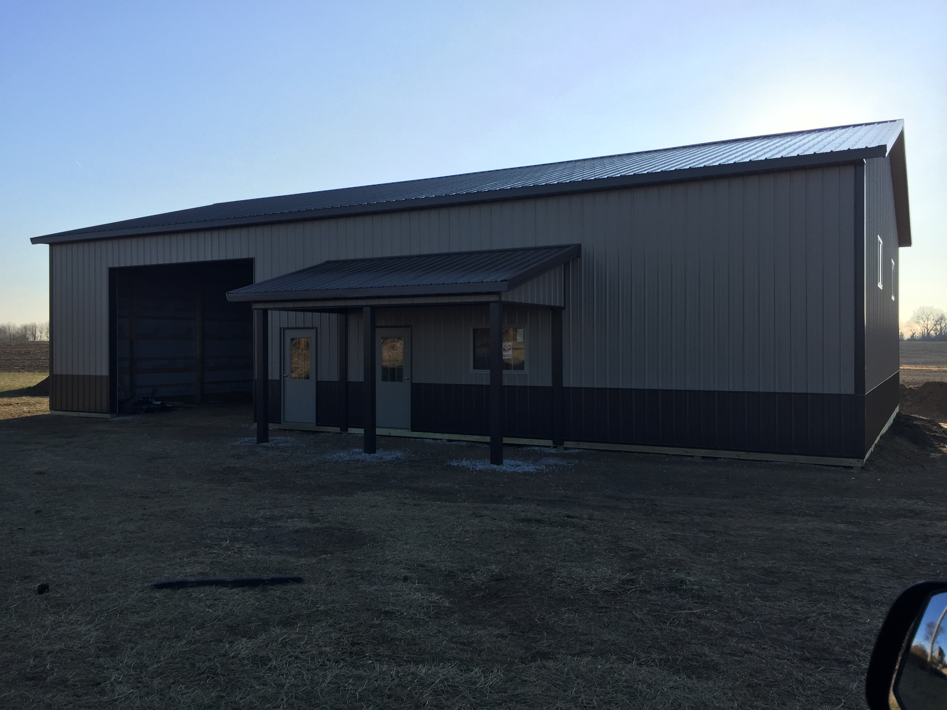

This is how my post were set. 6" cookie in the bottom of a four foot deep 18" dia. hole. Plumbed and filled with C-7 to the top. Ready to build immediately! This 40' x 64' with a 14' ceiling took 6 1/2 days! with a 5 man crew. Just the shell no concrete or inside finishing- yet.
