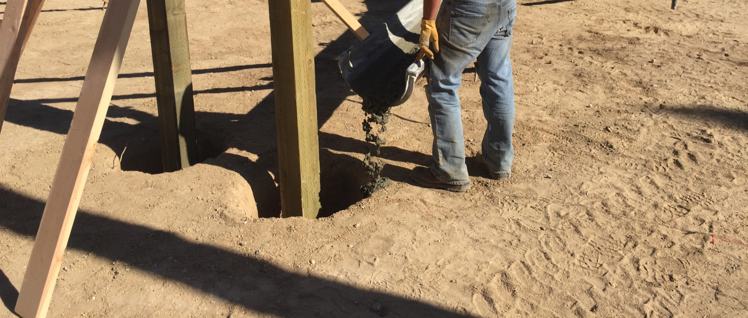

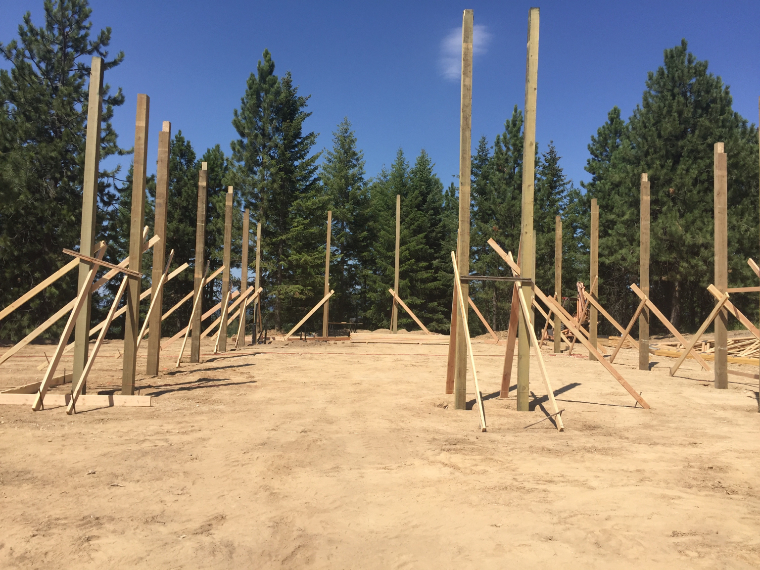

Here’s how we braced mine. We poured directly from the chute of a cement delivery truck-well 3 of them to be correct. Image1524658597.650527.jpgImage1524658774.168289.jpg
