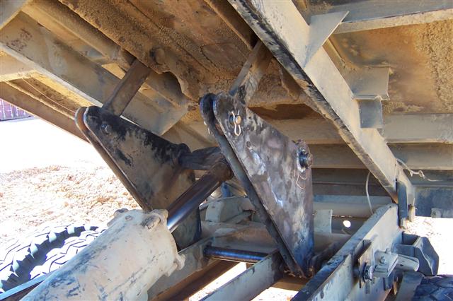

Hey Alan,
Here's a picture of mine. Is it similar?
I have the PTO pump that powers the cylinder that lifts the bed. It is a single action cylinder that when engaged, lifts the bed. Then when the pressure is released, the bed comes down by gravity.
The cylinder area above the piston is your storage area for fluid. There is no need for it to be full, and if you make the same mistake that I did and fill it up, the bed won't come all the way down. Basically, when the cylinder is pushing the bed up, the fluid comes from the other end of the piston, through the hose, into the pump and then pushes the piston up. When released, the fluid flows the opposite direction.
I add to mine with the bed up and blocked with 2x6's to keep it up. Then the screws comes off with a philips head screwdriver. I use a plastic, disposable cup, and pour in one cup full at a time. When I get it right, the bed will raise all the way. I then add two more cups and call it a day.
Do you have the same triangle shaped brackets? Be sure to grease them real good. I've broke the ends off of mine twice. The first time, I had a local guy weld it back together and it was a simple job. The second time, it twisted the heck out of the metal and I had to take it to a machine shop to weld it up and align it. That was $500 and two days of pain to get it apart and back together. MISERABLE PAIN!!!!

Thanks guys,
Yes, it is very much like your's Eddie, but I have never seen it up so I am not positive on the triangles but I must have something similar.

I like the plate idea, but once you get fluid in there, that's a done deal. You'll find the leaks quickly enough since there is only one hose. But over the long term, you will have to grease those pins. mine has four pins per side, plus the main pivot rod that holds all the weight of the dump bed. You will have to figure out a way to get under the lifted bed and grease those fittings.
I tried to lift my bed with my loader, but didn't have much luck. I didn't have the forks for it then, so you might be able to do it with the forklift where I wasn't able to with just a bucket. When I broke mine, I lifted it with a bottle jack and allot of blocks of wood. Back and forth, with bracing in three places on both sides. It's slow, tedious and painful, but it works.
I found that the rings on my piston were very much like a piston on a car. They were also all lined up so that fluid could flow right through the ends of the rings. I kept the same rings in there, bu turned them so that the ends were staggered. Now my bed stays up when I'm not using it. It will bleed down over night, but it's way too slow to see. Before, you could see it coming down and had to keep pumping fluid into it to keep it up with a load.
