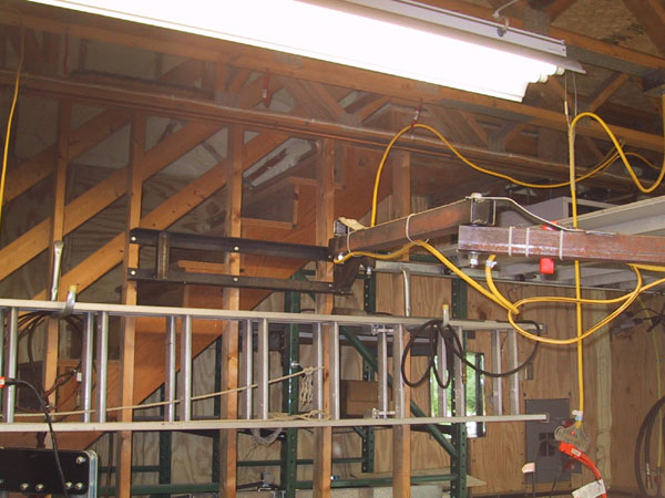

Here is my solution for lighting. There are 2- 500 watt halogens on 3 hinged arms that stick out 9 feet from the sidewall. I have 9 foot ceiling and I also hang a power cord from it. It was one of my first welding projects with my Lincoln 200 Power Mig (230V) weldor

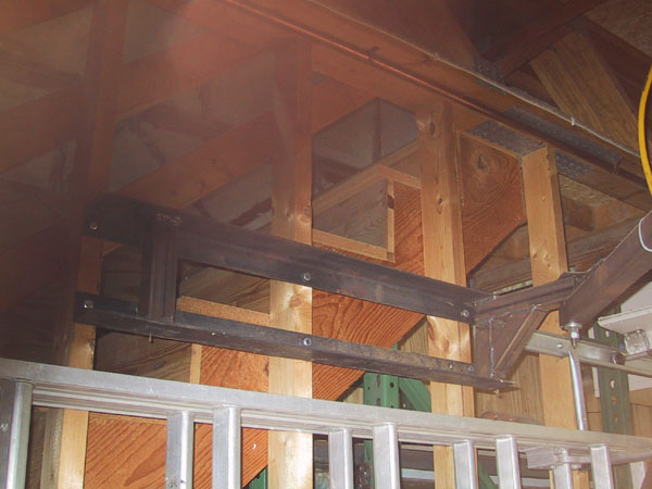

Base

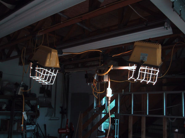

Lights glowing. I bought the two 500 watt bulb that mounted on a tripod for ~$22 on sale at WalMart and discarded the tripod. Each light is aimable. It ended-up about 7' high with the inevitable sagging.

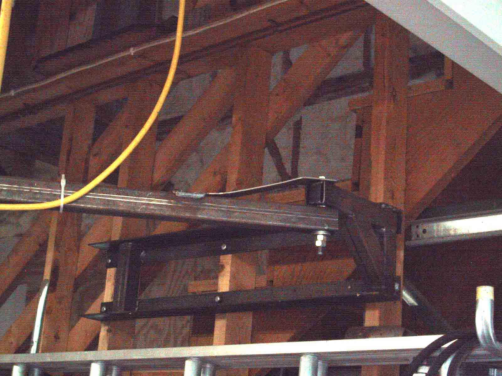

Welded-up base bolted to three studs. Pic includes my left thumb /forums/images/graemlins/blush.gif

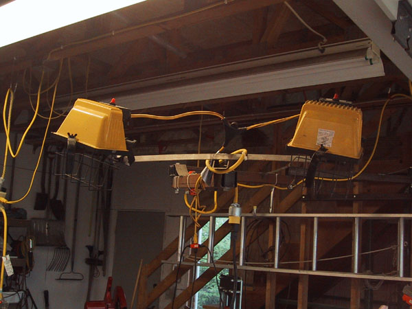

First pivot off the wall bracket. There are 3 three foot swinging arms and it will fold out of the way along the wall
