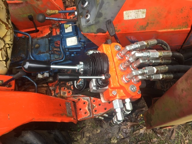

So I am somewhat lost on your ultimate question so forgive me. The valve I went with is made by Walvoil. It is a series/parallel valve. This will allow for multiple functions at the same time if you have enough flow. Sourcing a Monoblock 3 spool valve with everything you want can be a real pain.
The Walvoil I used is a SD5 series if I remember correctly. Here is a picture of mine installed.
