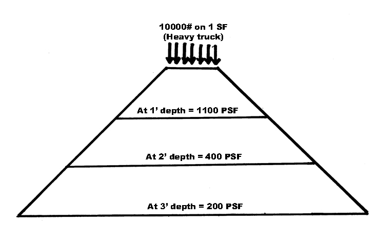

I wouldn't worry too much about the weight of a concrete slab over the tank. Concrete weighs about 150# per CF, average soil about 100#. Just think about what you weigh standing on a "footprint" of about 1 SF. Engineering wise, load is spread at about a 45 degree angle from the point source. That is a 10,000# dynamic spot load on 1 SF will be reduced to about 1,100# per SF at 1' depth, at a 2' depth, 400# at 2' etc. (see dwg.)
Three foot of dirt cover will span just about anything. We put down 8" aluminum temporary water lines on the ground, cover with 3' of dirt and run fully loaded 657 scrapers over them, 50 tons.
Never crushed one yet.
Interesting, I really wanted to know if there was a formula to determine how the weight would be spread as you got deeper. probably many variables due to soil types? I was thinking if you dug a hole 3 feet down and buried an egg or a soda bottle, you probably could drive over it without it breaking.

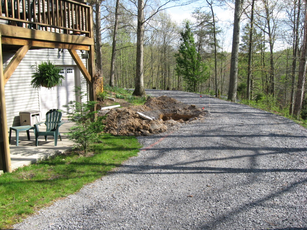

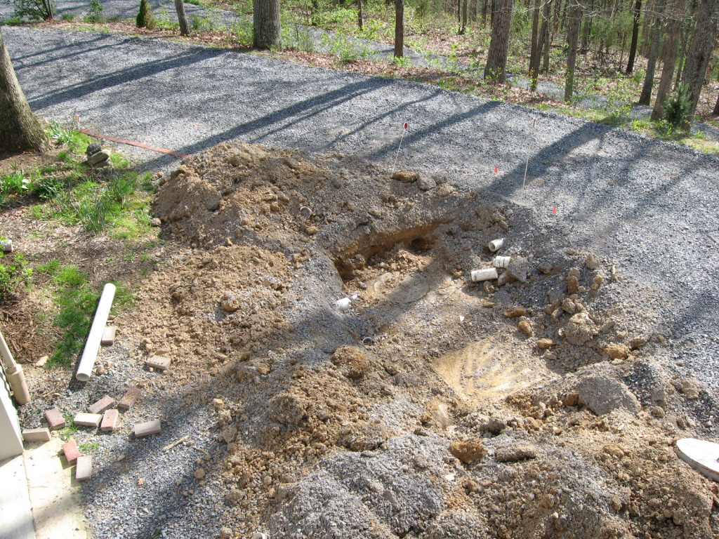

Well, after even more careful consideration, I and others determined it would be a dumb move to put in a new tank. The system works fine and I don't really have room to easily put in another tank.
I attached a picture of the tank exposed. On the left is the garage door. The guy that put that tank in that spot is a moron.

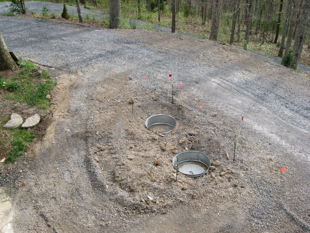

First picture shows the riser rings I put in. They are those bands that connect galvanized pipe. 12" high. The shop cut off the bolt flanges and then tacked them into 30" round circles for me. 20 bucks each.
Second picture is concrete forms in today. We built those plywood forms to place the sewer covers on top of. There will be 4" concrete on top of the two plywood boxes with the sewer covers.
