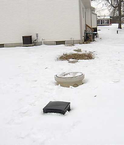

I checked and both the pump that lifts the water up to the leach fields and the pump for the curtain drain outlet are both working.
Here's a picture of the two tanks coming out of the house, the crock where the water is pumped up from, and the junction box that either diverts water to the front or back field.

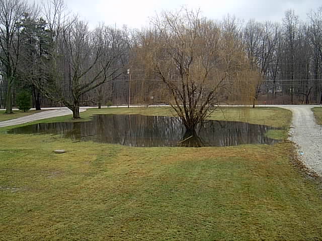

</font><font color="blue" class="small">( Sounds like you have a high water table with the curtain drain. Could be the water table is higher than normal and the pump can't keep up with it so the field is flooded and backing up. )</font>
I've mentioned in the past about my water problems in the front yard. The flooding is beyond my leech field, but the ground could be so saturated that it has worked its way over to the leach field?
Here's a picture I posted in another thread of my flooding problems. The sump crock in the corner is for the curtain drain, and it is as far toward the front of the property that my septic system extends.

18" sounds about right. No snow means the system is working. The snow is being melted by the hot water you are flowing into the tanks, and by the bacterial action inside the tanks generating a small amount of heat. I'm not sure I understand the elbow thing. Is there one elbow that you are supposed to disconnect and reconnect, in order to switch the fields? Or are both fields connected and one has an inlet that is higher than the other?
Yes, if the field is flooded from standing water, you won't be able to put anything down it until the standing water has gone away. It's like a coffee cup. Once it's full, you can't put anymore into it. If the ground over the field is flooded, the field will be flooded too. If that's the case, my guess would be that you may be seeing some grey water seeping from the curtain drain. (maybe. /forums/images/graemlins/confused.gif)

I don't know, 18" still seems kind of high to me for Ohio. What kind of winter have you had so far. Up here its been brutally cold (for me anyway) for extended stretches and people have been having freezing pipes that were 48" below ground. The ground frost is deeper than I have seen in a long time.
Be that as it may, looking at your photo points me in one direction - saturated drainage field due to high ground water. The level only has to get to 18" to stop your field from working which means you would not see any water ponding. Add the frozen ground and you would not get any indication on the surface either. My guess is the dainage pump can't keep up. That willow tree in the background tells me this is how it always is because those things love high water table ground. This is probably why the inspector made them raise the system up.
If it was my place I would get on the phone to the installer and the person who designed the system and if I didn't get any satisfaction I would hire a civil engineer who specializes in septic system design to review things. My gut feeling is this is not going to be an easy fix solution.
The only saving grace in this is that you have an alternate field to use so you are not shut down completely. Might want to consider asking the designer about throwing that switch and using the rear field exclusivly for now.
