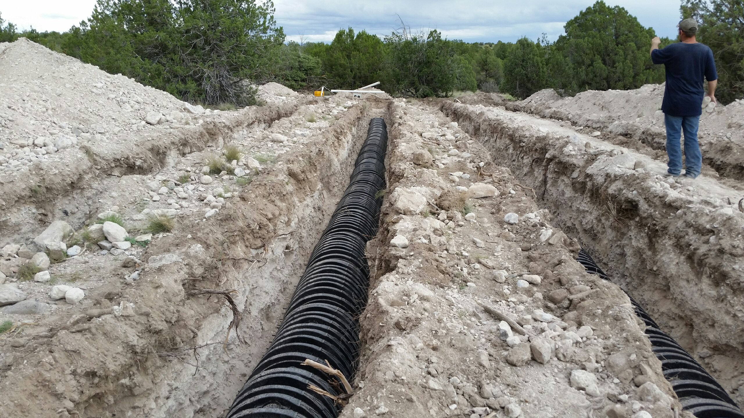

Field lines around here have changed over the yrs. Use to use the 4'' corrugated pipe with holes and gravel..
They now use these plastic chambers with no gravel.
Depending on the age of the home, The lines could be anything.
Dig up outside and cut the main line going to the septic tank 3-4'' pvc ? Flush the toilet. If the toilet drains without any issues, your tank is full, and the field lines are plugged,and won't accept the water anymore..Fieldlines will need replacing..
Pumping your tank will last until the tank fills again, and that's it
/ Septic System Backup Questions #26
Leach fields are usually the problem area and they can be undersized and over-worked, causing clogging problems due to the biomat. If it's an old system then it's probably perforated PVC pipe with leach rock. The holes in the pipe get clogged with either silt or bio sludge.
New systems use plastic chambers which don't have the same issues with clogging but a bio-mat can still form on the ground, although the plastic chambers have a much bigger leach area and work better. Most septic guys up here refuse to use perforated pipe and leach rock. Almost all switched to Infiltrator chambers.

Since this type of topic has come along a couple times recently, I did some research. It seems that most drain fields will completely renew themselves if given a two year dry rest. The essence of having two fields and a diverter box.
