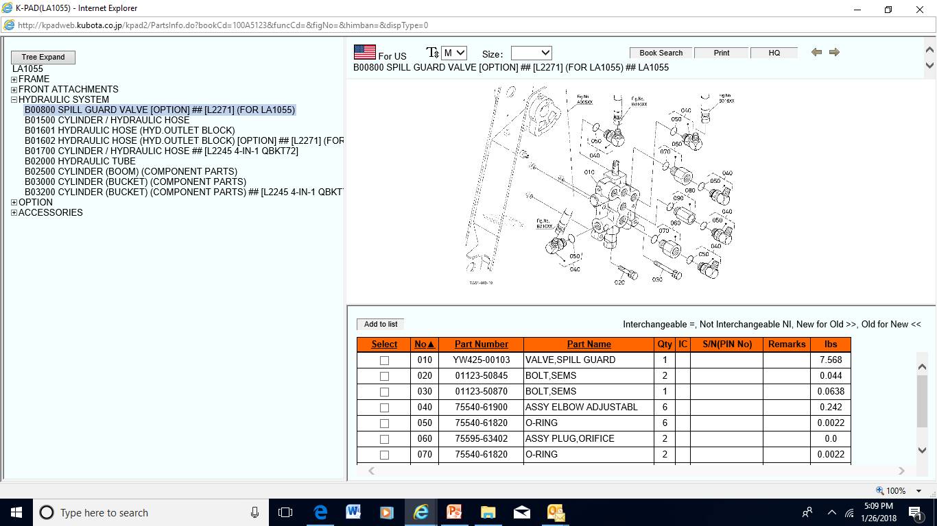

   / Self Leveling Valve for Kubota LA Loaders #9
bdhsfz6,
The option is $599 and can be purchased through wholegoods under order code L2271.
Here's the detail from the Wholegoods listing...
Hydraulic Spill Guard for LA1055 Loader
L2271 Hydraulic Spill Guard, anti-spill feature for buckets 38lbs $599.00
Perhaps if you search on L2271 you can find a parts breakdown or instruction sheet.
For those that might be interest but have the LA805 loader the Order code is L2261 and is the same price.
Hope this helps.
Added in Edit:
Found this at Kubota's Illustrated Parts Diagram.
Keep in mind the wholegoods item number L2271 should contain all the parts to make complete on your tractor including installation instructions.
