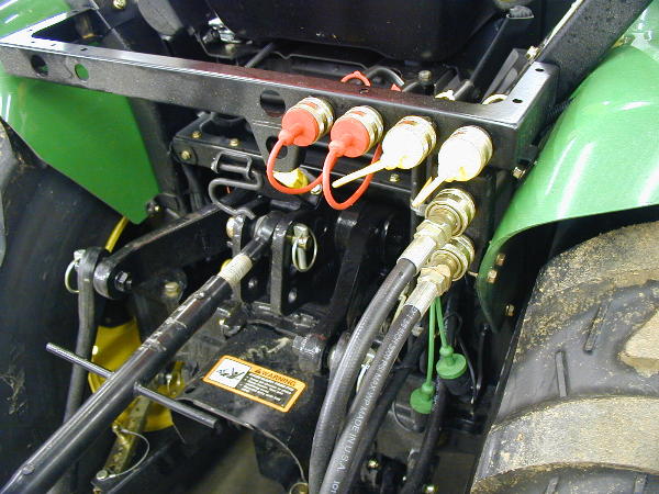

Here's a pic of the rear bar on my tractor. I still plan to add a Power Beyond so I can run chipper power feed w/o negating all other hydraulic functions and need for a bungee on the 3rd SVC lever. The top 4 are from the diverter. The lower RH 2 are the 3rd funct from the lever. The hoses loop under the tractor and come out above the mid SCV couplers.

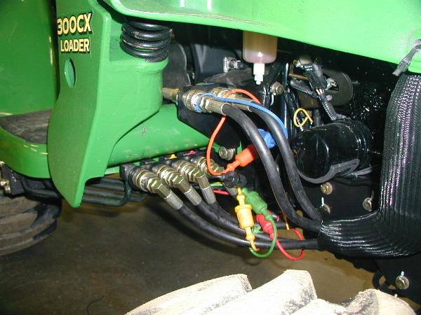

The couplers for the 3rd function loader lines are shown here.
