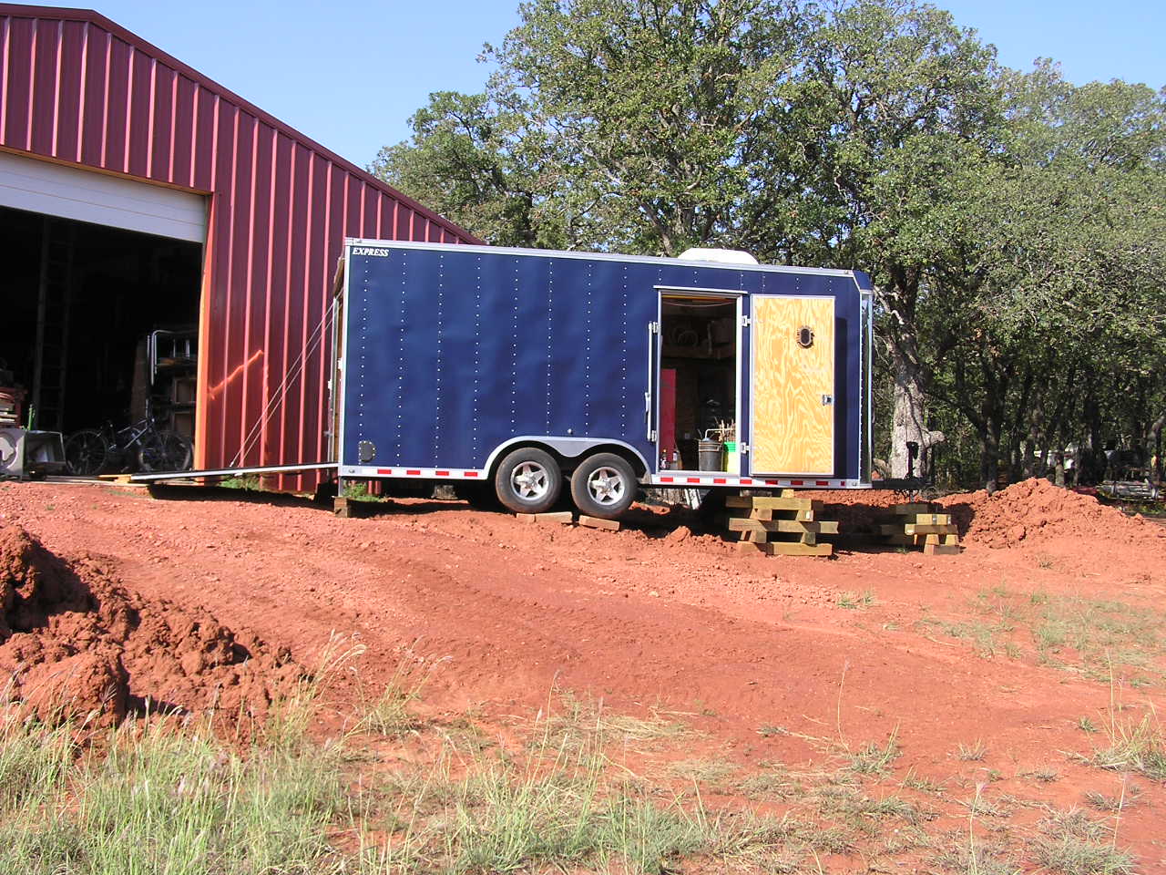

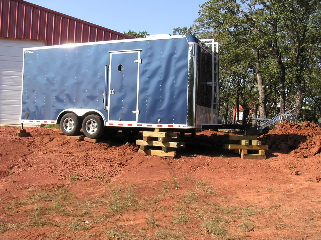

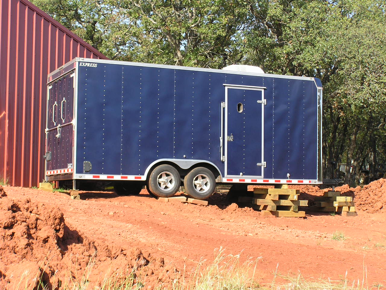

I bought a used 8x20 extra tall, Express when we moved. The guy that I bought it from decided he wanted it back, so I sold it to him.
