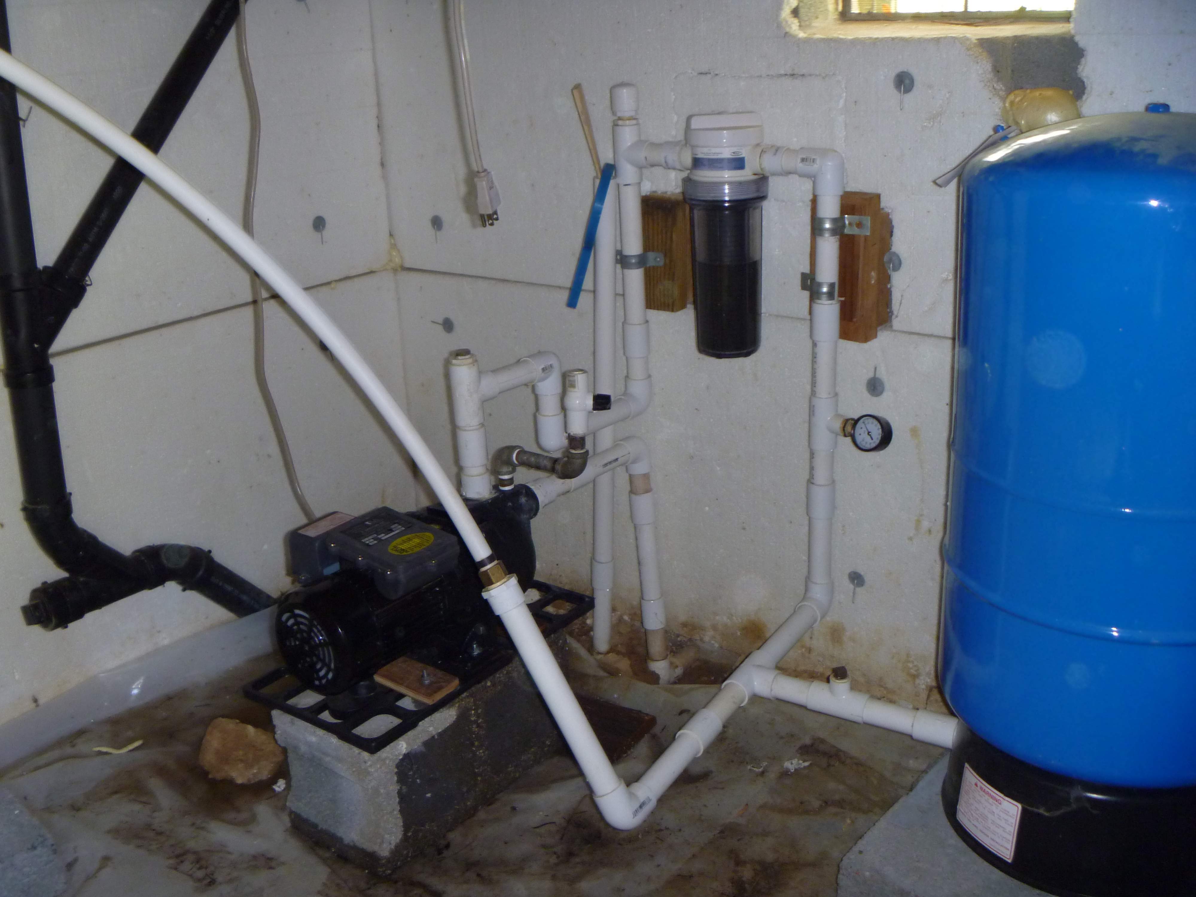

I installed the pump I referenced above but never got it primed so it has never pumped much water. In trying to get it ready for this gardening season I have dug up the suction line in hopes of finding a PVC connection I overlooked solvent-welding but I found none. I have primed (I think) the line by slowly pouring water in the top of the pump to fill the suction line all the way down to the foot valve. The 1" PVC line slants down all the way to the cistern so there should be no air trapped in the line. Plug it in and pressure rises only to about 10 PSI and the pump runs continously and sounds like the impeller is mixing air and water. Pump housing gets warm. Water w/ air in it comes slowly out of the spigot. I have repeatedly "re-primed" it but get no results. Does know a trick to priming that I am missing? If it will help I will post pix of the setup.
Pressure switch is set at 30 on and 50 off. Air tank is at 28 PSI.

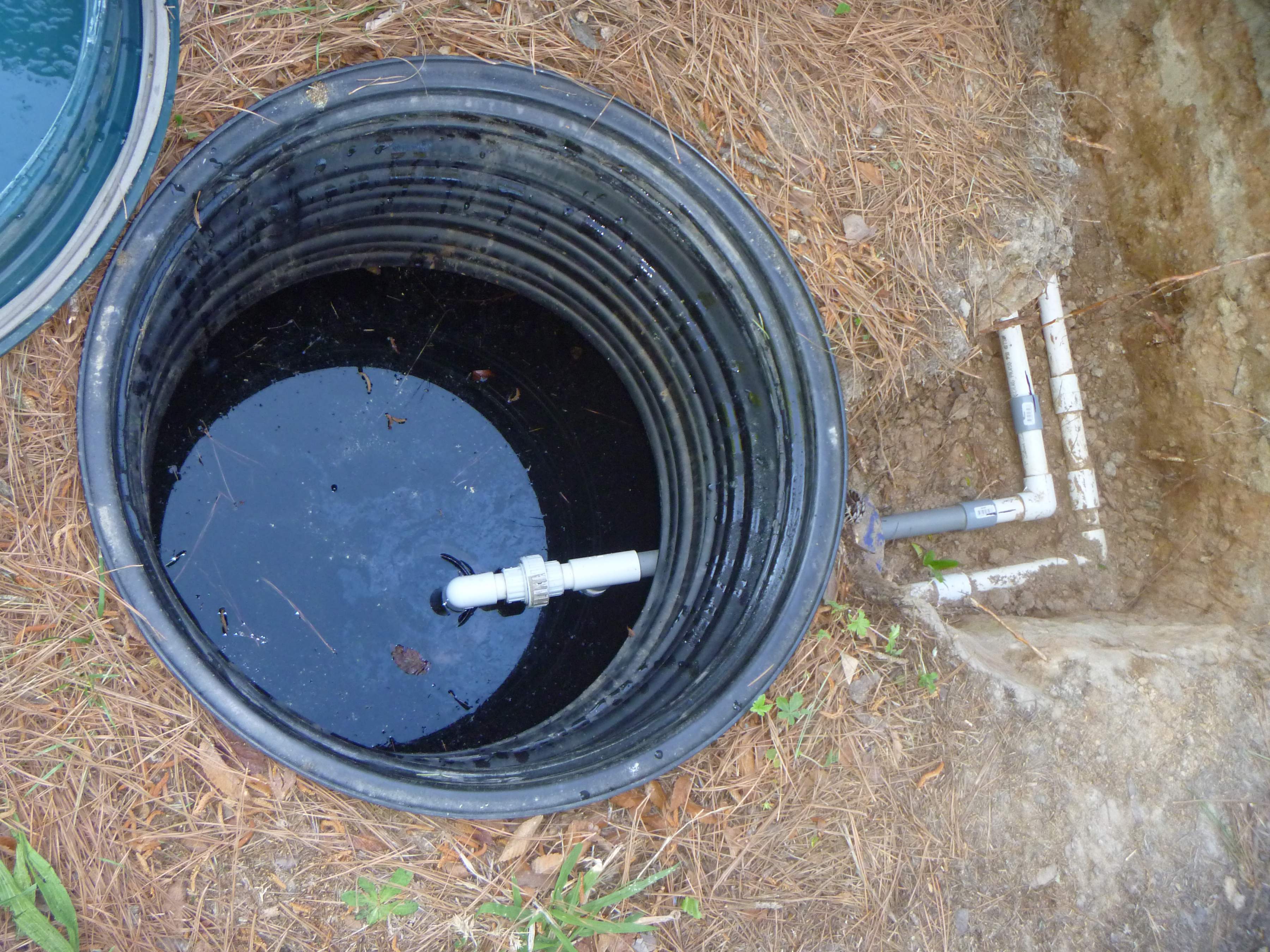

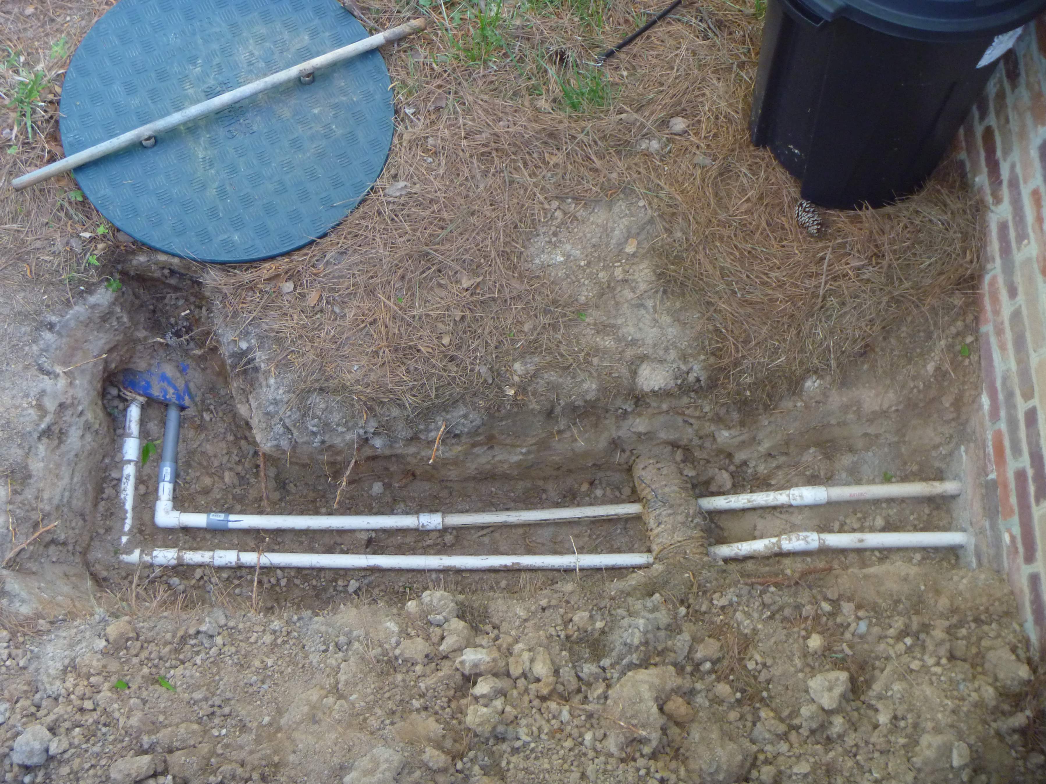

The leak defies location. How would soap help locate it? Air would be drawn in leaving no bubbles. I can get 10 PSI water pressure in the line after running pump. When I shut the pump off I see no water drops but 10 PSI is not much pressure. I talked to Water Ace company and they said a 1" suction line would be fine for such a short run. Here are some pix. There are a lot of connections because I have been making adjustments/changes.
(One of the lines in the trench is a drain for a water softener and has nothing to do with the pump. It is also shown in the crawl space pic.) There is a single 1" line, with part gray elec. pipe, to the footvalve. I know it is not supposed to be used for potable water but this cistern water stinks and will never be drunk.)

Is the pipes outside still uncovered? Have you tried to clean foot valve yet?
If I were you, I would google pressure testing the pipes. You may need to replace strainer with a cap and install shutoff before pump and do a pressure test to see if pipe is ok. If it is, then check and recheck connections from shutoff to pump to tank for leaks.
This method is only way to figure it out yourself without guessing if it a prime issue or air leaks.
OTHO, If you have a bad foot valve or cistern doesn't recharge fast enough it would do what you describe.
