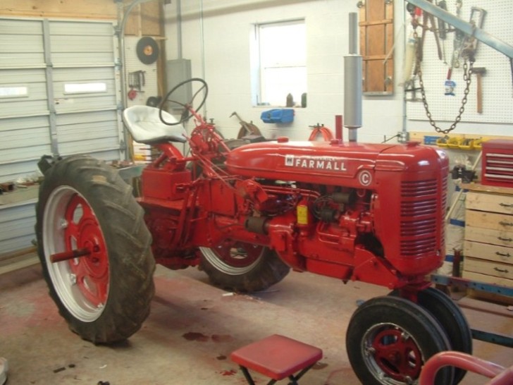

Schrody, I spent a few hours fixing some dents in the fuel tank, and making some brackets to bolt the nose/grill on. A gallon of Farmall red from tractor supply cost 23.00
The decals cost 22.09, the mufler was 19.95 and the seat cover was 18.95 from www.valu-bilt.com
Here it is after painting

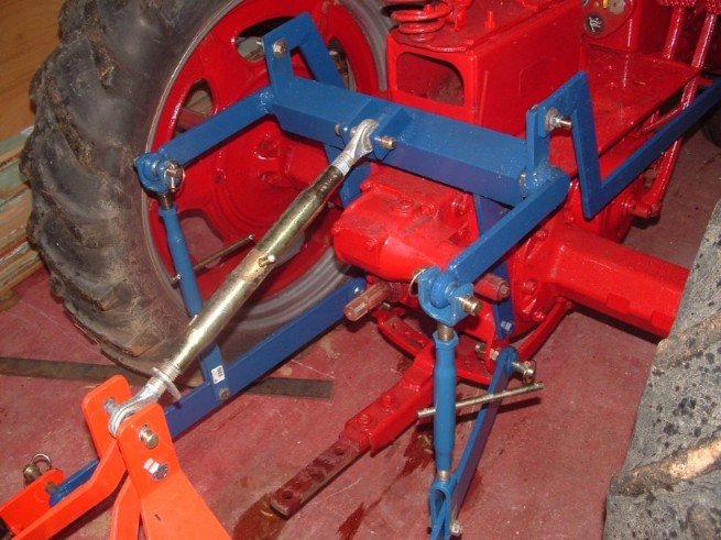

I really like using the little tractor and my wife thinks it looks right for our place(kind of and old cabin in the woods) so I decided to put a 3PH on it. The material cost me, I believe 214.00. I could have bought one already engineered and ready to bolt on for about 700.00, but I have a pretty good shop and the welding and design wern't to difficult. It turned out well and works good. I use it with my 5' Kiota box blade and would rather get on it that my ford 3000. Here is a pic of the 3PH

Whooee.... She's a purty one! Ya done good. Your 3 pt. fabrication is impressive, too. Never had one of those on the 'ol C I used as a kid. Used to hook up to an old dump rake and head out into the heat to chase pocket gophers and rattlesnakes. Nah, my rows looked OK... /forums/images/graemlins/laugh.gif AKfish
