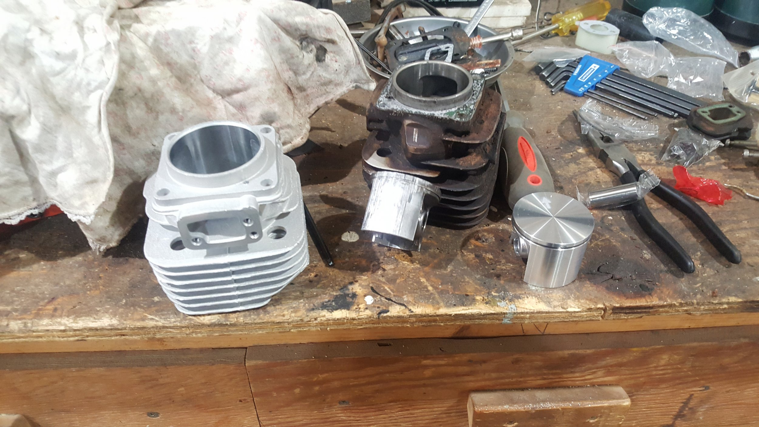

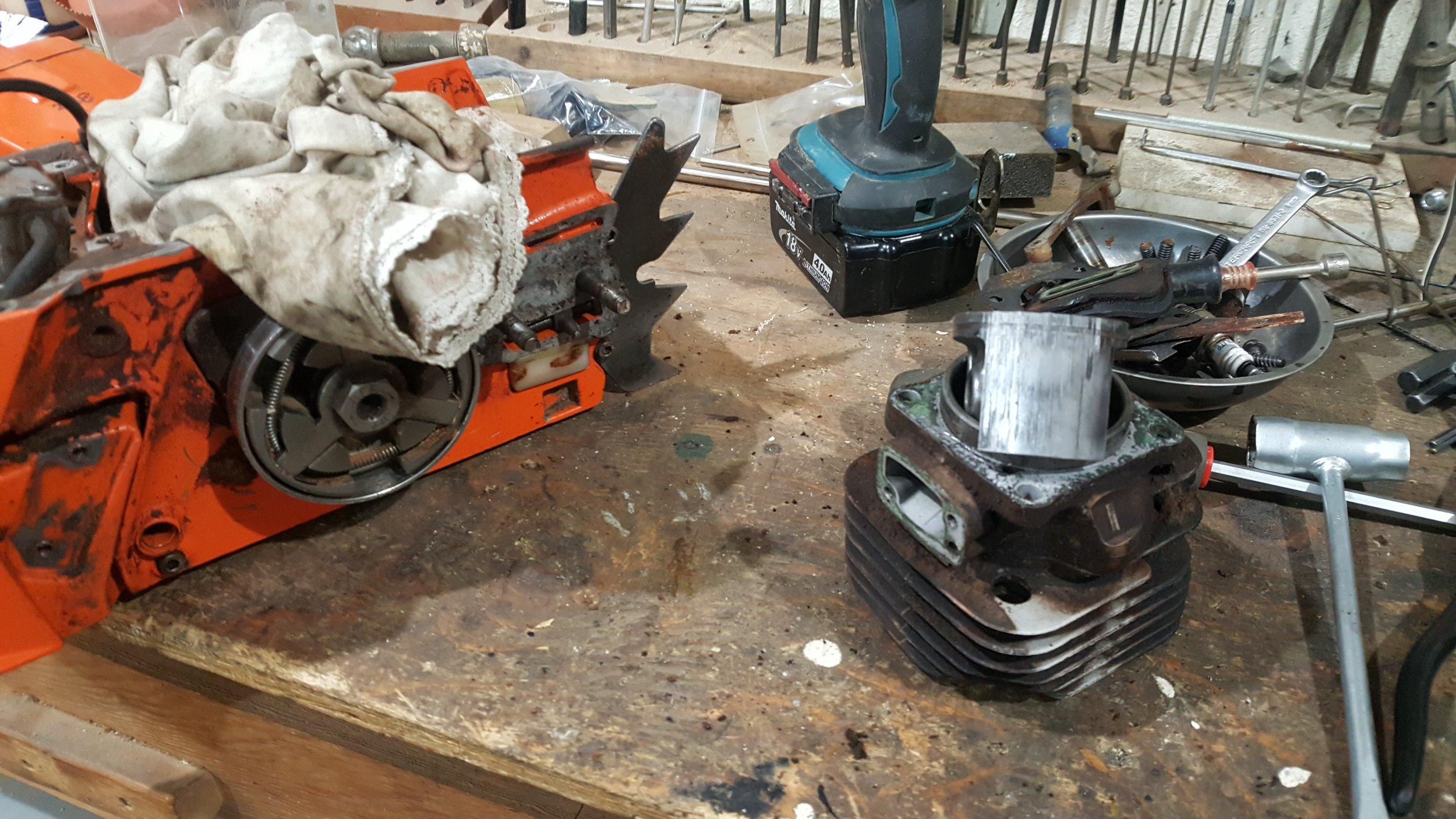

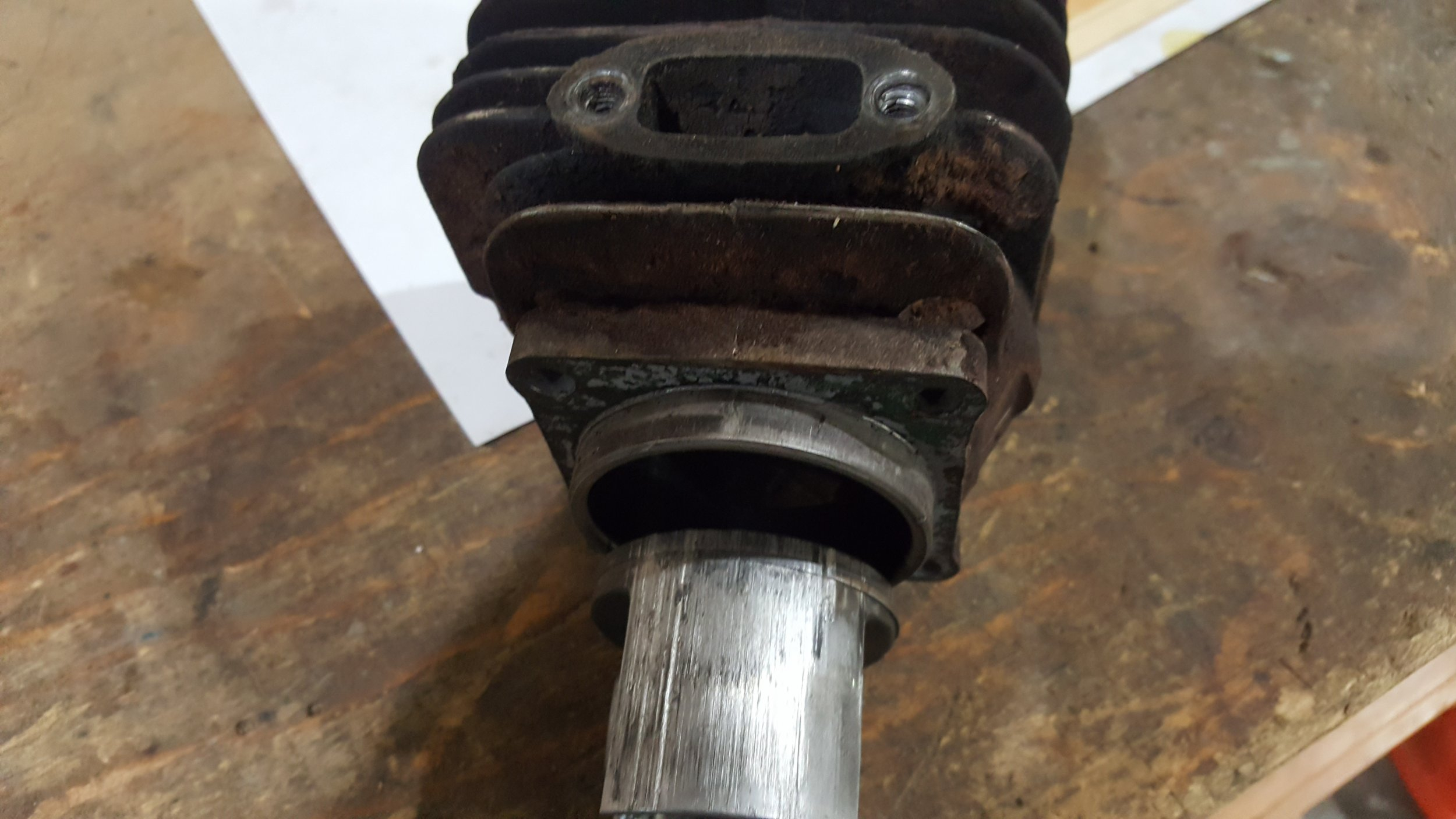

The more I look at it, the more I think you're right. Those two ports are on the exhaust port side from the pictures of the 570 that I've seen. Would love to see the other side of the inside of the cylinder and the piston.
If that is the exhaust port and that side of the cylinder scoring lines up with the side of the piston that is shown, the piston has been installed backwards which could cause the ring gap to snag on the exhaust port.
   / Seized chainsaw #112
A foreign object could be anything. Especially if it was ever started with the air filter off. Or a broken part. Tip of something. Unless you find it, it's all a guess.
Was the piston scored all the way around, or just on that one side?
The foreign object is the ring anti-rotation pin that came loose from its location in the ring groove, opened up a area in the side of the piston and then jammed between the side of the piston, and the cylinder wall which is the reason for the deep gall mark down the side of the piston.

For seizures caused by overheating, insufficient oil or detonation (which is most of them), the damage is always on the exhaust side. It's because that side of the piston is hottest. So the oil film fails there first, or the ring get stuck first and then overheats the piston and the oil film fails.
If the piston was installed backwards causing a ring to snag in a port it would have failed immediately. From the pics you can see the engine has been run a number of hours.

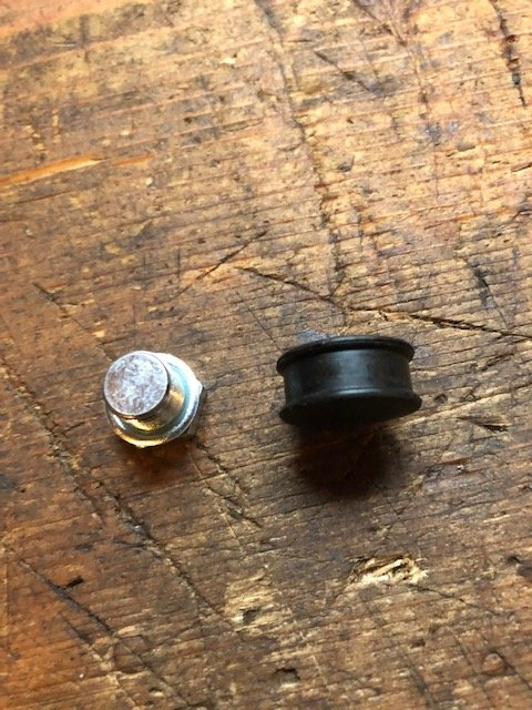

Just got OEM cylinder kit. It came with some parts... On the picture: metal plug is for decompression. What is this rubber plug for?
Anybody?
