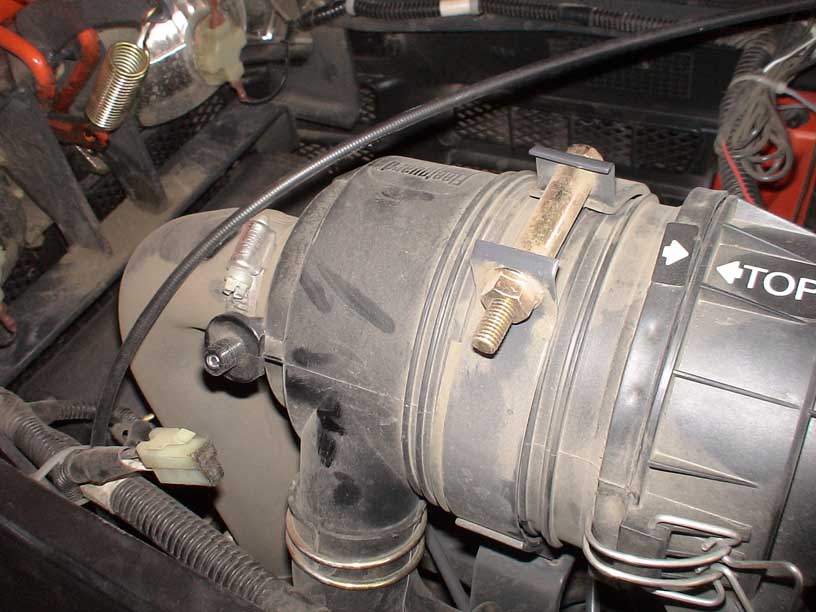

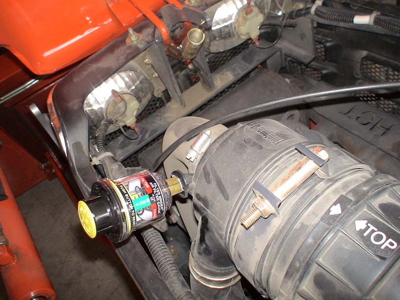

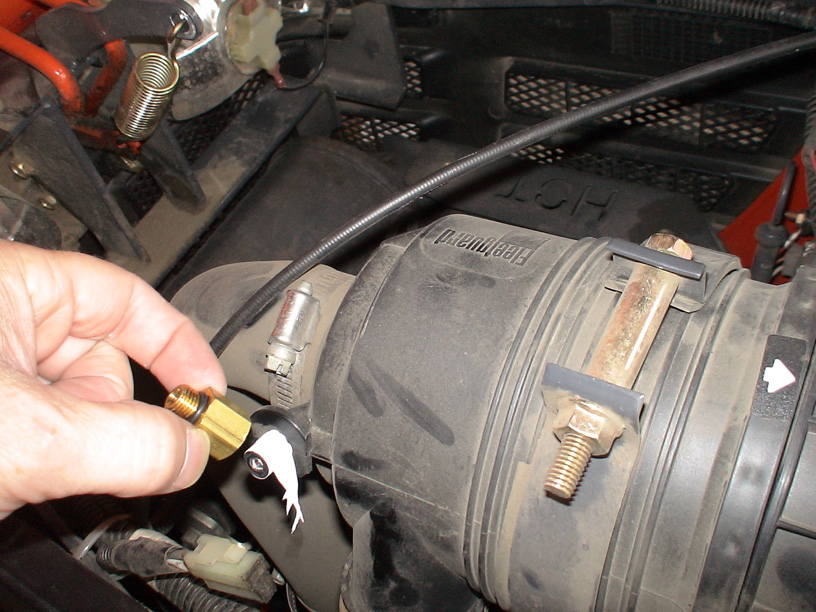

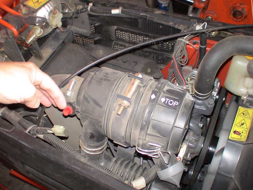

So I got me one of them Direct Mounted 3905161S Fleetguard air filter minders. As it suggests, most air filter assempbly have a tap ready to accomodate.
attachment.php
Remove the red cap
attachment.php
We simply add a little plumbing tape and the brass fitting that seems to screw right on.
attachment.php
Voila
attachment.php
Problem, of course, is that you cannot close the hood. :confused: I found a brass "L" that in theory would work, but the only one I found has a sleave that moves and secures by snuggly tightening against the base and I don't trust it. I need a solid brass "L" or I would recomend opting for the remote Fleetguard Filter Minder 3911025S - with a 25" air hose.

So is the air filter minder's spring rated for that little motor? Looks just like the filter minder that I have on my 7.3L turbo diesel. If the spring isn't light enough and specifically designed for the size motor you're attaching it to, it will do you no good - the filter will plug up completely before the filter minder will show anything.
I know it seems like a nice novelty, but with those filter minders, you shouldn't completely rely on their accuracy, since their accuracy relies on nothing more than a flimsy, mass produced steel spring.

In your pictures, I see a wire plug in the same area. Is that plug connected to a lamp on your dash for the air filter alert? On my L4200, that filter minder is not just a mechanical, visual thing… it is an electrical switch, when it activates it will light the lamp on the dash.
The reason I ask is, if you already have the wiring harness and a lamp location on the dash like the grand L series, and I’m sure others… why not get the electrical switch type?
