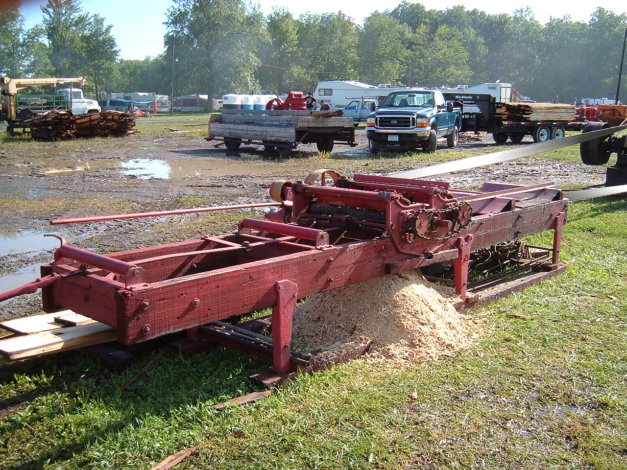

   / Seeking Ideas for a Rail Saw...Removing Live Edges... #30
Here is a rig that can do what you want. It isn't new, I guess the steam power is optional. DSCF0110.JPG
