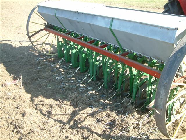

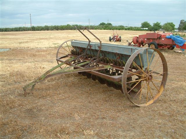

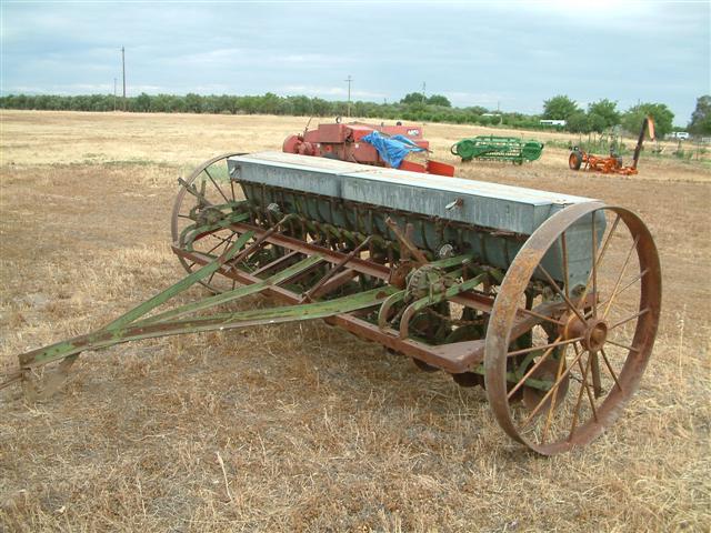

Or you can go the really low cost route and find a used grain drill in your area and fix it up. I did that with a couple of Minneapolis Moline P3-6 drill that I found locally for $275. Put another $250 into the project and used parts from both drills to make one usable one. Planted 6 acres of Kanota oats with it a few years ago.
Some guys cut these 10-footers in half, rebuild the two parts into 5-ft wide drills and sell them on eBay to food plot folks for $1500-2500.
That restored drill worked pretty well for oats

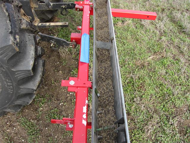

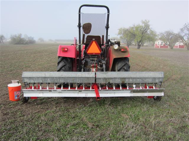

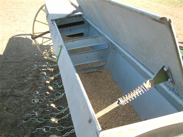

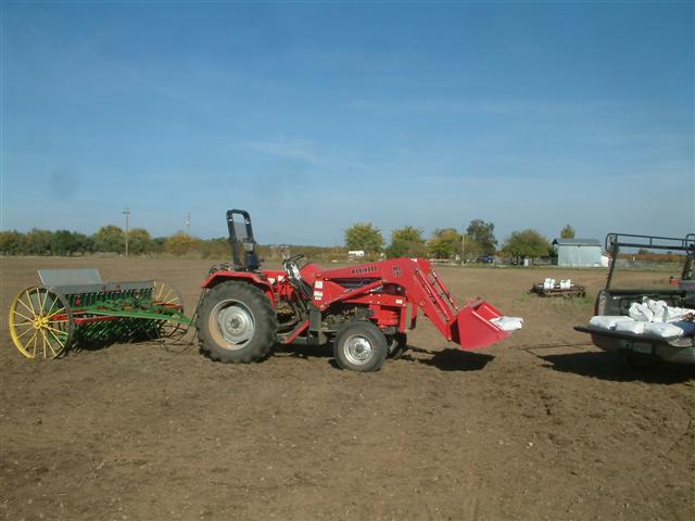

Those two MM drills had grass seed boxes so I used two 5-ft wide boxes to make a 10-ft wide drop spreader that worked pretty well. Planted a mix of annual ryegrass and Lana vetch to test it out on two acres.
Good luck.
