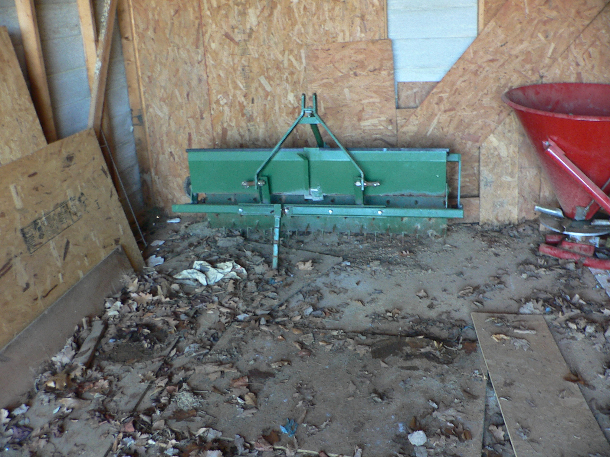

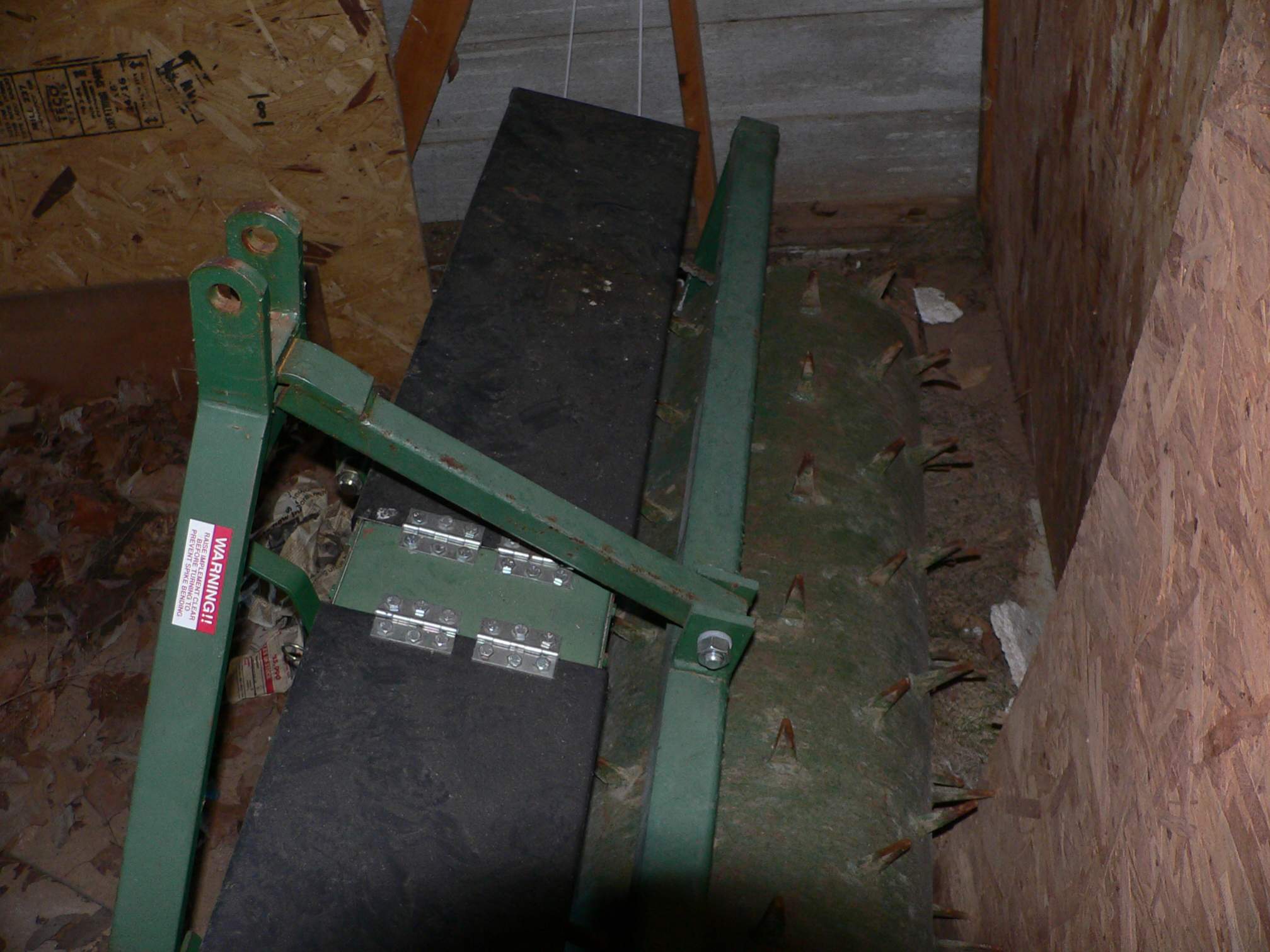

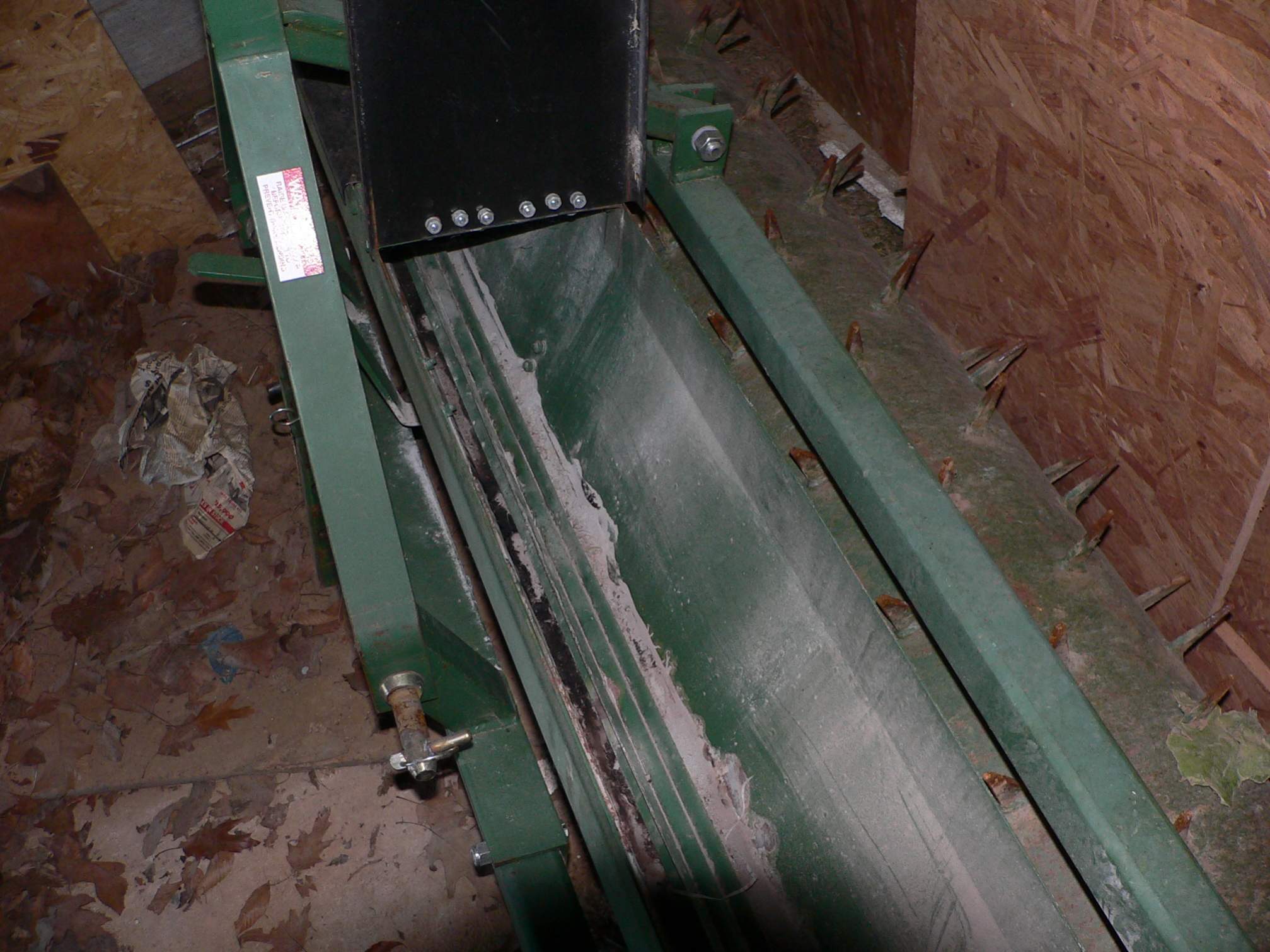

Looks like we have several new buyers of tractors in the last several weeks. I'm seeing questions concerning spreaders, rollers and aerators. I've bought and tried different implements over the years, some I keep and some I've sent to new homes because they didn't or currently don't provide much benefit to me. I've kept a FEL, MMM, BH, Forks, RatchetRake, Boxblade, Tiller, Quick hitchs, Drawbar, single bottom plow and Ferguson Overseeder. Sold toothbar, Landscape rake, Pat's, Big Funnel shaped fertilizer spreader, RFM, Posthole digger and grader blade.
Here are pictures of Ferguson Overseeder which I can use as seeder, over seeder, roller, aerator and fertlize spreader. Must be cleaned well after using for spreading fertilizer as with all fertilize spreaders. It's one of my major keepers which me, my brother and nephew count on using for grass seeding and over seeding. If interested in buying one, check around because I've seen some prices that seem way above what I paid for this. Milkman said they are made in North Western Ky.

With the 3ph this will lift up off of the ground when a turn is made then set back down after the turn is made which also stops the flow of seed and/or fertilizer. I usually just go and tear it up but I could lift it if I was so inclined.:) This can be lifted with 3ph to where spikes are entering ground but not the roller compacting but I just let it compact. I have a yard with grass and weeds and rocks and stuff. My brother the Certified Master Gardener has a lawn that's lush like carpet and he has banned all weeds. He is a believer in books and other specialists theories and all. I don't have a core aerator and neither does he so he uses my spiked roller and his magazine cover yard really looks great. Hope he doesn't read how bad my Overseeder with spikes and not aerators is or he may stop using it.:) I'm sure there are better more perfect implements for every job but maybe they cost more but what I have and have been using for several years is this spiked roller no extra wheels Ferguson overseeder and I'm going to keep using it.:)

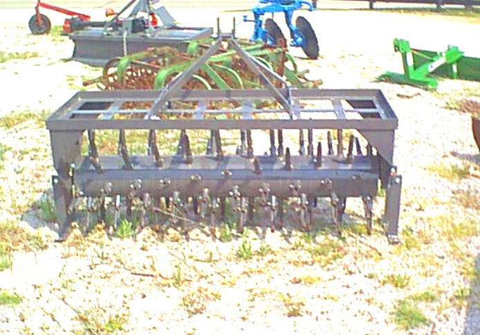

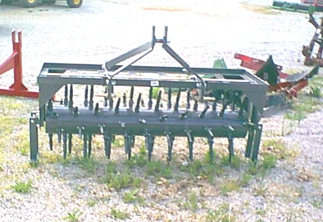

We are now stocking the high quality "Tarter" brand Core aerators. Example price is 5 ft extra HD $1195 and made in USA. Ken Sweet
