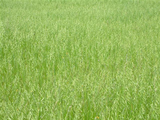

No problem handling a 10-ft wide drill with that JD 970.
If budget is a concern, you can check eBay for grain drills in the $500 to $2000 range) that are ready to go.

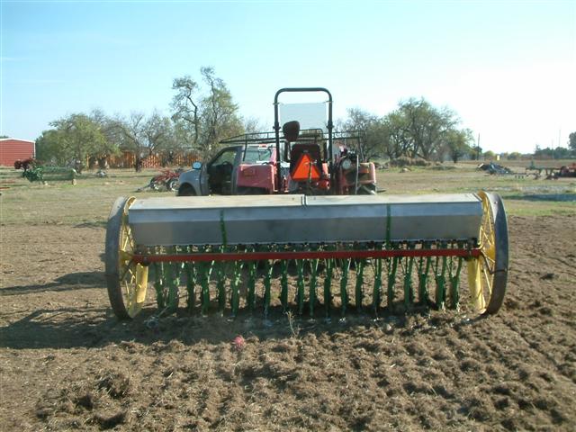

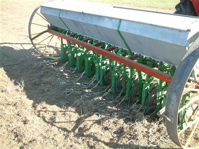

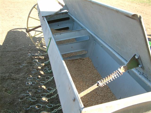

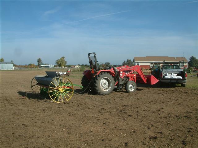

If you want to lower your purchase cost, you can do what I did--buy an old drill and fix it up yourself.
I bought two old Minneapolis Moline P3-6 drills (10-ft wide, 20 drops, single disc openers) from a neighbor for $275. Spent about $200 assembling one good drill out of the parts from both units.
DSCF0156 (Small).JPGDSCF0157 (Small).JPGDSCF0158 (Small).JPGDSCF0159 (Small).JPG

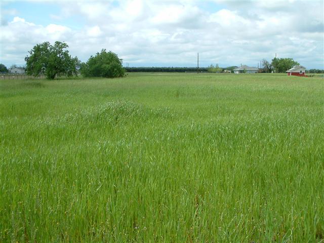

I plant Kanota oats on 6 of my 10 acres. Took about 3 hours to seed the hayfield. Results were pretty good.
DSCF0091 (Small).JPG[/ATTACH]
Good luck
