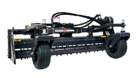

Tilling works well, if you are renting equipment, consider a harley rake, nothing makes a seed bed better.

What's a Harley rake?
   / Seed Bed Creation #9
Powered box blade. Rotating drum with teeth. This one is for skid steer, they make a 3pt as well
