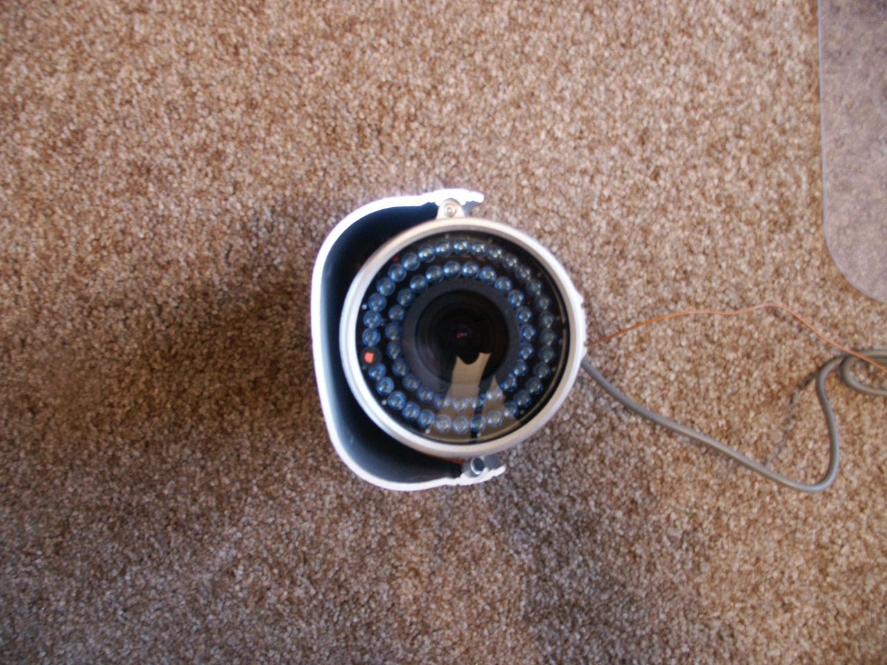

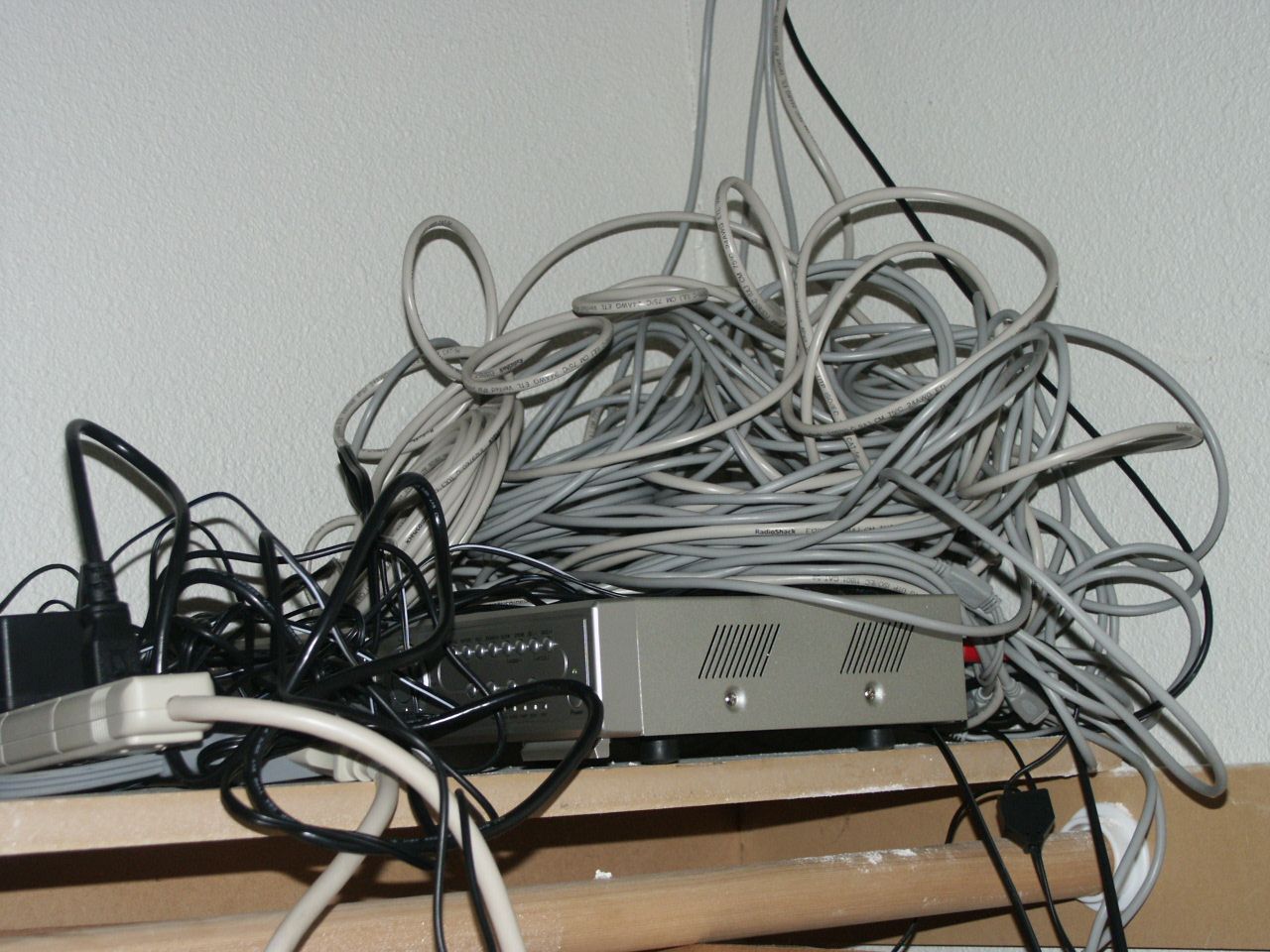

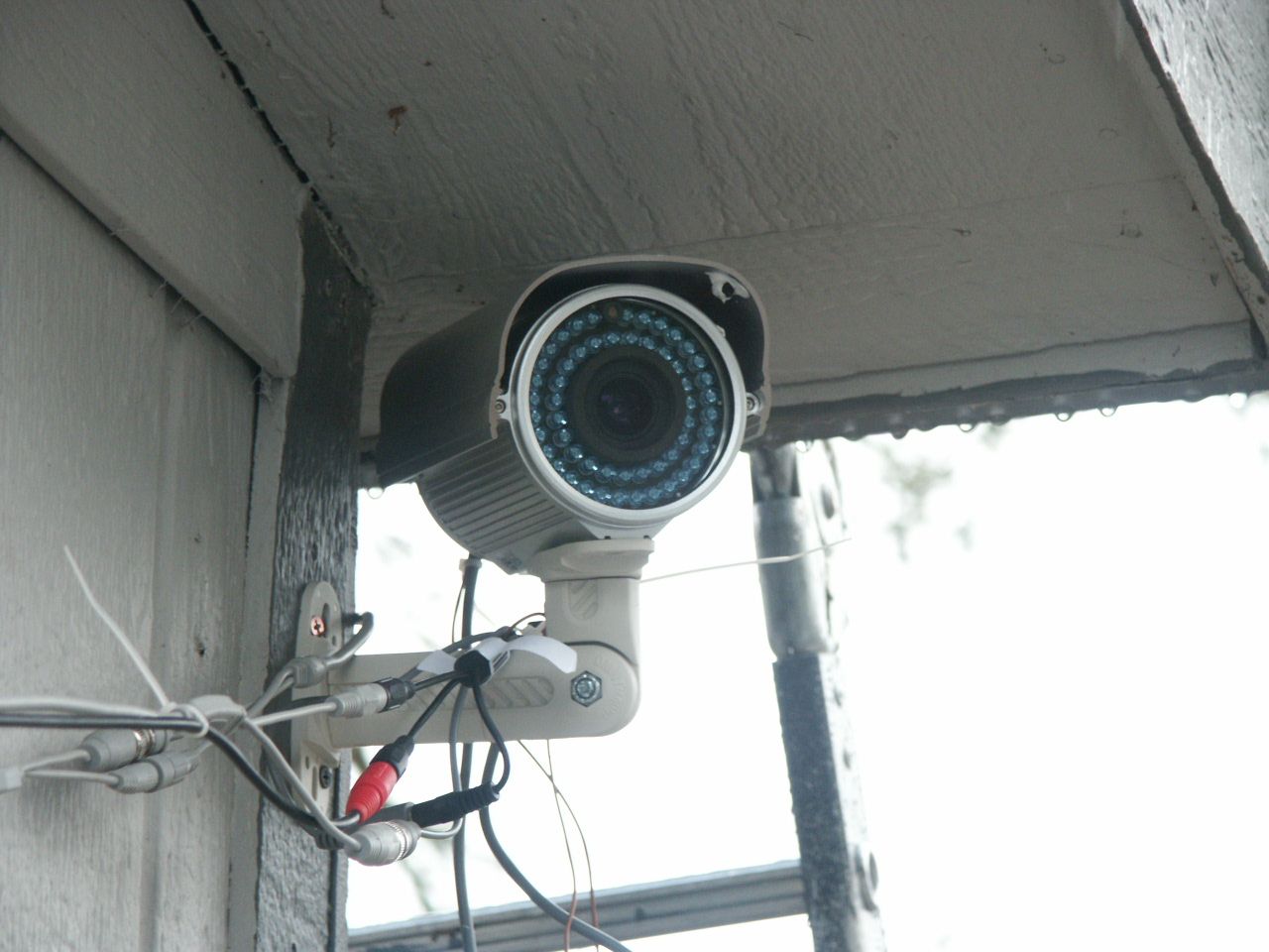

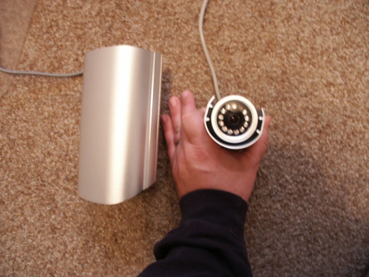

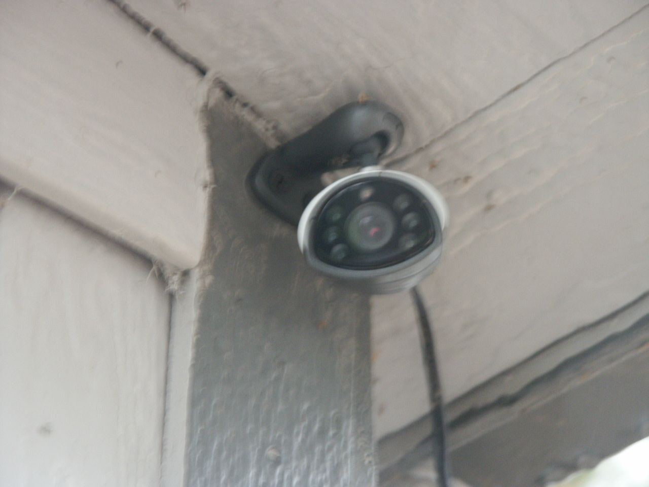

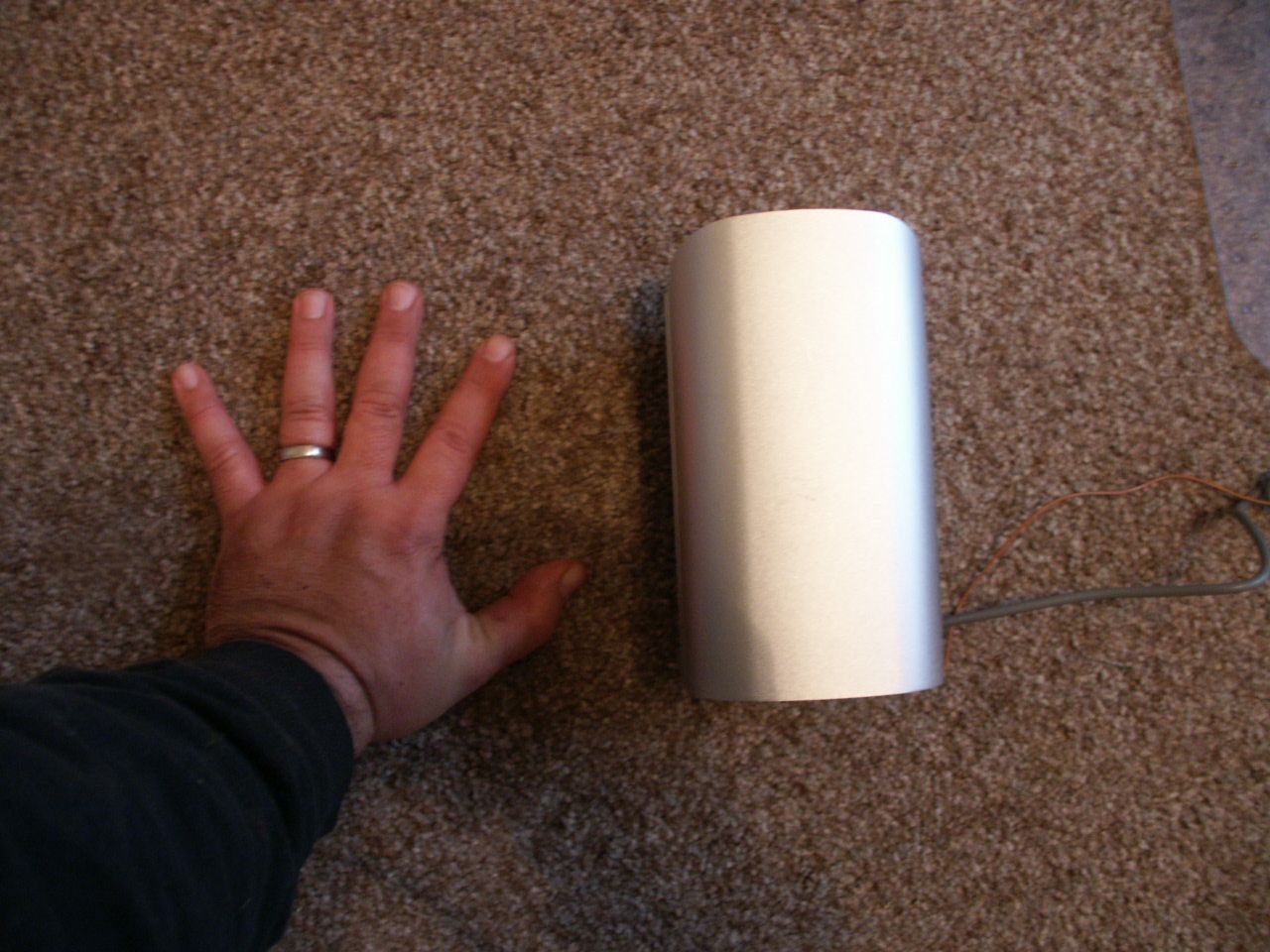

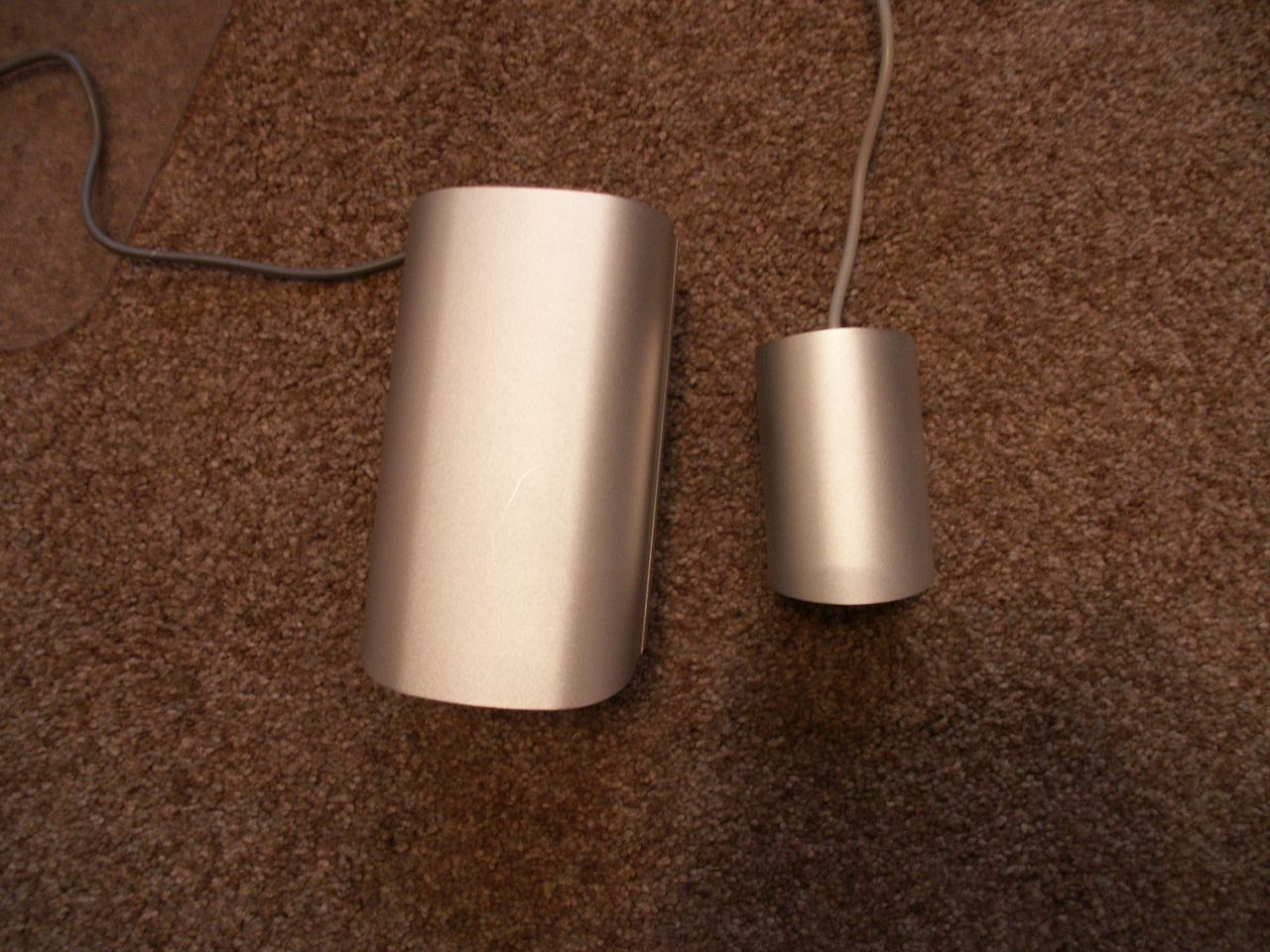

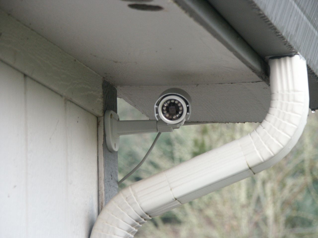

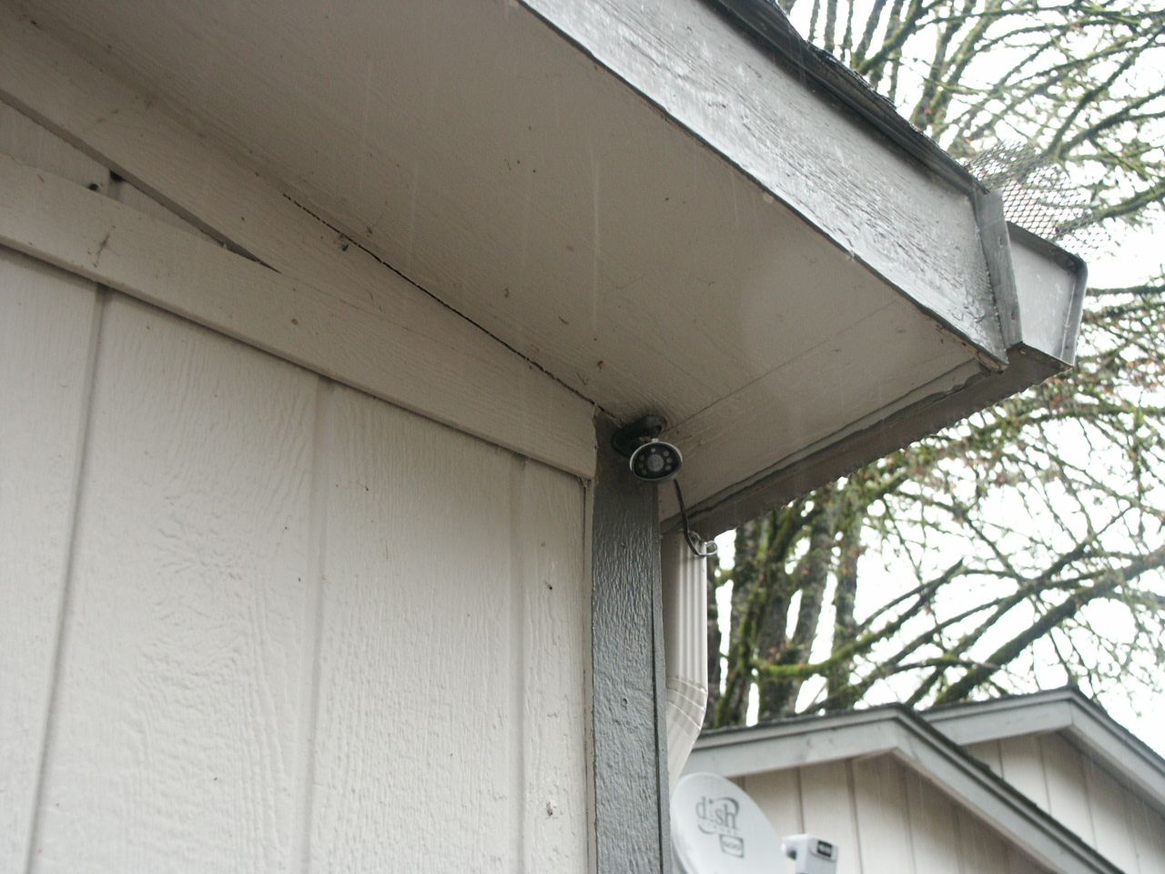

Yesterday all the toys finally arrived.
I had ordered one camera with 54 LEDs
Lot of 100 Sony HAD CCD 420 TV-Line 54-LED Infrared Camera Varifocal 3.5-8mm
and 2 with 12 LEDS GadSpot.com GS306
And this DVR GadSpot.com GS1800
I had the hard drive allready. I also ordered a microphone and a few cables.
Well, the 12 LED cameras are good. I am happy with the purchase other than the mounting bracket is not what is pictured (a bit bigger).
The 54 LED camera is a bit of a pill. it has a zoom lense, and a focus ring. Saddly, you have to take the whole thing apart and so far I cannot get it to focus sharply. Taking it apart is not difficult, just a PITA. Also, the 54 LED camera is HUGE by comparison. And at the moment it is slipping in and out of focus so I have to figure out what is next with it.
Also, the DVR is a royal PITA to set up. It has lots of features. But man it is totally Chinese. The manual is terrible and the interface is horrible.
Anyway, here are some pix. -- First is of my original camera. Second is of of the new cameras and size comparison. Third is rough install pictures and the last is of my DVR and the quality wiring job I did.
Once i get the focus set I will show some day and night images.

Nice new setup woodlandfarms, I guess there are no racoons were these cameras are because they'd have those wires unplugged in a second. In Texas we have to hide our wires and lock up the power supply on our deer feeders or they will completely trash the whole thing. A great solution to monitorshops and barns in remote location. Thanks for the great posts.
/ Security Camera pays off #37
I have to say, that large camera is a beast. And all those wires on your dvr :eek: wow Hopefully after some tweaking, it'll step up to your expectations. I should be getting my components late next week, I'll be sure to post pictures and answer anything I can. The cameras are supposed to have an IR range of 60', but we'll see how accurate that is. I just wish they didn't look like flying nuns...

A dab of silicone grease in those outside RCA connectors will help keep the moisture out and keep them and the wiring inside the insulation corrosion free. Also tapeing these up and gettignthem out of sight would be good as if they can be approached froma blind side, it is a simple matter of someone unplugging the connections. For this reason, I like cameras placed WAY up high, and very out of sight(people rarely look up).
#40
Absolutely thankyou all on the advice. The pictures I showed were of the first install. I have found that no matter what I do, the first time something goes up it is always wrong so I left the wire hanging out.
Intend to silicone it all up and tuck it away once I am happy with my setup.
