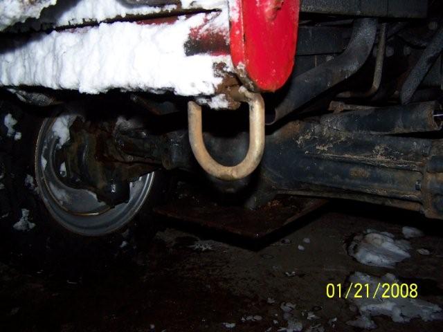

I bought 2 of these tie down hooks and welded them to the tractor loader frame. Now I slip the chains through these on the tractor and the larger ones on the trailer and secure with a ratchet binders.
