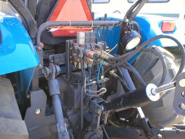

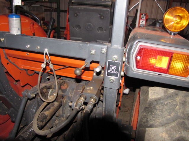

I was able to modify both of my OEM top link holders to work. On the red tractor all that I did was twist the hook 90* and it hooks perfectly on the hydraulic port. On the blue tractor all I did was heat up and widen the hook to accept the 3" cylinder.

Boomer, I think that you might be able to just twist your OEM hook retainer 90* and hook on to the hydraulic port as I have done on my red tractor.
One of those things of you won't know for sure until you have it on the tractor.

Does the OEM hook catch on anything? Not that a flexible strap does not work, it does and will. When you have the top link hooked with a hook like the OEM hooks, the cylinder does not move. I have had zero problems with either tractor going on 7 years with the blue tractor. About 800 hours of use between the 2.
