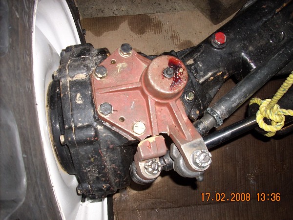

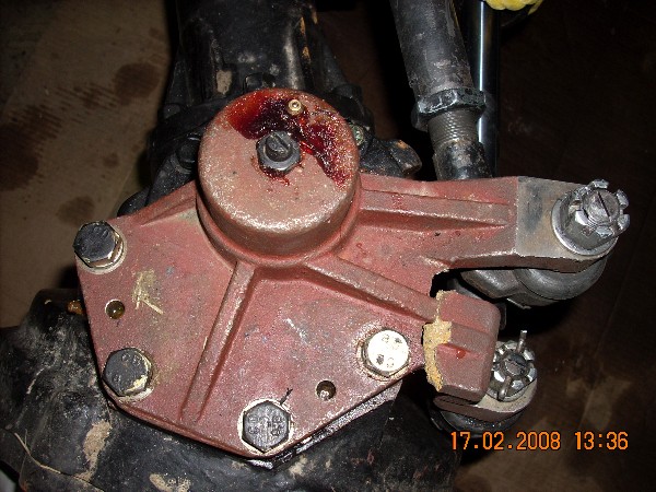

Hi Guys,
I think I have found the cause of the problem.
I worked on the tractor this morning and checked everything out that might effect what happened. Lifted the front up so I could work on the wheels ok. Removed the bowed tie-rod tube and straightened it as best I could. Reassemble the linkage and adjusted the toe in to 10mm at front (specs call for 4 - 11mm). Turned the wheels hard over to the right so the mechanical stops made contact and then lowered the tractor to the floor. I then checked to see how far the power steering rod end would travel when hard over by turning the steering wheel. Well, the rod end went almost 1/2" further than the control arm. In other words the ram was trying to move the arm after coming up to the mechanical stop.
I am pretty sure this extra motion is what has broken the control arm. Adjusting the ram stroke will eliminate this problem - I hope. I don't know where the system pressure relief valve is just yet (for the steering system) so the travel adjustment should work just as well.
So, you guys out there that have purchased the new Jinma 554 tractor, make sure you check the power steering rod end movement. Too much travel will cause the small control arm to break and you will loose your steering.
You can see what I mean with the extra travel, in the attached picture.
Hope this helps someone else from getting similar problems.
Jim

   / ******Second Jinma 554 Steering Failure***** #6
I would think this to be normal for the cylinder to be able to over travel the stop. I would take Chips advice and lower the pressure regulator for the steering pump pressure.
   / ******Second Jinma 554 Steering Failure***** #7
Adjusting the pressure and/or the travel of the cylinder are only to help protect a part that may be too weak to do its job. Normally, as Schmalts says, the cylinder should be able to turn to the stop. The color of the break makes it look like it may be a defective casting, perhaps a bad batch from the foundry.
