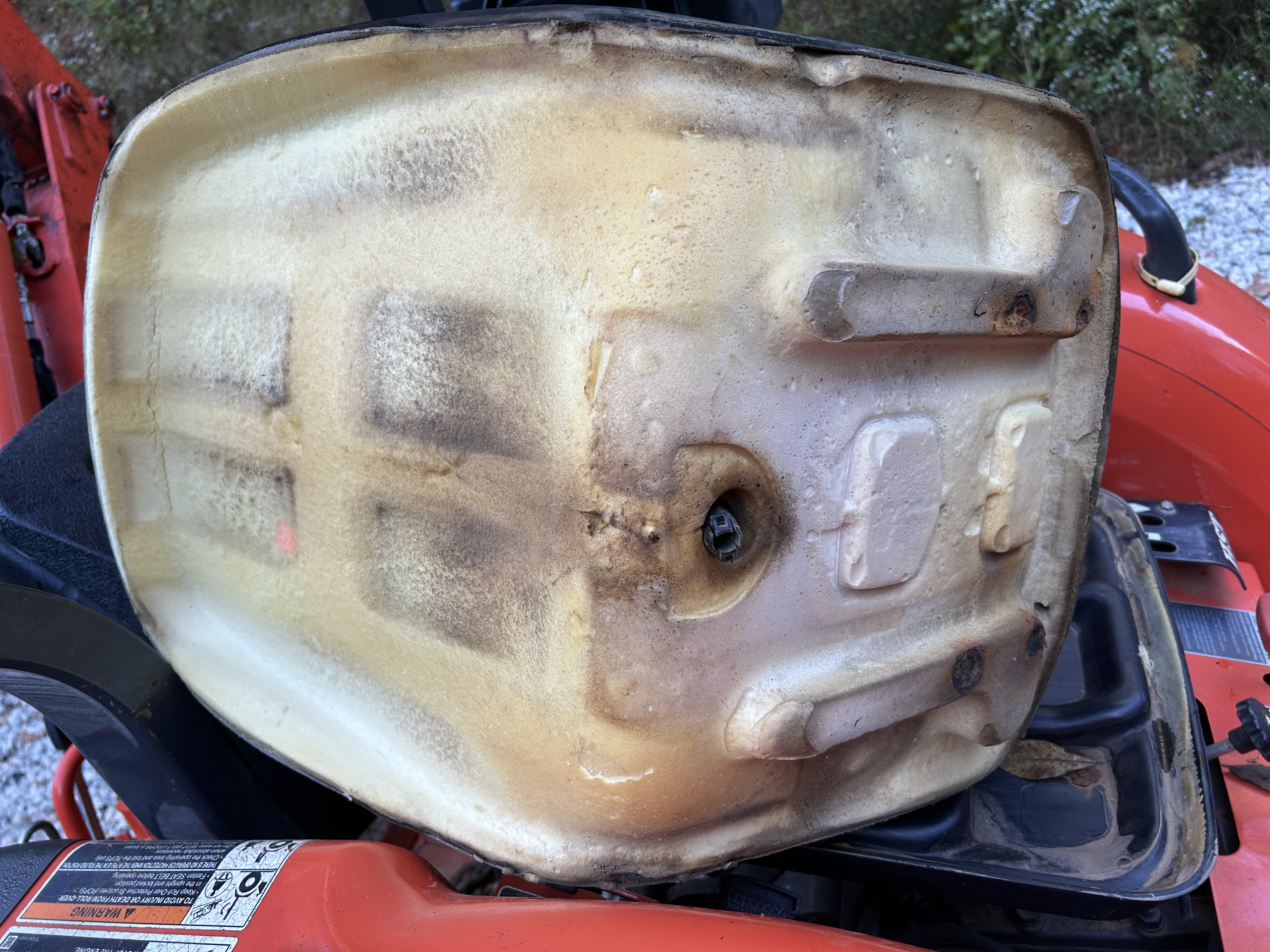

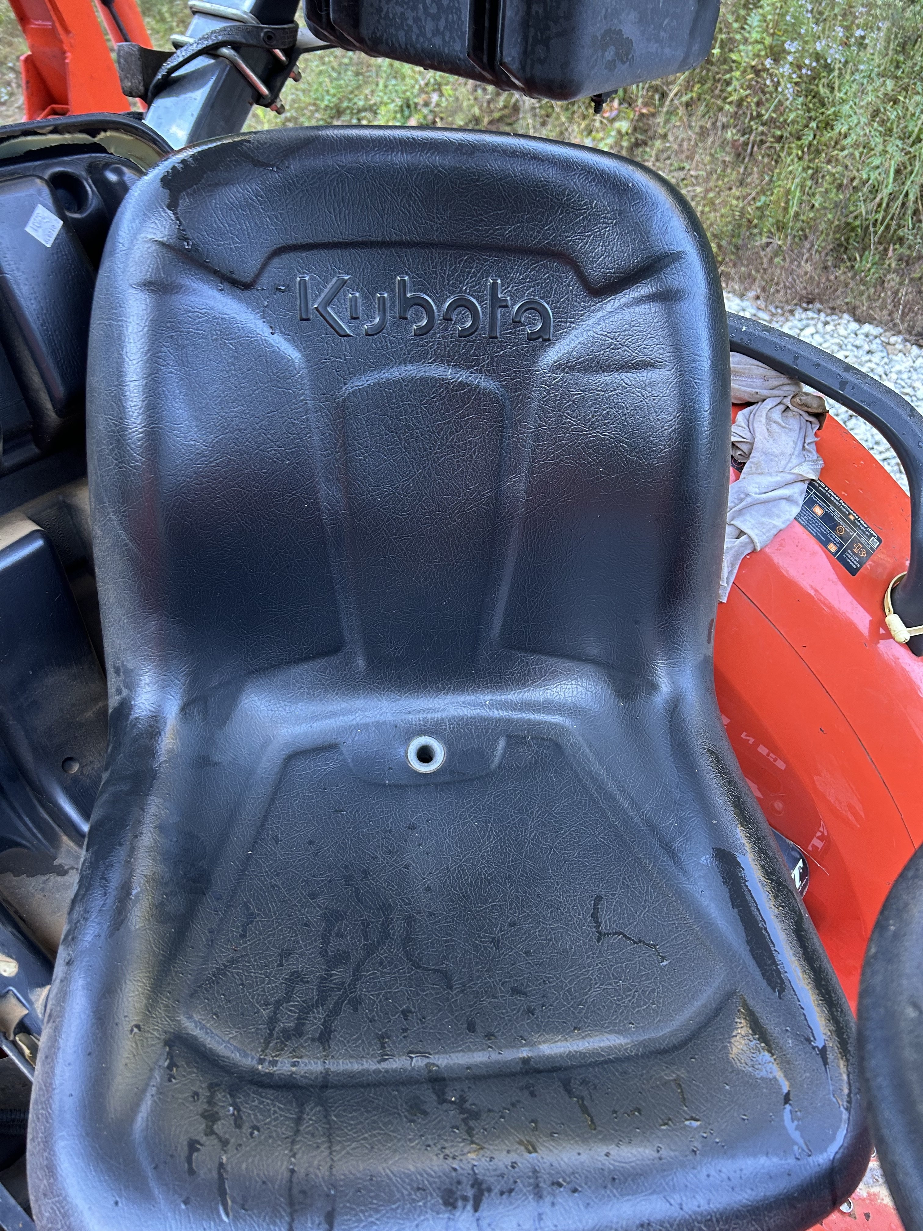

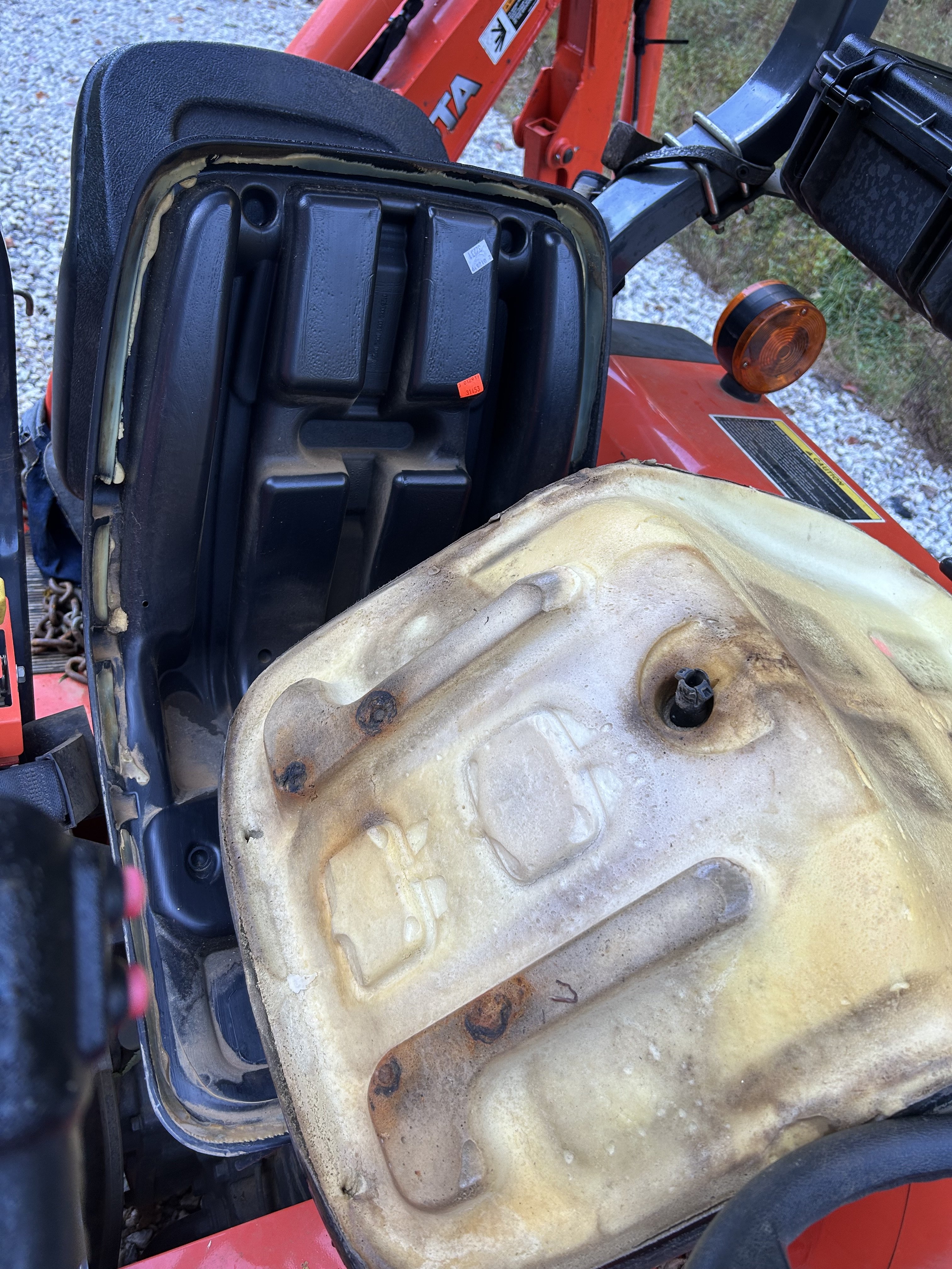

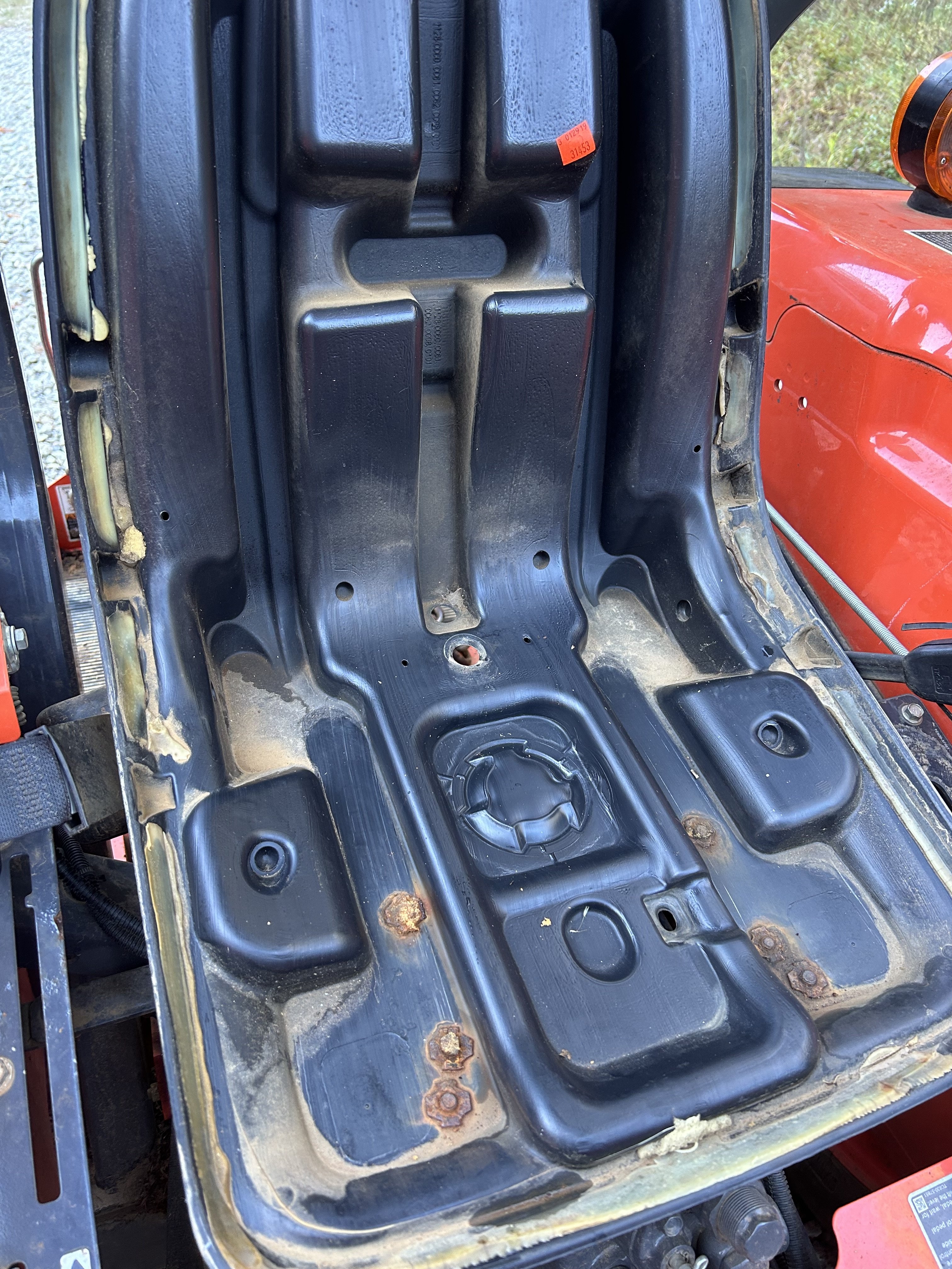

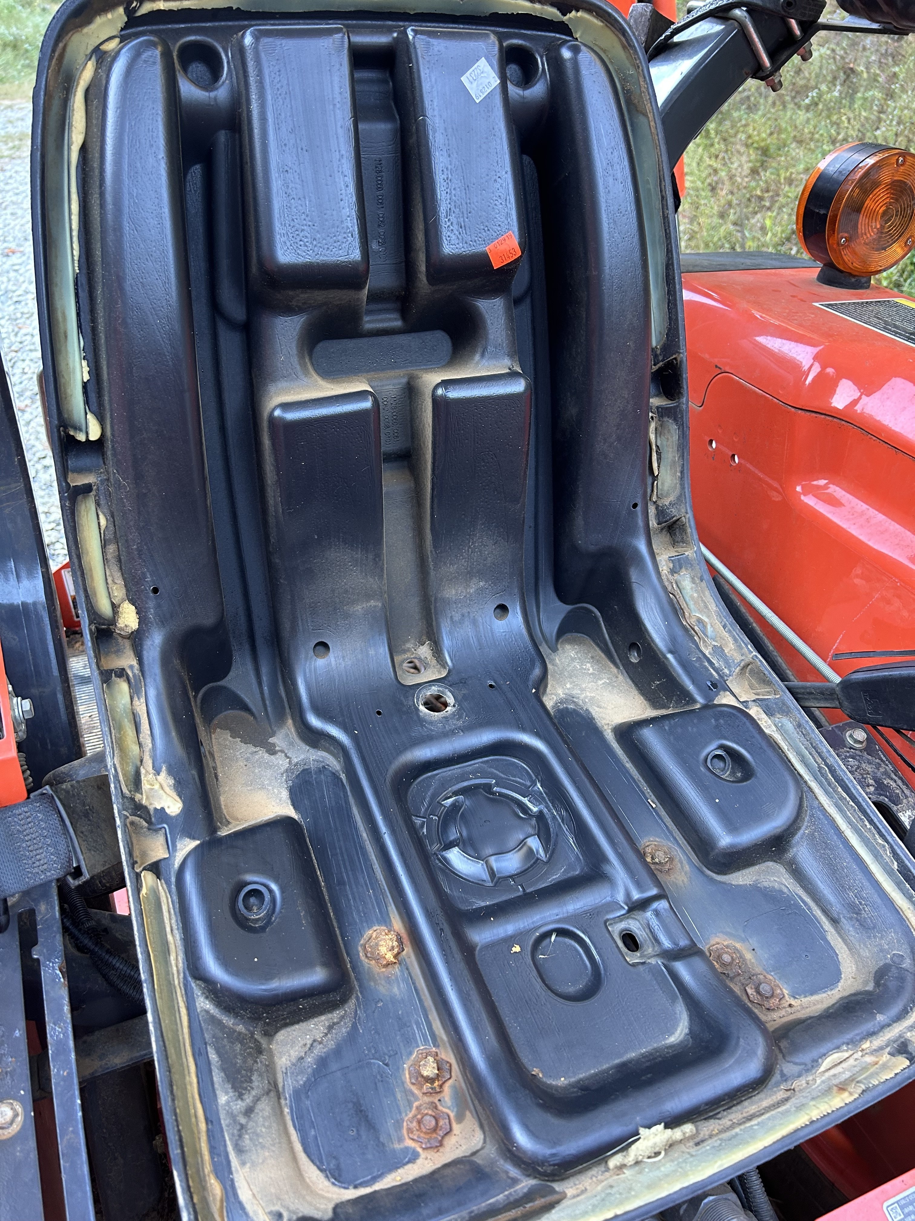

Has anyone had any success reconnecting a seat cushion to its base mine has come off? The cushion and the base itself looks good. They just need to be put back together. I use a backhoe a lot so the seat does get flipped up a lot so there’s that abuse but everything else looks to be ok. I think it just needs to be glued on again(gorilla glue maybe?). Any suggestion thoughts help techniques?

I'm thinking maybe a thin application of spray foam, that sticks to metal pretty good and will bond to the existing foam. If you flip the seat up by grabbing the back of the cushion material, it might be a good time to put a handle on the metal part so you won't be pulling on the bond.
   / Seat repair- L3901 #4
Get a can of spray adhesive. Spray a coat on the seat foam and the seat base. Give it about 30 seconds, then press together.
