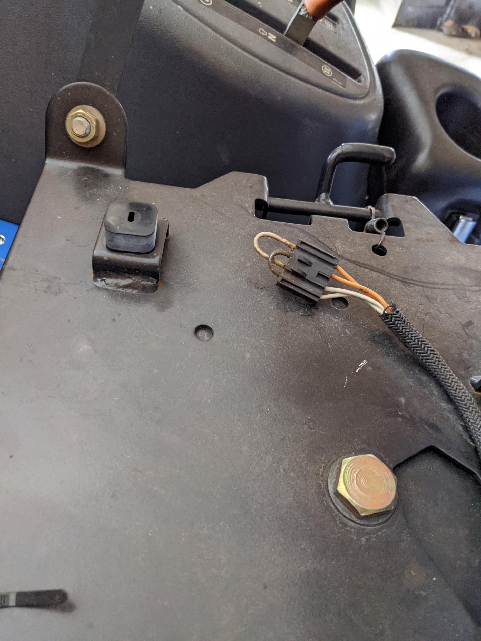

On my MF1540, there is an electrical connection under the seat frame (tilt the seat forward and the connection is visible/accessible).
just unplug the connection, and put a piece of wire connecting the two holes in the female plug together (so you are jumping the two sides of the female connector). Nothing is done with the male side.

If you look at that video, you will see the wires. Mine were right there. The plug is different (I replaced it with H11 plugs because that what I had). You dont need plugs, or even wires, if you want to make it permeant. Simply cut the wires coming from the tractor to the seat before the plug. Then use a butt connector to connect those two wires together. Thats the fast and dirty way.
A cleaner way is to unplug the connector, get a small length of wire, strip both ends, and attach the ends to the connector coming from the tractor.
Or do as I did. Make another two wire connection, and the part that plugs into the tractor, is looped. Same concepts. All the seat switch is, a closing a circuit. So, close it using a wire instead of a switch.

I did this to my NH 3040 about 10 years ago. I've had no problems with this setup. I'm sure yours is different.
