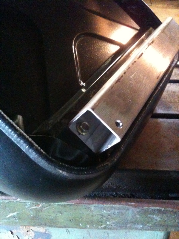

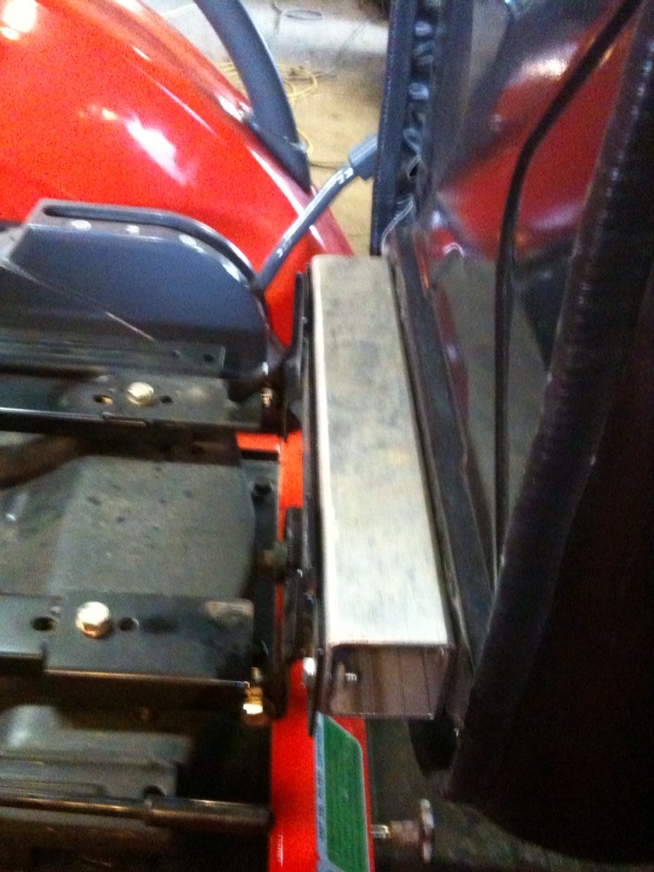

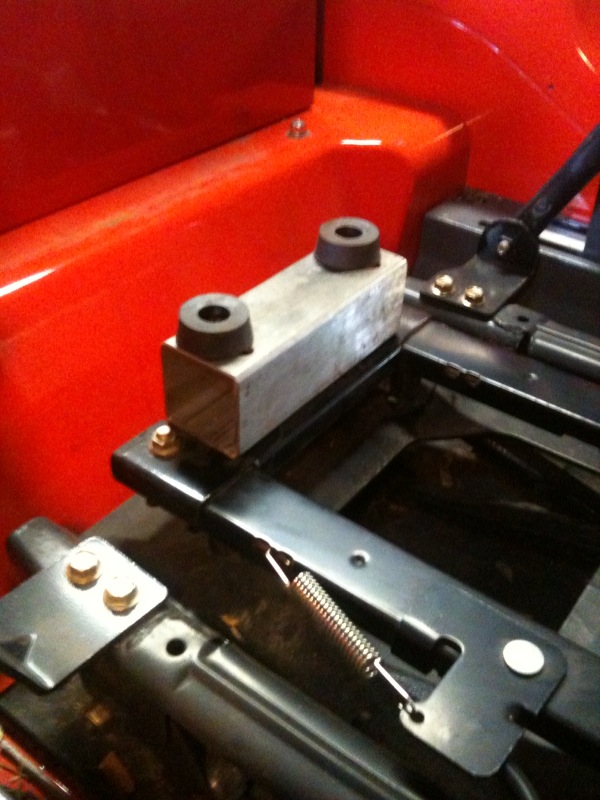

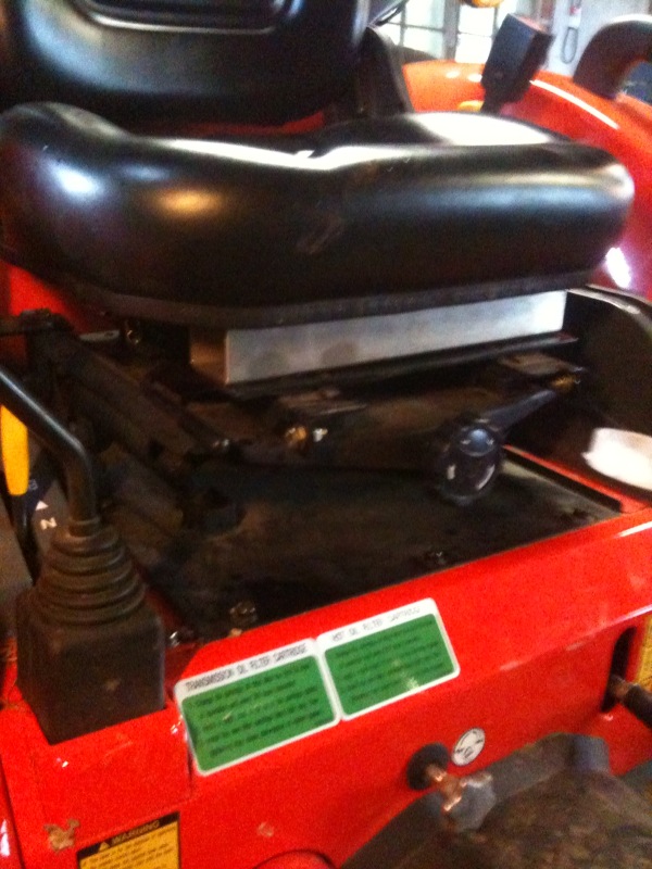

Well as it was still raining today and i was out in the shop changing the oil in my tractor I decided to add the risers under the seat. I just happened to have some 2" SQ ss tubing so I went up 2 and back 1" by offseting the holes. it seems better sitting on it will see when the rain stops.

Used the tractor today with the seat moved up 2 and back 1 .
I like it, feels different but i had alot more knee room. :thumbsup:

The pedal position is too far back for me also. It kills my knee if I am on the tractor very much. I like the idea of moving the seat up and back. I think I will make that mod also. I had been thinking of a leaning post similar to my center consul fishing boat (I know that would not be practical, just illustrates my frustration). Thanks for the pics they are very helpful.
