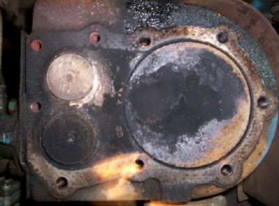

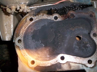

ok, i finally got the thing apart, and the head, piston, and valves look ok. no cracks or scratches. is there any specific order in which to install a new head gasket? or do i just slap the new one on there and bolt the head back on? how can i clean these things up without damaging?

Do you have a die grinder? They make some pads that look like non-metallic scouring pads to use on a die grinder. They work great for removing old gasket material, carbon, and even to de-glaze brake rotors.
   / sears super 12 #8
Use a torque wrench to make sure you don't over tighten the gasket and crush it so bad you end up causing it to fail again. Also as Bird said make sure you scrape off all mating surfaces.

no i did not buy it new. i do not have the manual. it is very old. sears did not have the gasket. how ever i did get it ordered through the local co-op. it will take abot 10 days. Do you by chance know what the head bolts torque on?
