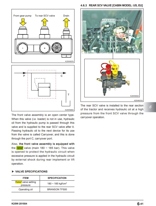

May 3, 2025 / SCV #1 T Tnbound New member Joined May 3, 2025 Messages 1 Tractor Branso 4820 Where is the SCV relief valve on a Branson 4820
May 3, 2025 / SCV #2 Tx Jim New Member Joined Jan 26, 2007 Messages 10,392 Location Coyote Flats,Tx Tractor JD 4255/Kubota M7040 HDC Welcome to this forum Normally selective control valve is on the RH side of the tractor seat & hyd breakaway couplers are mounted on the rear. Sounds as if you need an operators manual for a 4820.
May 3, 2025 / SCV #3 ptsg Super Member Joined Apr 3, 2013 Messages 7,724 Location Portugal Tractor Branson F36Rn - Agria 8900D It's on top of the remotes at the rear. I suggest getting a pressure gauge to check pressures before messing with any relief valves.
May 3, 2025 / SCV #4 T TractorTech Elite Member Joined Jan 26, 2012 Messages 3,114 Location California Tractor Ford 7710, Ford 550, Ford 1910, Ford 4430, KD Forklift, Ford LGT17H, New Holland L255 Skidsteer Welcome to TBN! Look at this page, is this what you are looking for? Attachments Branson 4820 relief.jpg 224.2 KB · Views: 75
