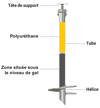

Hey,
They tend to look more like these
For the setup
While the post itself is something along the lines of this pieux_double_fr_v3.png
We are talking about tubes that are 2-3-4-5 inches in diameter with the screw blade being anywhere from 8 to 24inches and sometimes doubled.
They are usually screwed in about 7-10-16 feet deep.
Anything needing more support than that , or larger diameters, is usually a pounded post or w shaped post..

They are primarily used and screwed in, below the frost line with applications being patio decks, support beams, concrete footing reinforcements (prior to pour). Some shallow water docks (it's a case by case scenario due to ice dragging them out here ).
Being screwed in below the frost line, they tend to create a more stable foundation that isn't prone to frost heave. They do have some downsides and limitations but figure using them for a deck instead of a concrete pillars/columns or concrete slab, they will provide better load bearing capabilities at a cheaper price/faster installation.
However I would not suggest them for fences as they have little lateral force but good compressive strength.
Even bigger ones are sometimes used and screwed in at an angle to support poles. Essentially like a guy anchor.
They are also relatively good as they can be screwed back in or have an extension welded on while a concrete post cannot be altered as easily..
