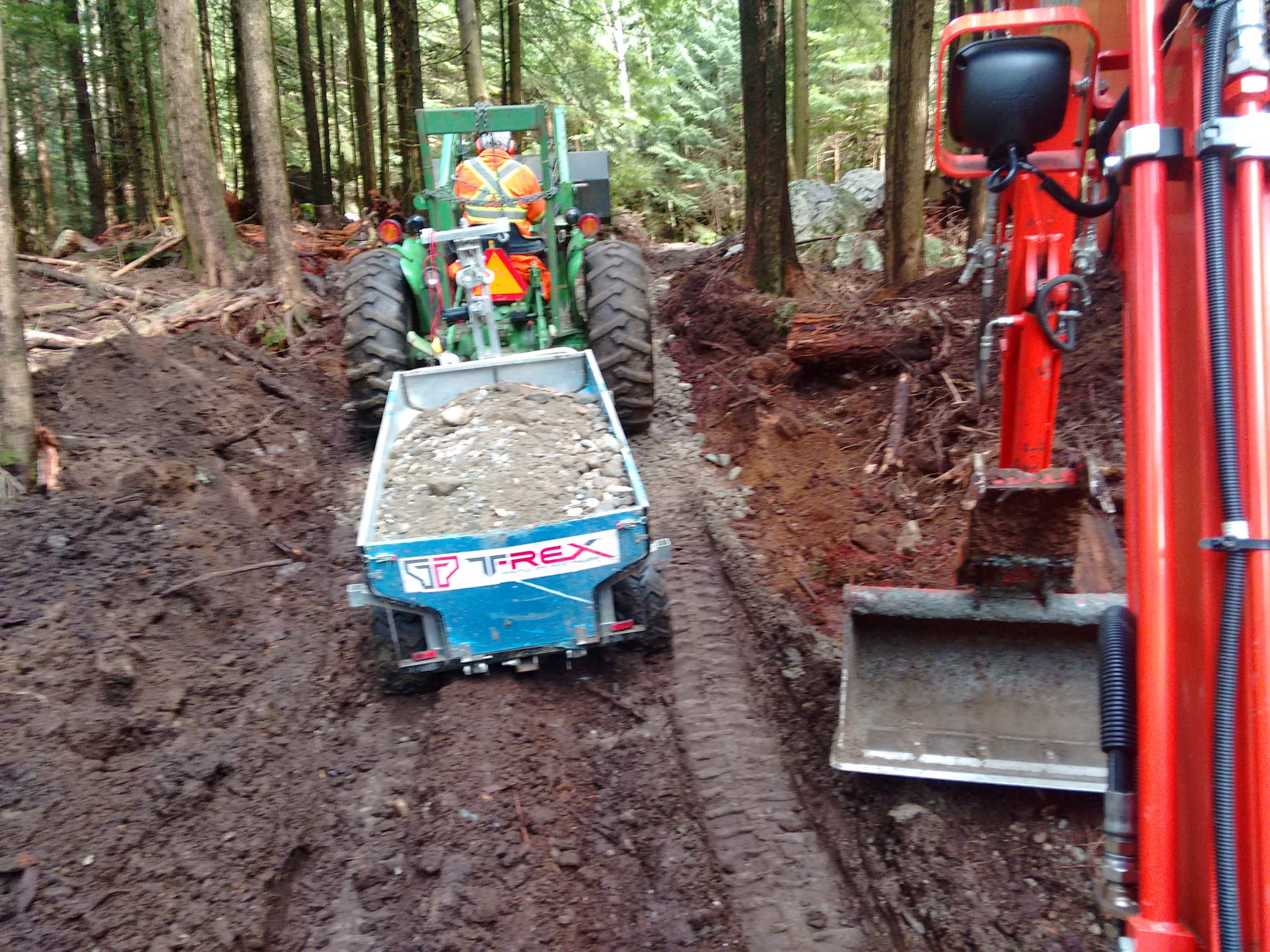

So here is a simple idea that a few of you may be able to use. It worked well for me over a 2 week period and got the job completed. The star of this video is the excavator but my Kioti DK45 SE and a JD 2150 are co-stars.
The basic principle is the same no matter which machines are used so I thought to share my experience. Have a look - https://www.youtube.com/watch?v=27yEmQ8n2Ow

So where is the Grizzly?
   / Screening with a grizzly on a bucket
It is the screen on the bucket.
   / Screening with a grizzly on a bucket #4
Is the grizzly hinged on the bucket? Nice! Was thinking that one of those tractors hauling a dump trailer sure would be nice.
Yes, a dump trailer works great as long as you have a place to turn around. Here is a photo of the JD 2150 with a dump trailer, taken just across the creek earlier this spring on the same job.
The grizzly is hinged, sort of. It hangs by 2 short chains. I plan to make a better hinge system but this is working ok for now. Tractor_Dump_Trailer.jpg
