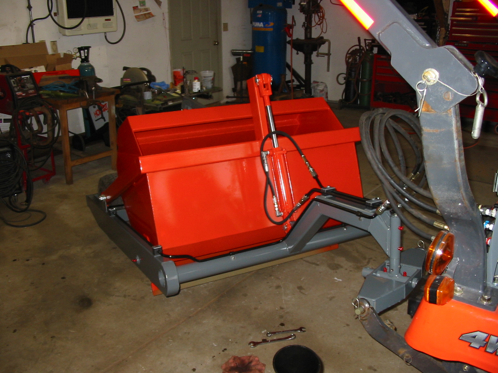

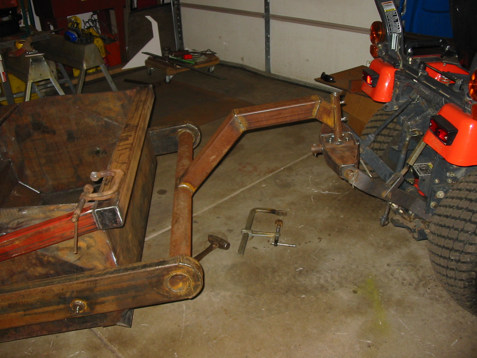

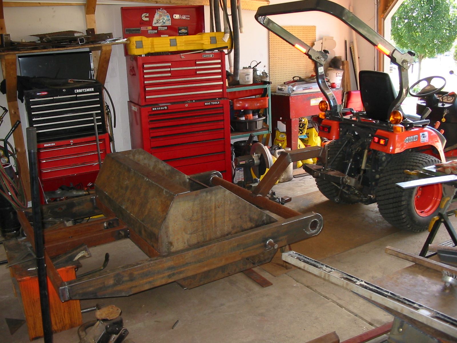

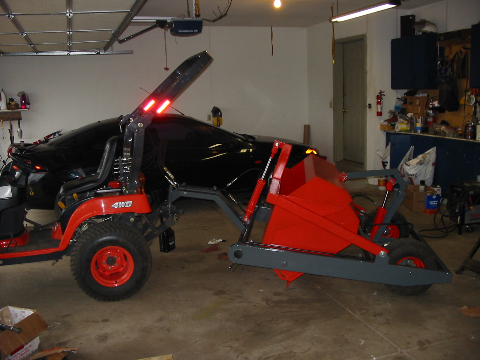

What do you guys think of my scraper pan I've just completed building. It took me about a month and half to build. Here are some finished and some build pictures

Well I just tried it out for the first time today and it works great. It will move alot of dirt pretty fast. It grades,dumps and spreads very nice. I'll get some action picture this weekend.

Did you build it from plans, pictures, or just out of your head? Sure looks nice with all that fancy paint! I am glad you included the pre-paint pictures also, as that is how most of my stuff looks!

the pan looks great.
make shure to post a vid of your new pan stopping that riding lawnmower dead in its tracks. ;)
(seriously, unless your scraping up sand off of pavement, i dont see how in the world your gonna manage enough HP and traction to make it work. my data points, common setup around hear, quadtrack 450hp case with dual 10' cut pans, =22hp/foot of cut)
/ Scraper pan #16
The big boys are closer to 45 hp/foot of cut since they don't fill both scrapers at the same time. With tandems, they fill the front pan first, pick it up, and then fill the second. The tongue weight of that first pan pins the rear tires to the ground, very little slippage.
That said, they're also filling 18 yard pans in just about any soil type. That last couple yards when it's heaped up in the pan is what usually drags the tractor to it's knees.
A lot has to do with blade angle, depth of cut, etc. As long as you're not too aggressive with the cut depth, you shouldn't be much worse than digging with the loader bucket. Probably better since tractors are designed to pull more so than push.
Very nice work ... Couple of questions
- How wide is hopper?
- How much to you reckin it holds?
- What did you do to prep the steel before you painted it?
- Do you really need the apron?
- Does the apron help more on making a smooth "discharge" of the dirt?
- Given the fantastic job you did, was it just easier to make the apron lift with the single cylinder lift vs doing it like this one?(similiar to how you did the rear) Hoelscher Commercial Products - DB Scraper
This was going to be my winter project. You have set the bar pretty high!
