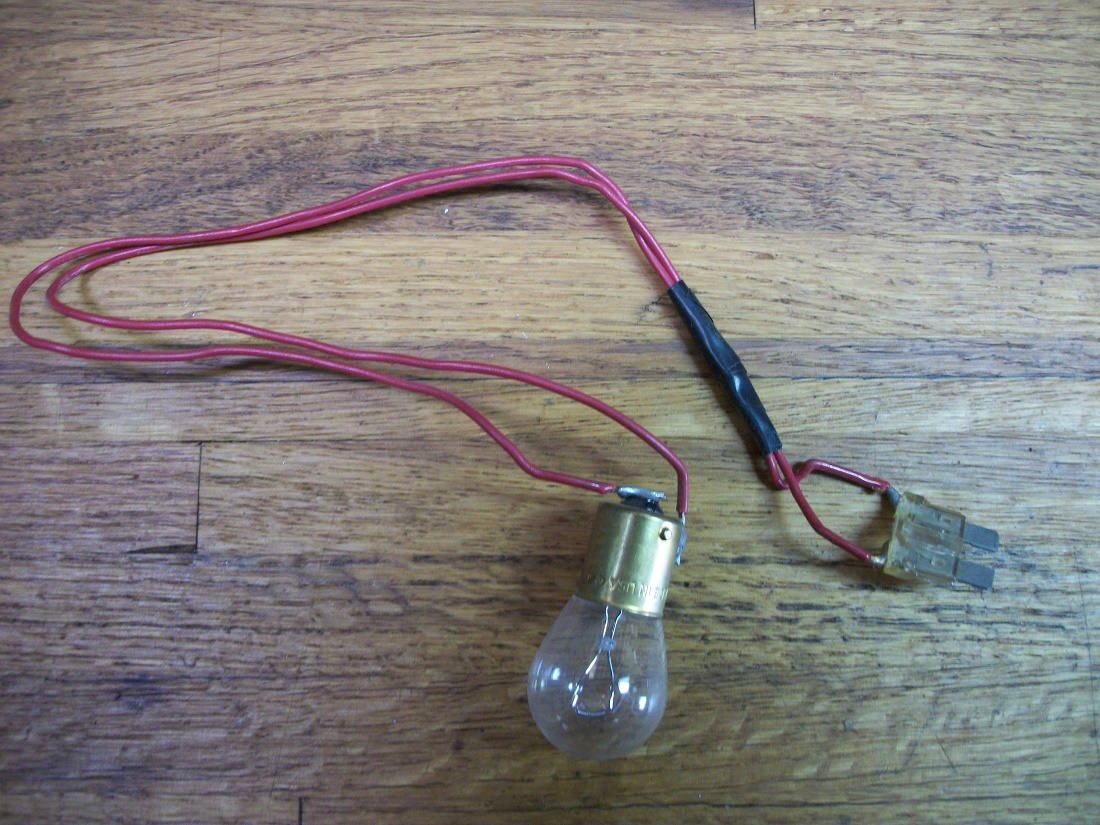

Do you have a reference anywhere for what this might look like or how to connect? I believe i have everything needed top make it.
   / Scotts S2554 by John Deere Blowing Fuse on Start #8
Yes on # 1. On number two any 12V bulb and socket you have laying around and two wires with some spade ends are perfect. They can be a bulb with two wires taped on if done carefully enough or a circuit tester light.
   / Scotts S2554 by John Deere Blowing Fuse on Start #9
A pic of one of mine...
Solder wires to a blown fuse..
