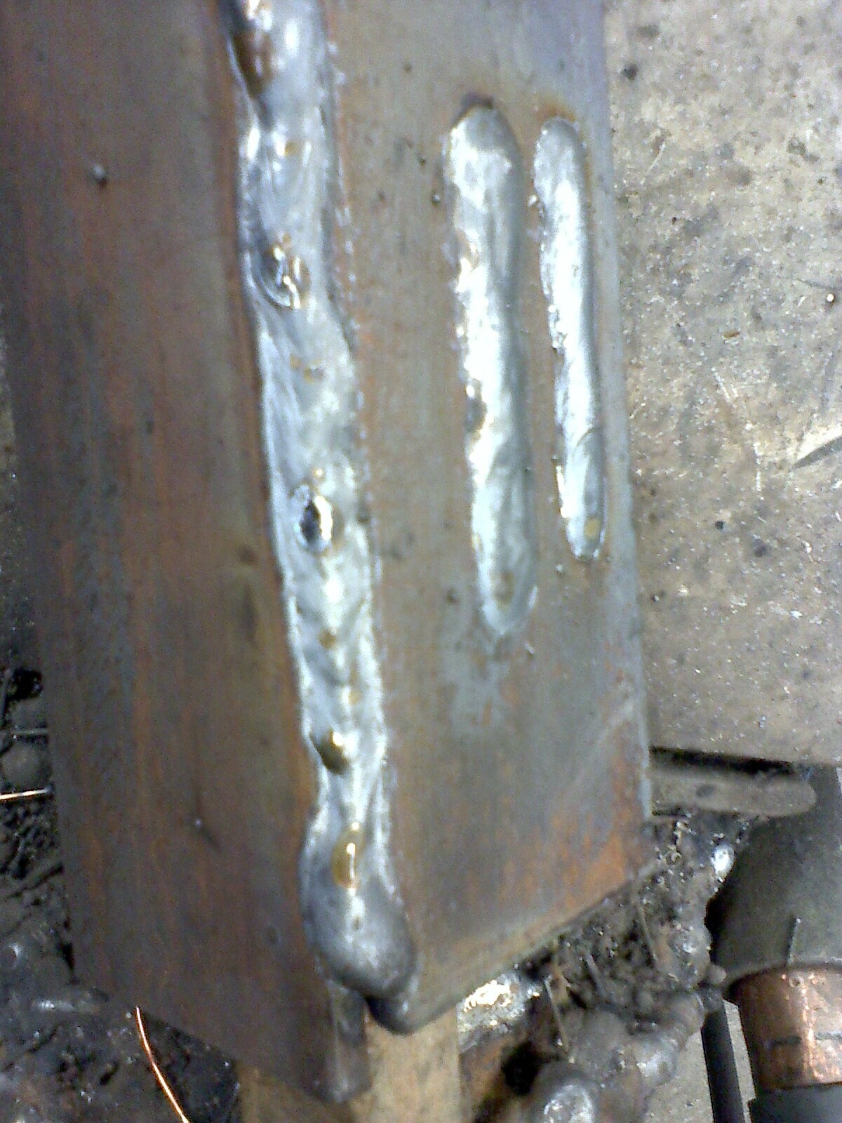

Long story, but where I work, we have two old school guys that are set in their ways and dont like change:confused2:
Our welder in the shop is a miller 350P, with pulse mig capability. I understand the benefits and when/why it is better, but they do not. And I am having a hard time explaining it to them.
They are the type of welders who use the short circuit process in combination with a nice weave pattern to give that "row of nickels" look.
That is fine. I use that method for a lot of things too. And sometimes I dont do the weave pattern. It just depends. But these guys think that a weld that lacks that "row of nickels" look isnt a good weld. Wether by short circuit or pulse.
I was messing around with some 1/4" scrap peices today and had the machine set to pulse with a wire feed of 400 and a arc length of 50 (0-99 range) and made some really good looking welds IMO. But they insist that they dont look good:mad:
I have tried to explain how the penetration is better, spatter is less, and can weld faster, all to no avail. Maybe it is hopeless and I should just stop trying to convince them. But I like pulse welding. I dont like them thinking my welds are inferior though:confused2:
Here is a pic of some pulse welds on 1/4" with settings mentioned above. And this is by no means my best welding. This is just screwing around with some scraps in the shop:thumbsup:

What about some samples side by side and cut out some cross sections? Maybe a visual would help?

Being a welder and having delt with many over the years I would say you are waisting your time with talk. Weld some samples together, identical but with different methods. Take them to the press and load them to destruction. One of two things happens at this point, they see how your process is better or you see that the way they are comfortable is just fine.
If you really want to get an "old" welder out of their comfort zone get them to try spray arc welding.

It is actually recomended for materials over 1/8" thick.
The short-circuit is the only thing recomended for thin stuff.
Pulse is actually very similar to spray. But spray is 1/4"+. By having a pulse machine, allows the same characteristics of a spray, but down as thin as 1/8", as well as being easier to set-up and weld with vs spray. Spray, you need everything set JUST right. Pulse isnt as finikey.
Advantages of pulse are: more penetration, less spatter, more uniform weld.
BUT, it is not good for out-of-position welding, filling any kind of gaps/poor fitment, or really thin stuff.
And you can pulse with 75/25 gas, allthough 90/10 is better.
At least all this is MY understanding of it. Just googleing, one can read for Hours on the differences between short-circuit, pulse, spray and pulsed spray; and all the advantages and disadvantages of them.

Welp, start breaking things, (or try to). Do some "DT" testing, and post the results here so we can all see.;)

Big hammer works for me! Make sure you get some good close up pictures of the penetration, after the weld is broke. ;)
