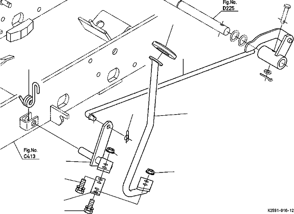

I seem to have broken some linkage (I'm hoping that's all) for my differential lock pedal on my BX24. The pedal just freely travels up and down now without actually locking the differential. So, I'm assuming some part of the linkage broke off, or perhaps I just lost a cotter pin.
Didn't someone post schematic drawings of many Kubota tractors somewhere before? If so, anyone have a link to them?
Thank you
   / Schematic drawings for BX24 and diff-lock linkage? #2
Is this what you want?
Cary:cool:
