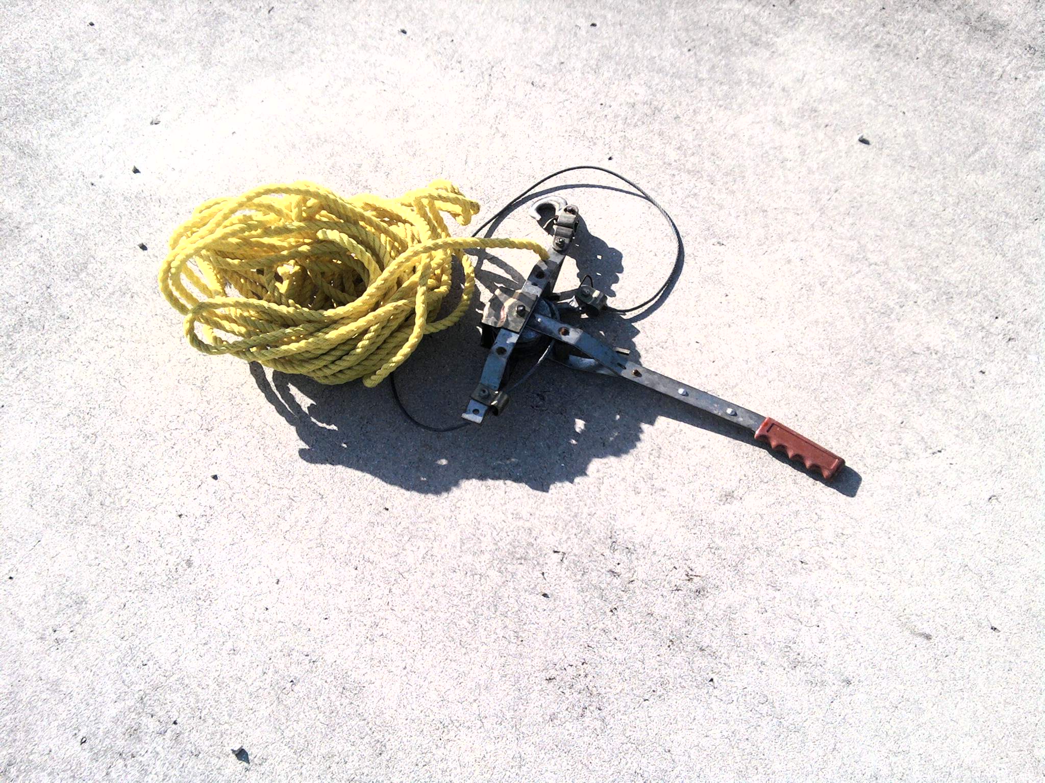

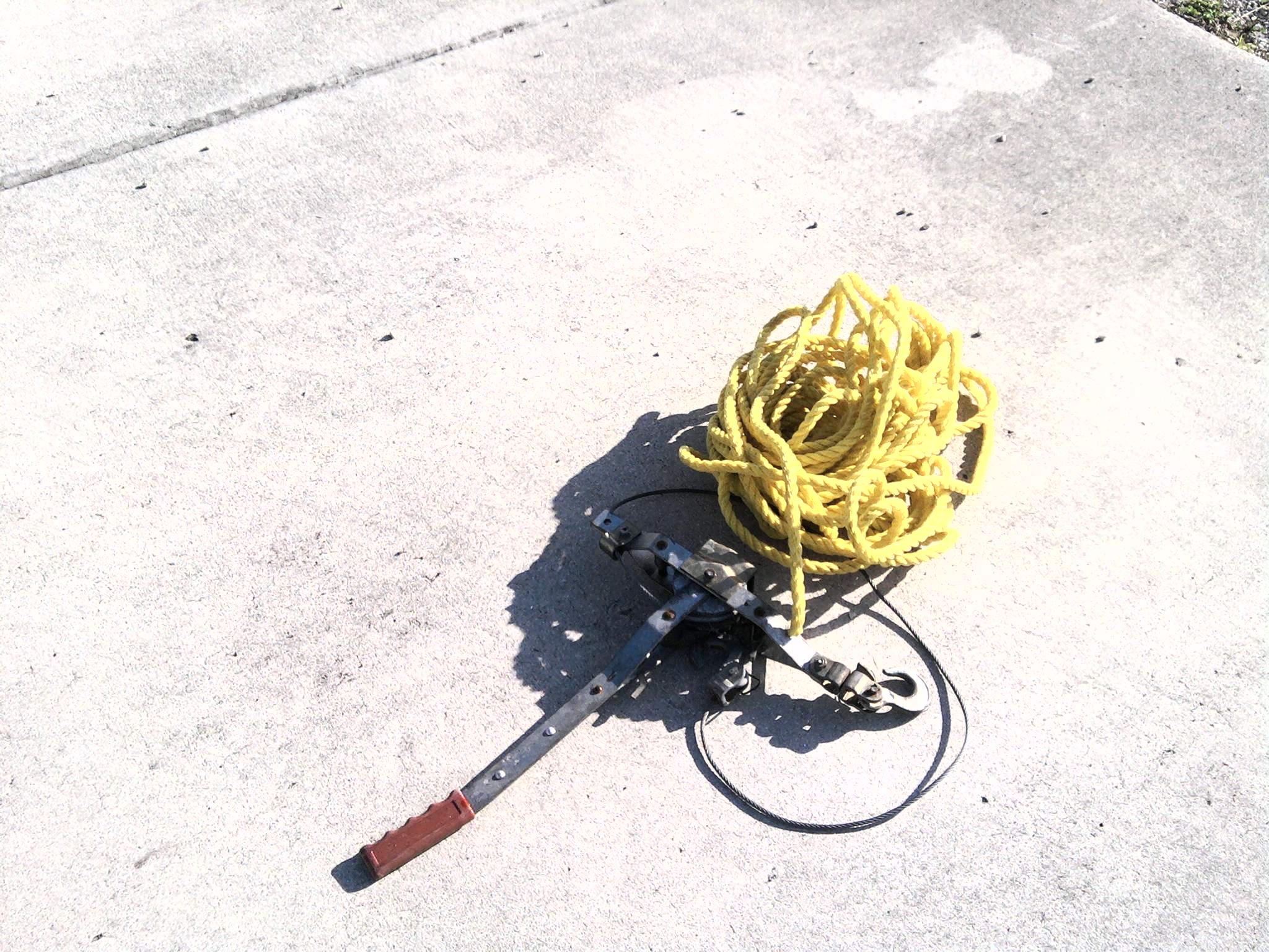

Don't load many atv' or riding mowers on back of my truck,but when I do I put -em in neutral(freewheel-em).Then hook-em up with rope and come-along.Takes longer too load but real safe method.Even when you ride them up(make sure weight capa. ok)it will keep front end down,sometimes takes two people to load.
