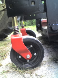

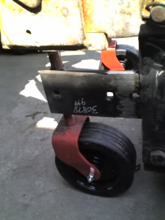

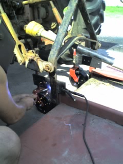

I have the wheels mounted. I hope the gauge isnt too little. The welder who didnt know soo much, said it looked fine to him and suggested valve springs for suspension. Here are some pictures of installation. Took about 1.5 hrs to get alignments, heights and welds done at cost of 40.00 welding time. ( total project about 200.00
It may turn out to be junk, but figured i would try. It actually looks really good and feels sturdy. I will be testing it when it cools off around 6 this evening and post results. I can tow it in the wheels and a test patch looked promising ( just a couple strips and few turns)
I had no idea that you were going to mount them so far inboard. I wish you luck. The downward force on turns is going to be even higher than if they were mounted outboard. All that outboard weight is going to impose big time leverage on whichever caster is inside on a sharp turn. Sorta like trying to turn a tricycle type tractor while paralleling a hillside at speed.

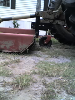

OK... progress report.. I tried different springs for suspension. My thinking is that if its suspended by heavy spring then there would be less shock to the system. I had some BBC Roller cam valvle spring that worked perfectly. The deck floats on the springs with approx 1/2 of suspension travel. I at 230lbs can bounce on it and bottom out the corner, my wife at 105lbs can not.
Driving around the yard mowing the wheels swivel very well and track the back end of tractor. I am thinking as long as they swivel freely, then chance of one getting sideways and folding under is reduced. I can drop deck to bottom and rest on wheels and spin tractor and the corners are not digging in now! YEAH!! I was very please with the consistancy of grass height and how it pulls , turns and cuts.
This may not have been the best solution to my problem, but for right now its working very well. I will keep it greased up so swivels easily because if it were to fold a wheel, i think it would be because it got caught sideways. I put just a touch of caster in it to help it track back straight.
Right now.. I have 2 thumbs way up for it, but ofcourse needs to see how it holds up over time.
Greg, thank you for your tips on setting it the hitch and swaying, hopefully by adjusting everything as best i can, it will hold up.
see enclosed photos for suspension and height... I have the deck level right now cutting very close about 2-2.5 inches height now. You can see the sides of my mower that have been pushed in over years of it digging into turf.

Just finished all 12 acres and around my house without a divot to be had. With the sharp blades its mowing very well.
I couldn't be happier with the result. I let the hydraulic lift all the way down and mowed everything just riding on the wheels. With no hydraulic lift, it rides easily on the suspension.
When I was done, I lifted it up and checked everything and it feels very solid. I don't think there will be any problems, but time will tell.
I have from set it pretty level and is mowing the grass at 2.5 inches and can be adjusted with shims. As long as it holds up, it will be an advantage over finish mower in cost savings ( not having to buy finish mower, or switch back and forth attachments) and speed that i can cut grass. With 70 hp and direct drive, i crank up rpms and was mowing pasture in 5th gear ( 6th is just for driving on roads) Without having to worry about divots, ride height and scalping, I mowed the 12 acres in record time for me !! My gut says it will hold up, the suspension looked like it was doing a good job smoothing out the bumps, however, if it were to fold a wheel, i really feel like I am in right direction and will just install heavier forks and larger front wheels.
I will post again after using it a few months and let anyone considering doing the same thing my results over extended usage.
