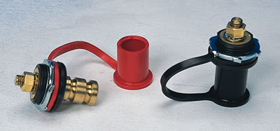

Anybody have any suggestions for what to use on the end of the wires to make a good terminal? I thought if I could find two pieces of copper tubing about 1/4" or so in diameter and clamp wire to it.

If you really want terminals, attached is a picure of the neatest terminal lugs you'll find. They're a Summit Racing product; click here and enter <font color="red"> SUM-G1430 </font> in the search box that says "Enter Summit Part #". Not cheap, though, $19.99/pair plus freight plus Summit's stupid handling fee.
I agree with Soundguy, though, you'd be better off to use a battery. Rather than keeping the battery hooked to the charger all the time, though, just charge it back up when you need to. Or, pick up an automatic trickle charger for the battery -- Walmart has one for under $20.
Of course, by the time you buy a battery, you'll have spent most of the savings over the 110v pump... /forums/images/graemlins/crazy.gif
