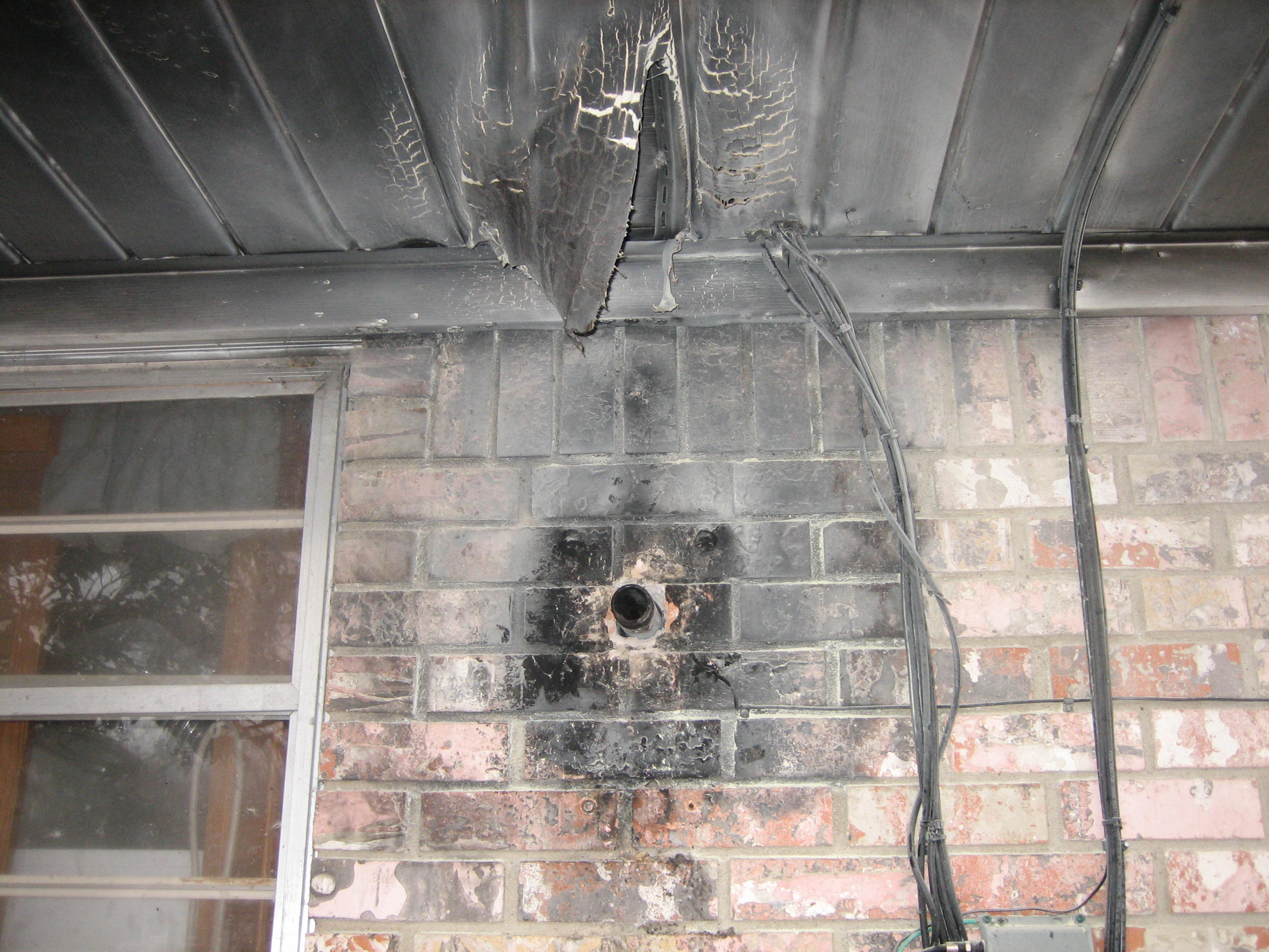

Meter box shorted out on one of my rental properties this past Christmas Eve. Insurance paid all but deductible for replacement and paid to replace the Federal-Pacific 100amp breaker box that was inside to a 200amp outside installation.
Fire melted the retaining ring holding the meter in allowing it to fall out, shutting down the fireworks just before causing a major fire.
It was a brand new remote-read meter that had been installed a month prior. First time the electric company, electric contractor, or the insurance adjuster had ever seen it happen.
Wow! I have NEVER EVER seen a meter box fail that bad nor heard of it until now! It looks like it developed a high resistance fault that allowed a continuous arc to occur and turned it into a miniature electric furnace. Of course, any insulation material inside the box plus the meter itself would have been vaporized and added to the fire. Darn scarey and darn lucky it wasn't worse.
