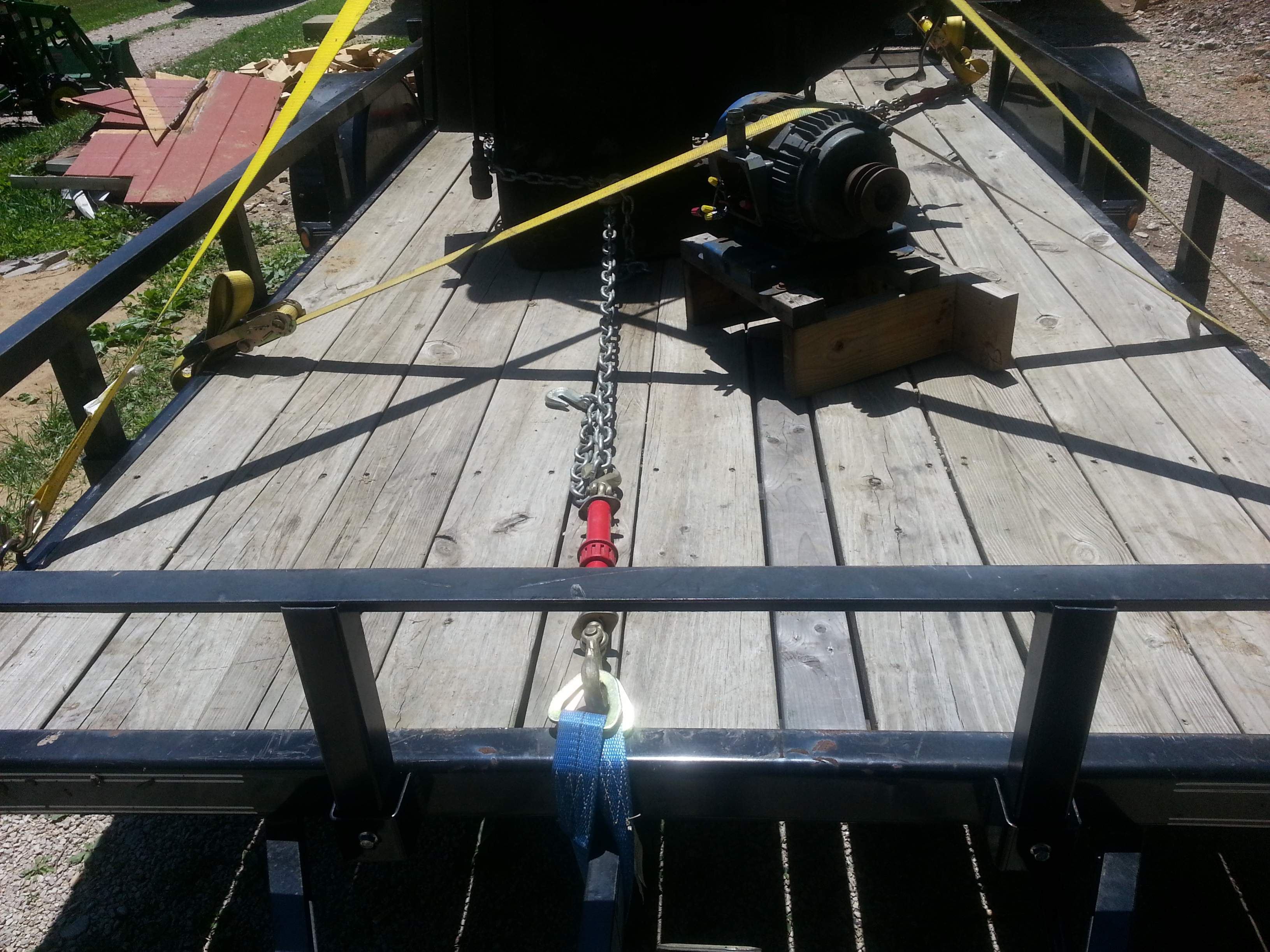

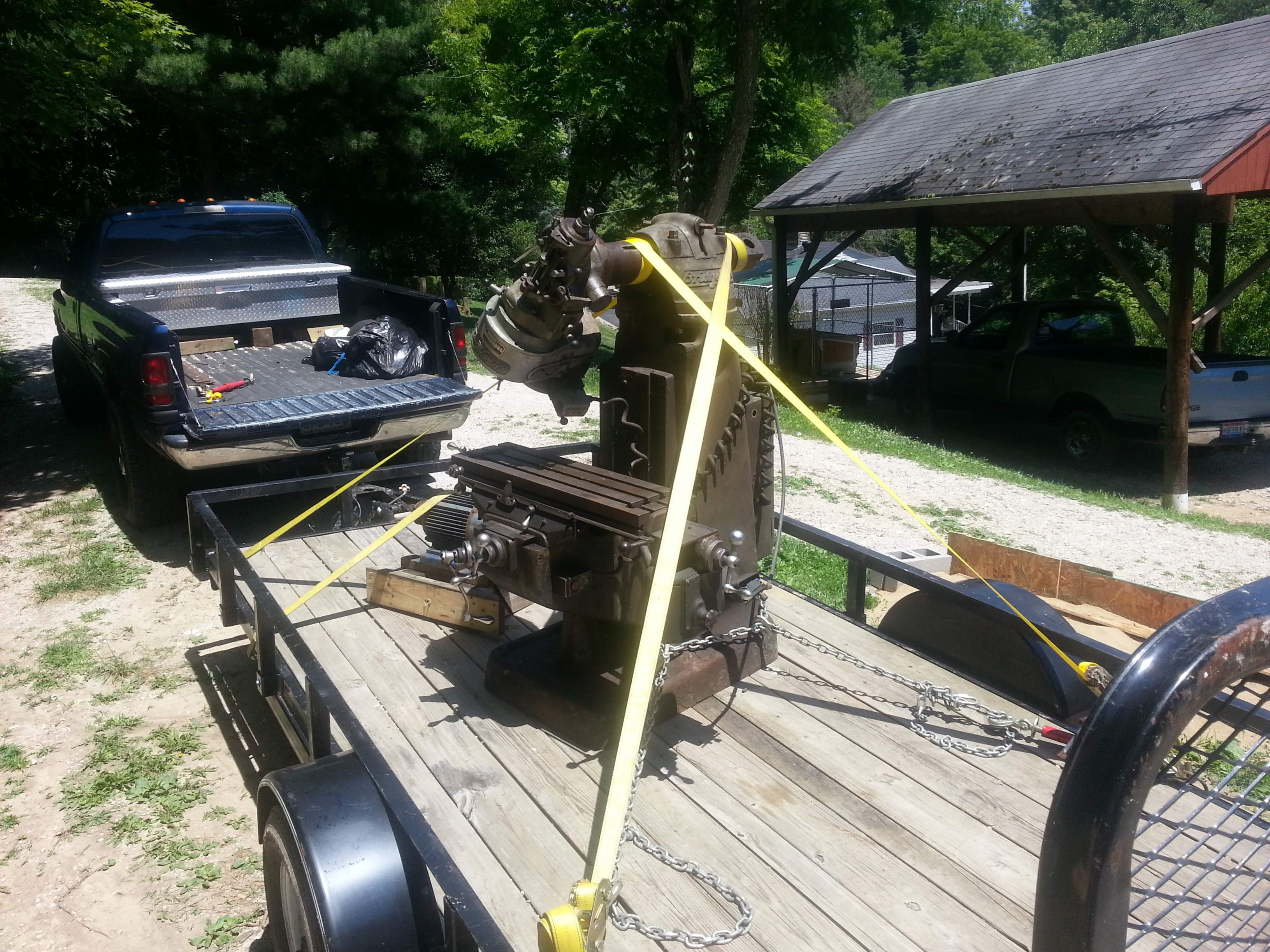

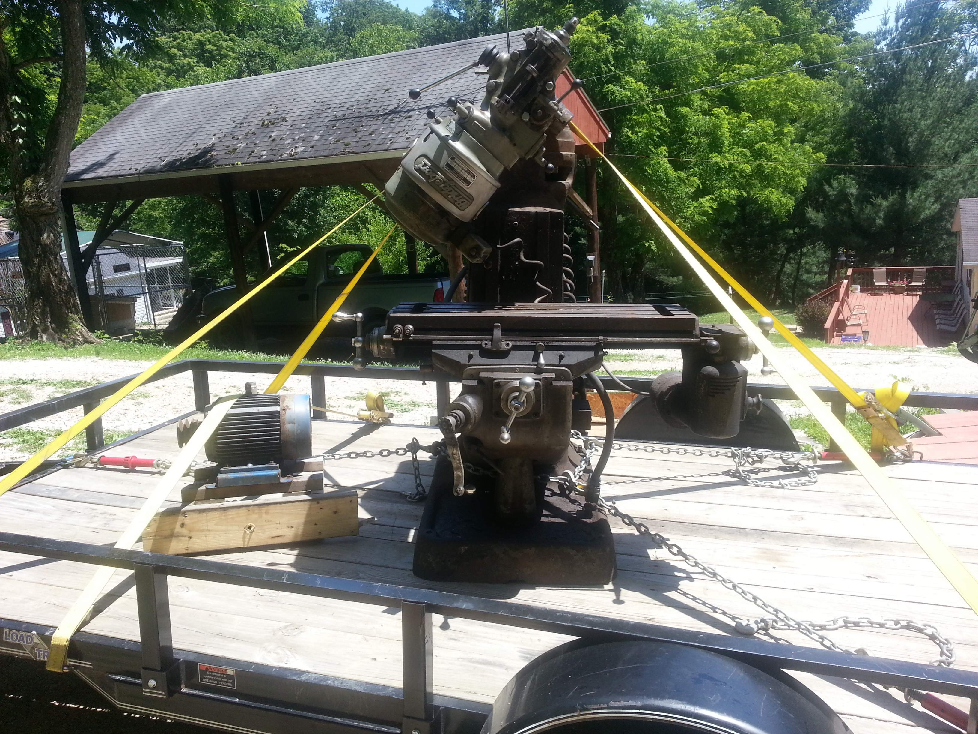

Another idea I had was to build a heavy duty pallet out of 2x4's and 8 lawnmower wheels. I would remove the gate and strap the pallet to the back of the trailer so it couldn't roll. Then I would use the tractor to slide the mill off the back. When it got near its tipping point on the edge of the trailer i would hook my pallet fork frame to the machine and strap it to securely, then carefully finish pulling it onto the pallet (about 2" drop)
Along the same lines, cut some 2x6 on angle and screw together then a piece of plywood on top - essentially make a nearly solid ramp off the back of the trailer level with the deck when tilted. Then pull it off slowly onto the ramp - you could put some 1" pipes under the ramp too to roll into position.

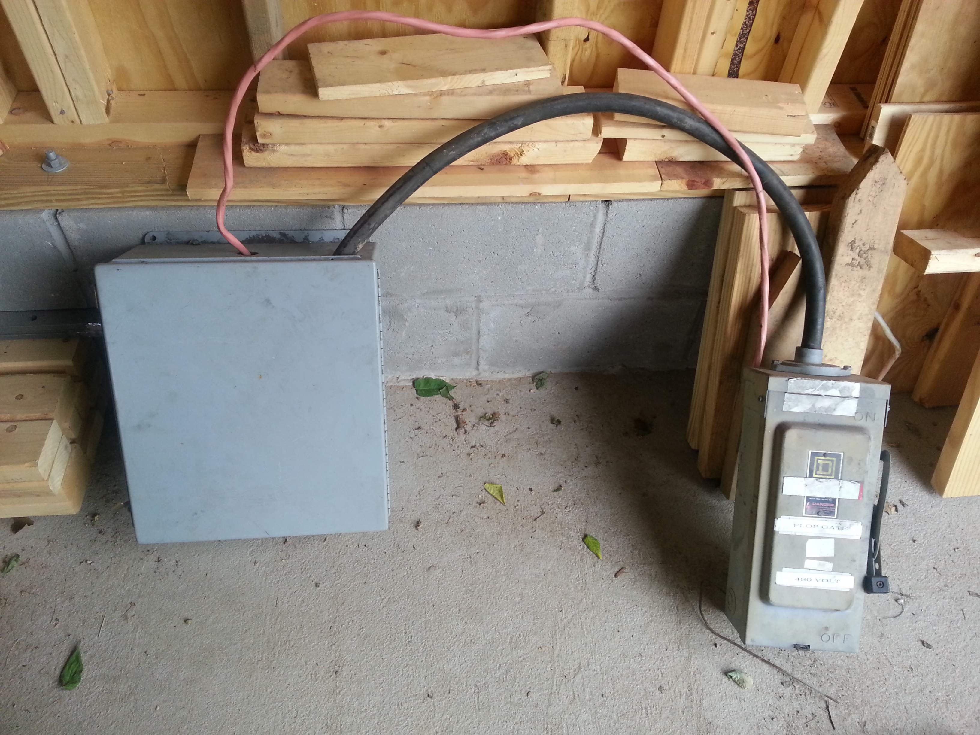

I bought a similar drill press. Turned out to be a bridgeport CNC mill. Works nice, I used a 240 volt vfd to convert 1 phase to 3 phase. $100.

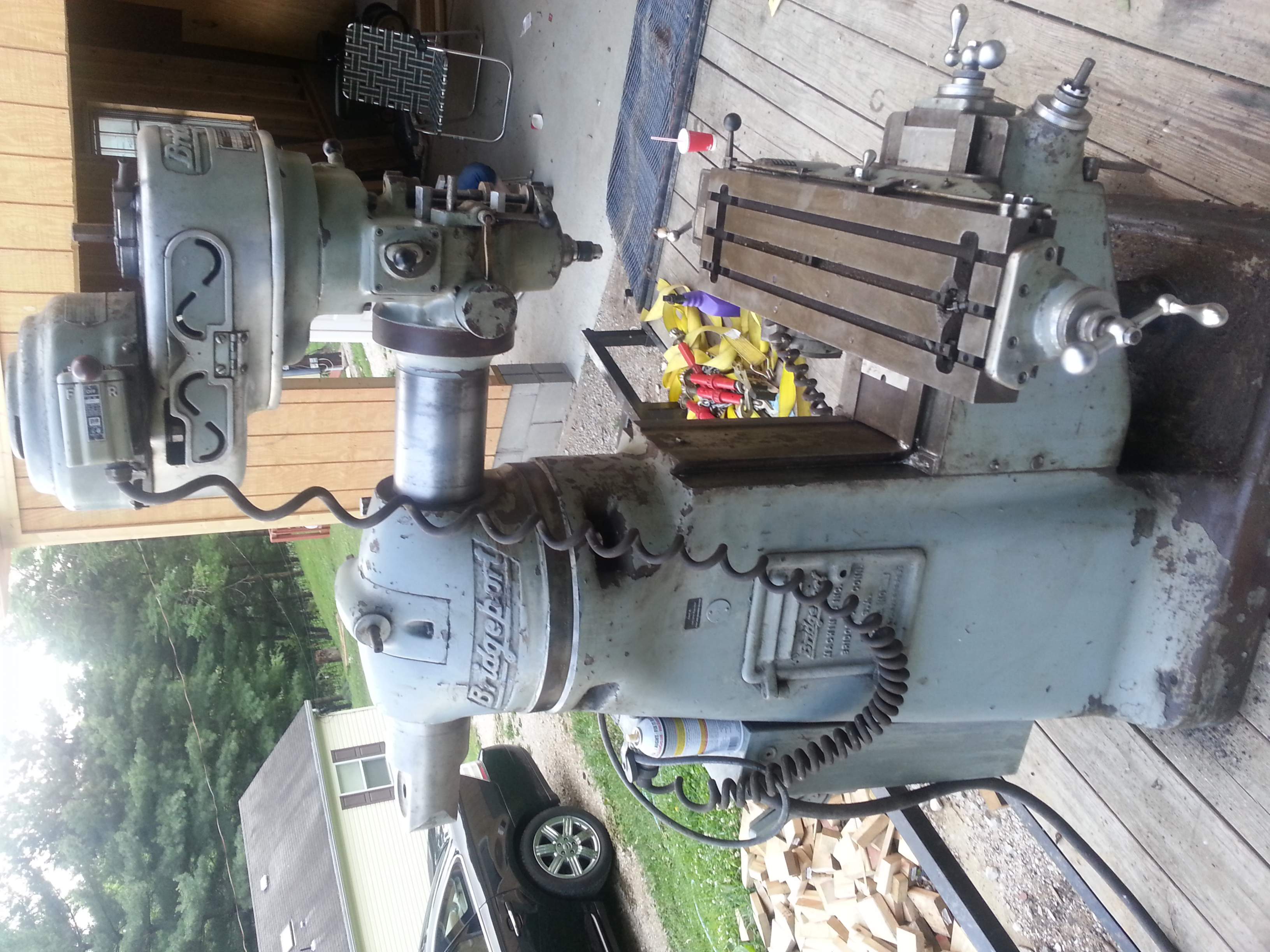

The base is hollow, so weighs less than appearance. I bolted mine to a custom 3/4 plywood pallet and moved it in the bed of my F250. Rode super smooth, no problems at all. To unload I used my Kubota M6800 with FEL. There is a threaded hole in the top of the ram for an Eye bolt. Move the ram forward or back until the machine lifts level. Keep it very close to ground and move slow to minimize potential damage from a fall. Easy. After it was driven into the shop I rolled it on pieces of 1" pipe. Again, easy. A tool can be made to lift it with a piece of 2" round stock, a piece of 1/2" flat, and a rod that 1" pipe slips over. It fits into the square notches along each side and lets you pry it off the floor. Ill try to remember to photograph it next shop visit. You can also use this pry tool to level the machine exactly.

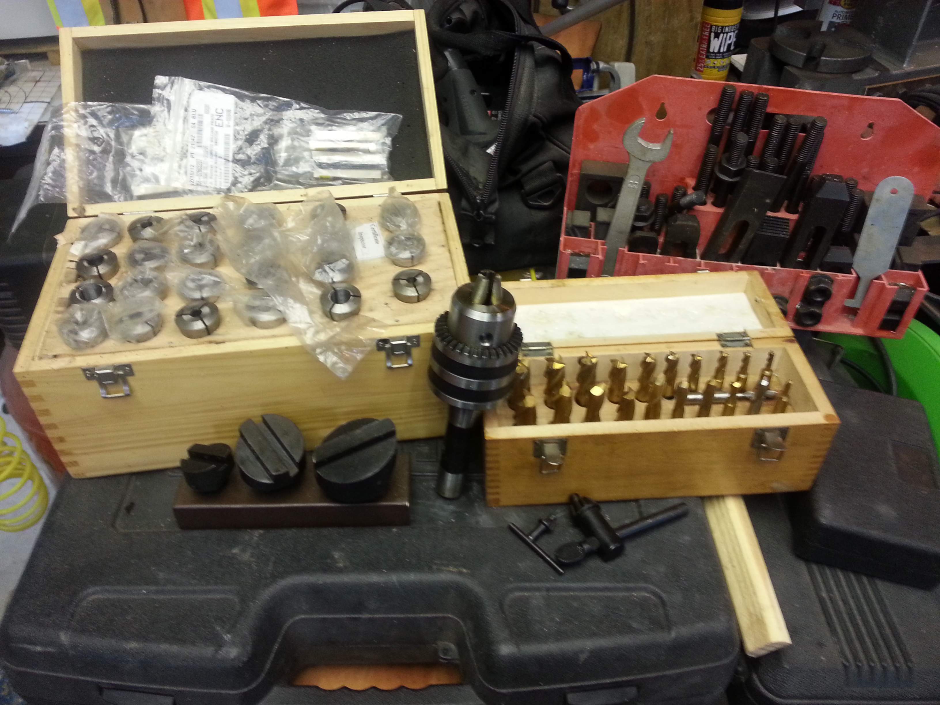

Bad news! It doesnt fit in the space i set aside for it! I cleaned it up and checked it out. If anybody wants it i'm asking $1200 for the mill, phase converter, collets, clamps, end mills, drill chucks, and fly cutters. 20140612_194716.jpg

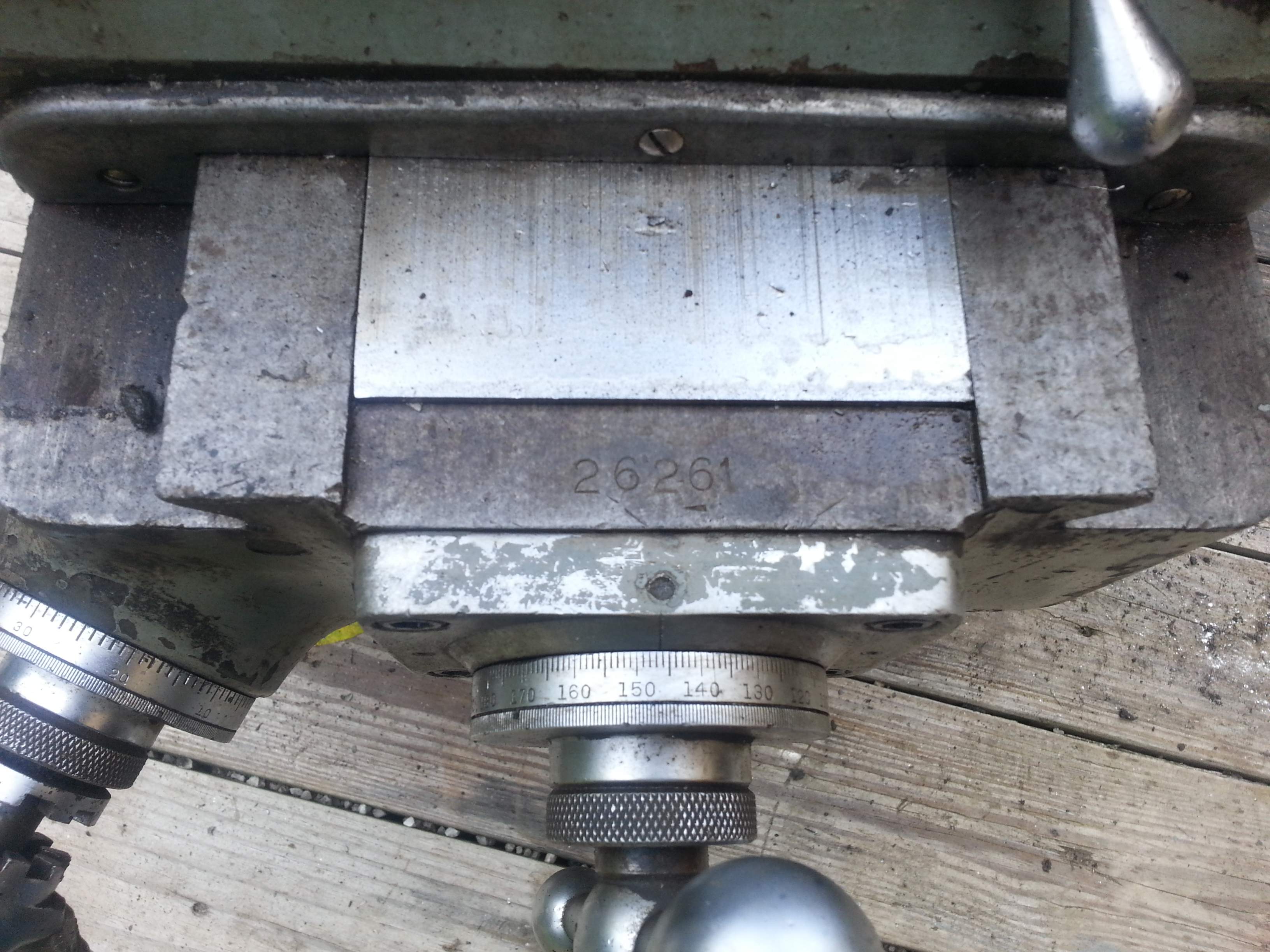

The axes aren't bad and the table slop is average. I ran it at the guys house and the spindle is tight.

I moved it by hanging it from the ceiling and backing the trailers under it. The beam was designed for a 3000lb distributed load and I hung a 2200lb point load 1/3 of the way from the end. Talk about having faith in your math! The plasma is fun to run but it can't replace the mill.
