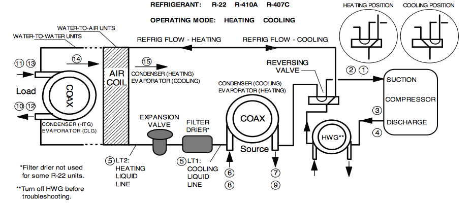

If you don't understand how the heat works, you probably don't understand correctly how the cooling works.
Its not as simple as circulating ground water through it and using that cool water to cool the house, if that's what you were thinking.
There is refrigerant just the same as an air to air heat pump, or your fridge and freezer.
Operates off the same principal.
But rather than use a variable outdoor air temp for the medium to heat/cool the refrigerant.....it uses ground water.
So basically....when heating.....your compressor compresses freon.....which makes it get hot.....let's say 150 degrees but it started out at 50. So it gained 100 degrees by compressing it.
Now we circulate that through the furnace and blow air over it, this air is warmed and heats your house. Cooks the freon down to say 100 degrees. But remember it's still compressed.
So when we uncompress we have to loose that 100 degrees. So now the freon in zero.
Up to this point, a convention air to air, and Geo are the same.
On a Geo, from this point, we use 50 degree ground water to warm the freon back up to 50, and start all over. This cools the water... Which circulates back through thousands of feet of pipe in the ground, to warm it back up.
On an air to air....that 0 degree freon circulates through the outdoor unit, and blows outside air across it to warm that zero degree freon back to whatever the outside temp is. Which is why the colder it is outside, the less efficient an air to air is. Where as Geo efficiency remains as constant as the ground temp is at the 6' depth the loops are burried.
Air conditioning is just the opposite. Compressor still compresses and heats freon. But is either cooled by the outside air on an air to air, or cooled by the ground water first. Then when uncompressed and super cooled, it's circulated through the heat exchanger that the fan blows across, blowing cold air out your vents
There are a couple key aspects to add -- first is that a reversing valve is used to change the direction of the system between heating and cooling cycles. The reversing valve is an important feature. Here's a schematic of my geo system that shows the whole concept pretty well:
Note that the direction of flow from the compressor differs in heating and cooling mode. The other key component is the expansion valve, which cools off the refrigerant (compression heats it, expansion cools it).
In the abstract, the way to think about both the heating cooling cycles is that the refrigerant and machinery is a way to transport thermal energy (aka "heat") from one place (inside the house) to the other place (ground loop). In heating mode, we are actually removing "cold" heat energy from inside the home and rejecting it to the ground loop. So you actually end up cooling the ground loop when the system is in heat mode. In cooling mode, we are removing "warm" heat energy from the home and rejecting it to the ground loop. So you warm the ground loop in cooling mode.

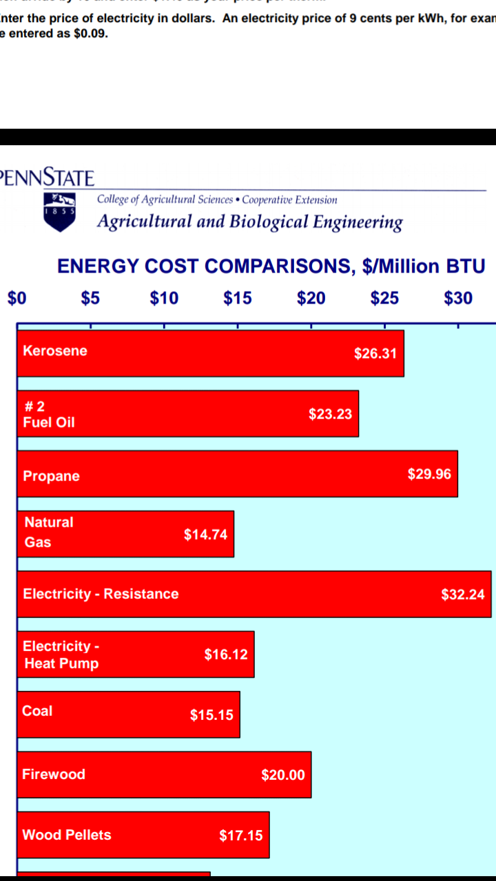

I don't know where they got that chart but it doesn't accurately reflect local prices.
Just pulling some google numbers I get $10 per million BTUs in pellets ( $3.20 a bag on rural kings website and claimed 8,250 btus a pound). I got firewood to be $6.50 a million btus. ( $150 a cord, 24 million btus a cord ) Diesel is about $14 dollars a million btus assuming $2 a gallon. locally kerosene is priced uneconomical for heating. Fuel oil is a non existent fuel source. Propane is used only when natural gas isn't available. Electric is 12 cents a KWH. I doubt the pellets are nearly that high of btus as that's only 300 pounds of pellets to equal a cord of wood
/ Save $$$ - Heat with Wood #174
Just pulling some google numbers I get $10 per million BTUs in pellets ( $3.20 a bag on rural kings website and claimed 8,250 btus a pound). I got firewood to be $6.50 a million btus. ( $150 a cord, 24 million btus a cord ) locally kerosene is priced uneconomical for heating. Fuel oil is a non existent fuel source. Propane is used only when natural gas isn't available. Electric is 12 cents a KWH. I doubt the pellets are nearly that high of btus as that's only 300 pounds of pellets to equal a cord of wood
Missing a zero there.
3000 x 8250 = 24.75 million BTU
forgetting efficiency with the firewood too.
Sure, some modern stoves may be more efficient, air-tight catalytic burn, etc.
But most run of the mill wood stoves are 50%.
So 24M btu's in a cord/.....only 12 million goes into the house as heat (the rest up the chimney).
So $150/cord / 12 = $12.50 per million.
They are figuring pellets at 80% efficient burn. Dont know the cost of pellets, I'll trust their ~$17 per million BTU's is correct.
Their heat pump factor being only twice as efficient as electric resistance is low I think.
Most modern 2-stage (or variable) air to air units are 3:1. And a 2-stage geo closer to 4:1
So by their chart and $0.11/kwh (which is pretty close to what I pay), My geo is in the ballpark of $8/million BTU. Compared to firewood at ~$12. Which seems to fall inline with my real world experience heating the house for two years with wood, and now on my second year with the geo

I knew I left out efficiency of the firewood. I don't know if it was already factored in either. I also left out the fact that there's no local Rural King and you'll have to pay tax and likely shipping on your pallet of pellets. I don't know how you'd go about making a chart with any degree of accuracy. Especially if you post it on the internet because that blows any chance of it because of local cost.

I knew I left out efficiency of the firewood. I don't know if it was already factored in either. I also left out the fact that there's no local Rural King and you'll have to pay tax and likely shipping on your pallet of pellets. I don't know how you'd go about making a chart with any degree of accuracy. Especially if you post it on the internet because that blows any chance of it because a local cost.
Which is why I have said all along it all depends on local costs, and no two areas are the same.
All I know, is around here...wood is $150-$160/cord.
Electric is 0.11-0.12 per kwh
And propane is around $1.50
Propane fluctuates the most. And therefore I would never rely on it as it is too inconsistent. 3-4 years ago propane was knocking on $4-$5 a gallon....IF you could get it. Last year, around a buck.
Ultrarunner talking about electric 3x the cost of mine.
Ixlr8 talking about firewood 2x the cost.
Lack of hardwoods in some areas like out west.
My area, rural places have no natural gas.
It all varies. Each and every person's situation is different.
Would live to sell firewood for $300/cord. But if I had to pay $0.30/kwh....no thanks.
